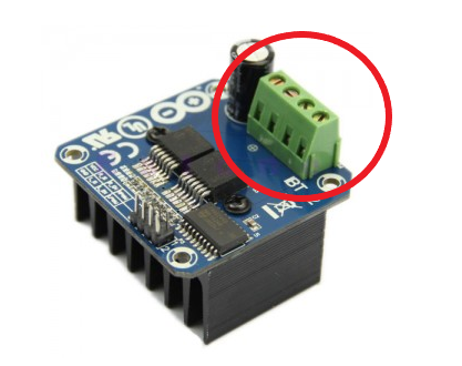

    The power supply or battery should connect to the IBT2 +- on the green connector. The motor also connects to the MM on the green connector on the IBT-2. The IBT2 will control the motor. DMAX

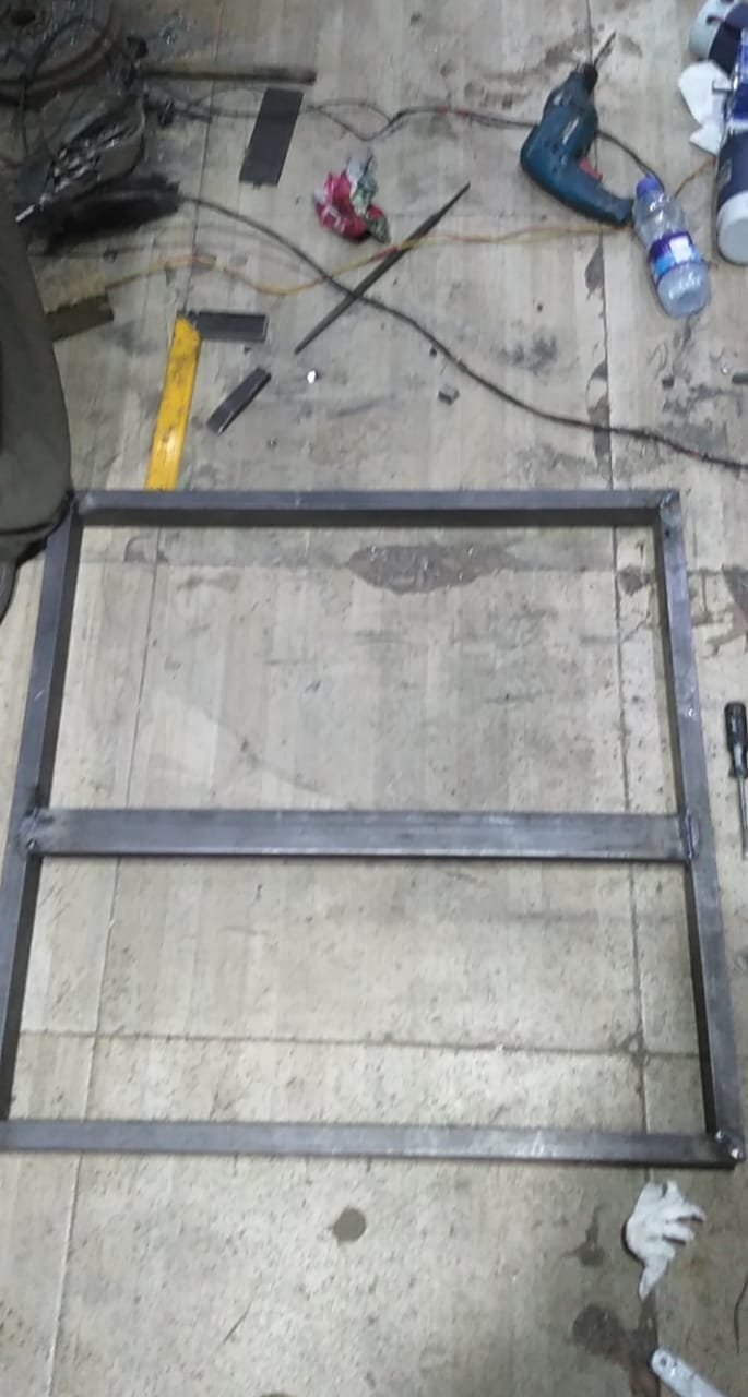

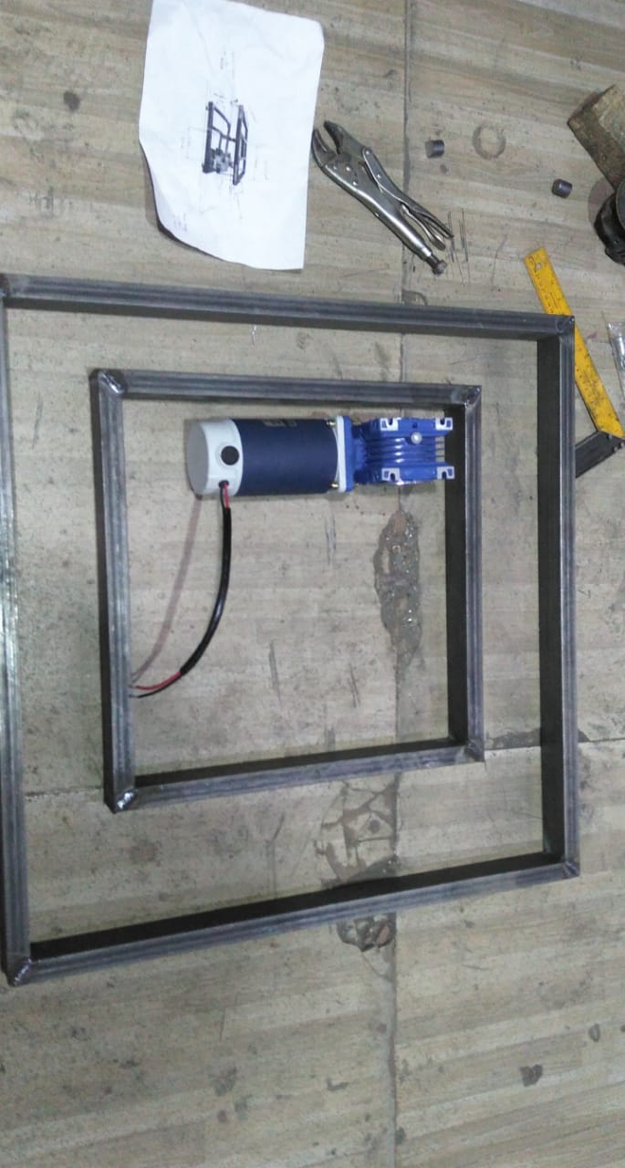

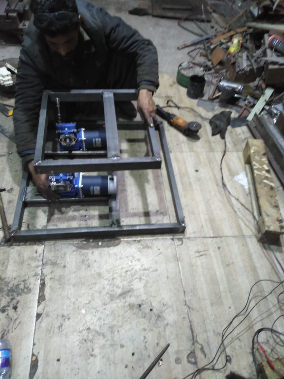

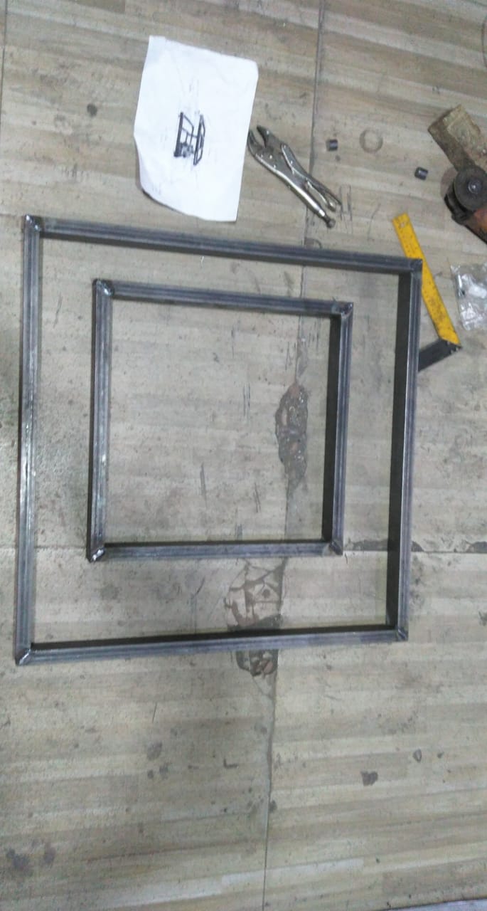

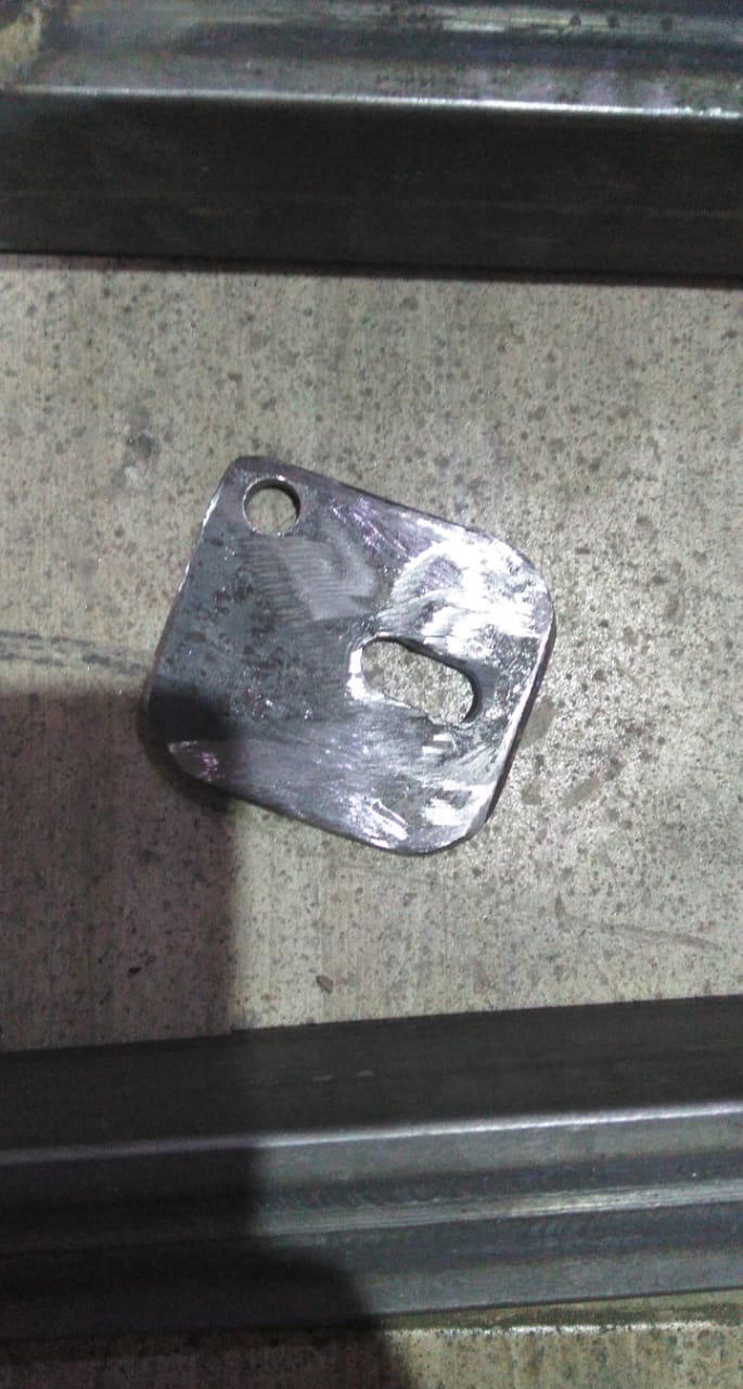

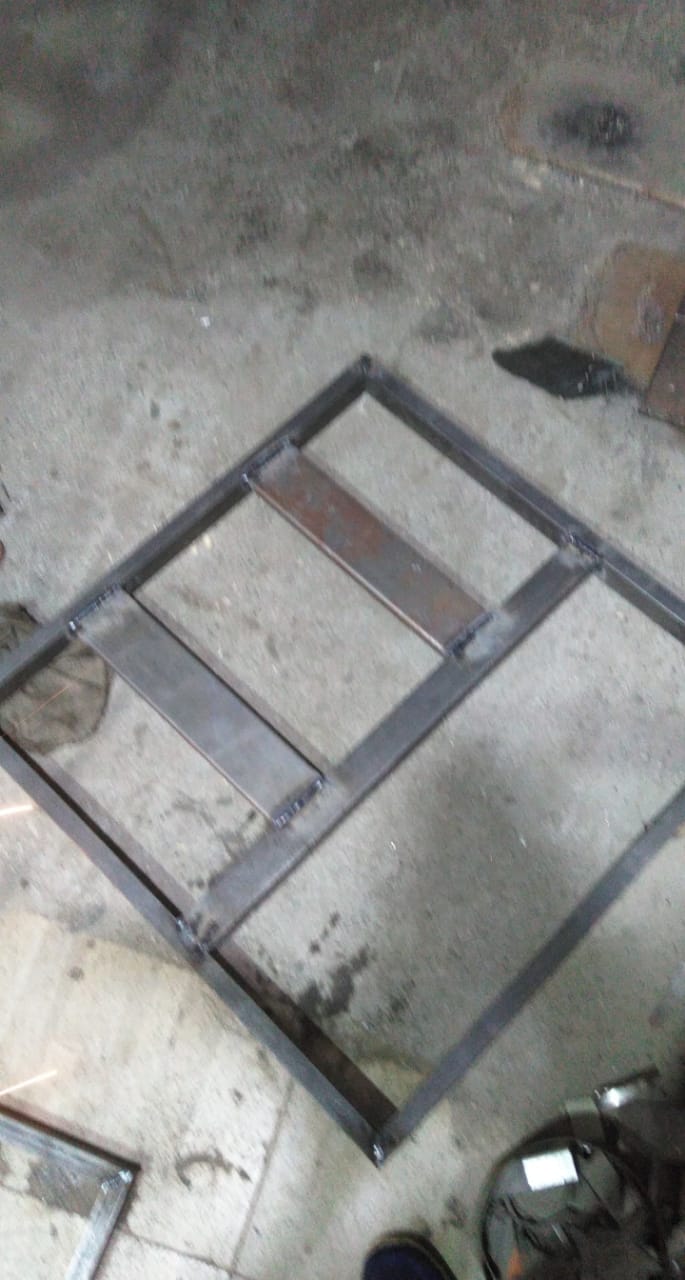

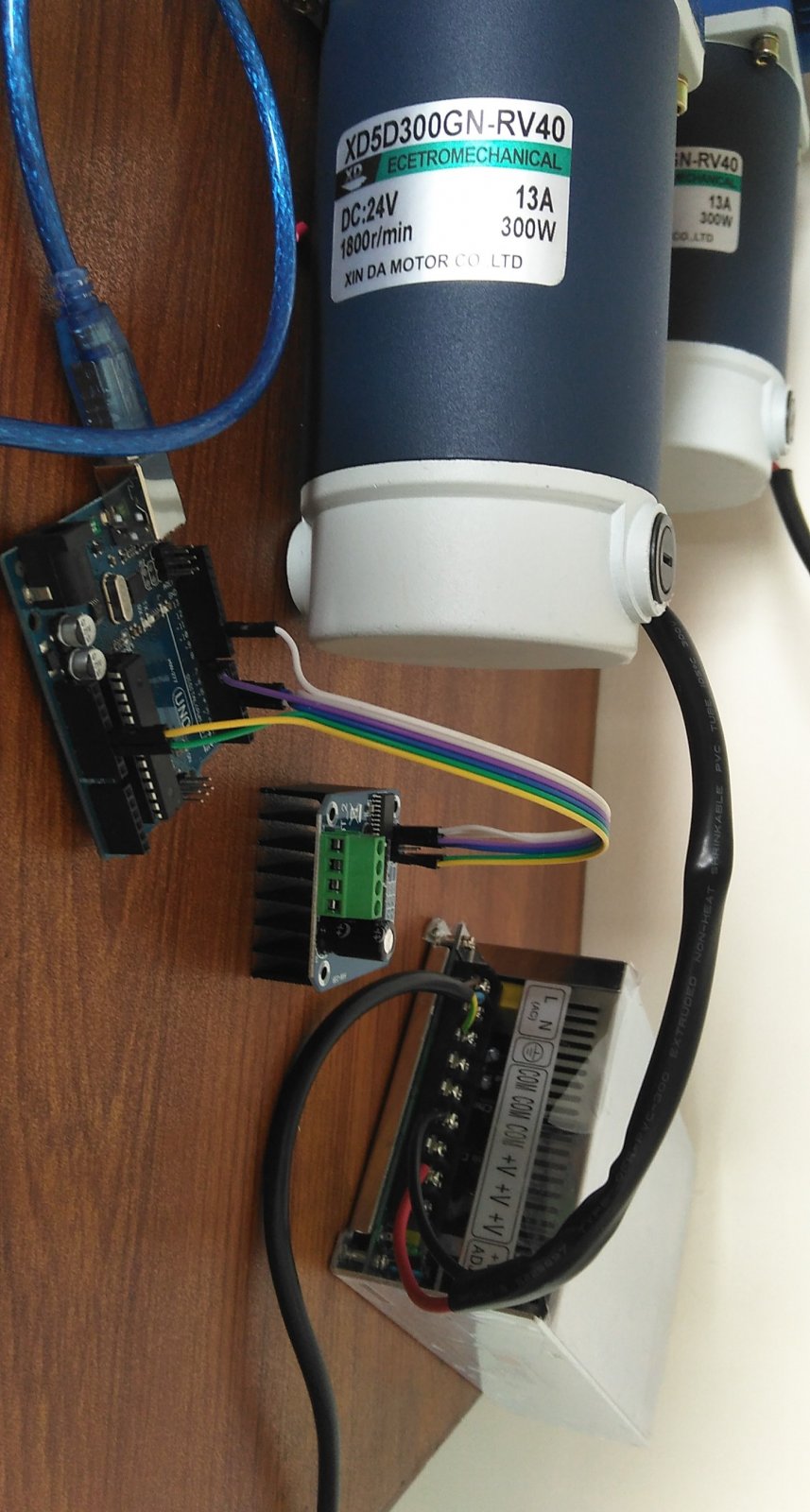

    Sharing my progress from the last two weeks.
    Base mount and chair mount
    WhatsApp Image 2022-03-07 at 10.38.18 AM (1).jpeg WhatsApp Image 2022-03-07 at 10.38.18 AM (1).jpeg WhatsApp Image 2022-03-07 at 10.37.46 AM (1).jpeg WhatsApp Image 2022-03-07 at 10.37.46 AM (4).jpeg WhatsApp Image 2022-03-07 at 10.38.14 AM (3).jpeg WhatsApp Image 2022-03-07 at 10.38.18 AM (2).jpeg WhatsApp Image 2022-03-07 at 10.38.18 AM (1).jpeg WhatsApp Image 2022-03-07 at 10.37.46 AM (1).jpeg WhatsApp Image 2022-03-07 at 10.37.46 AM (4).jpeg WhatsApp Image 2022-03-07 at 10.38.14 AM (3).jpeg WhatsApp Image 2022-03-07 at 10.38.18 AM (2).jpeg

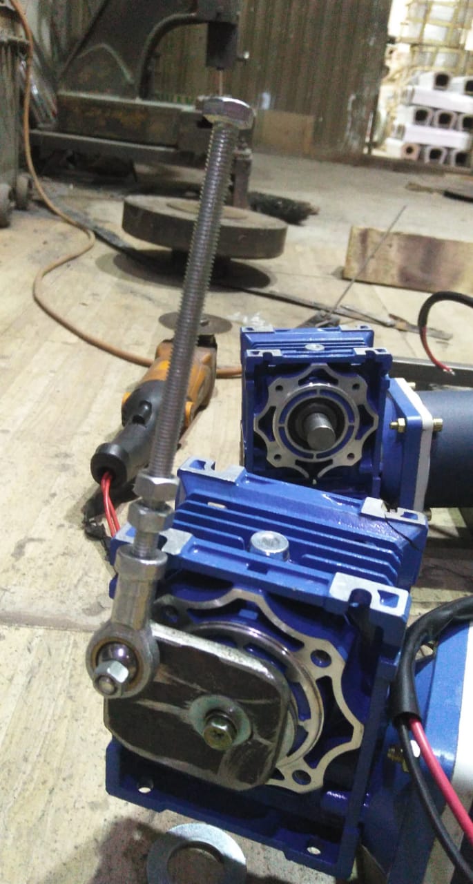

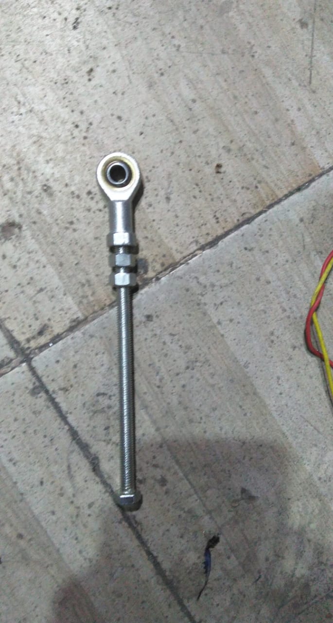

    CTC lever
  8. imajavaid
    imajavaid Member
    Oct 25, 2021
    108
    169Coins
    +25 / 1 / -0

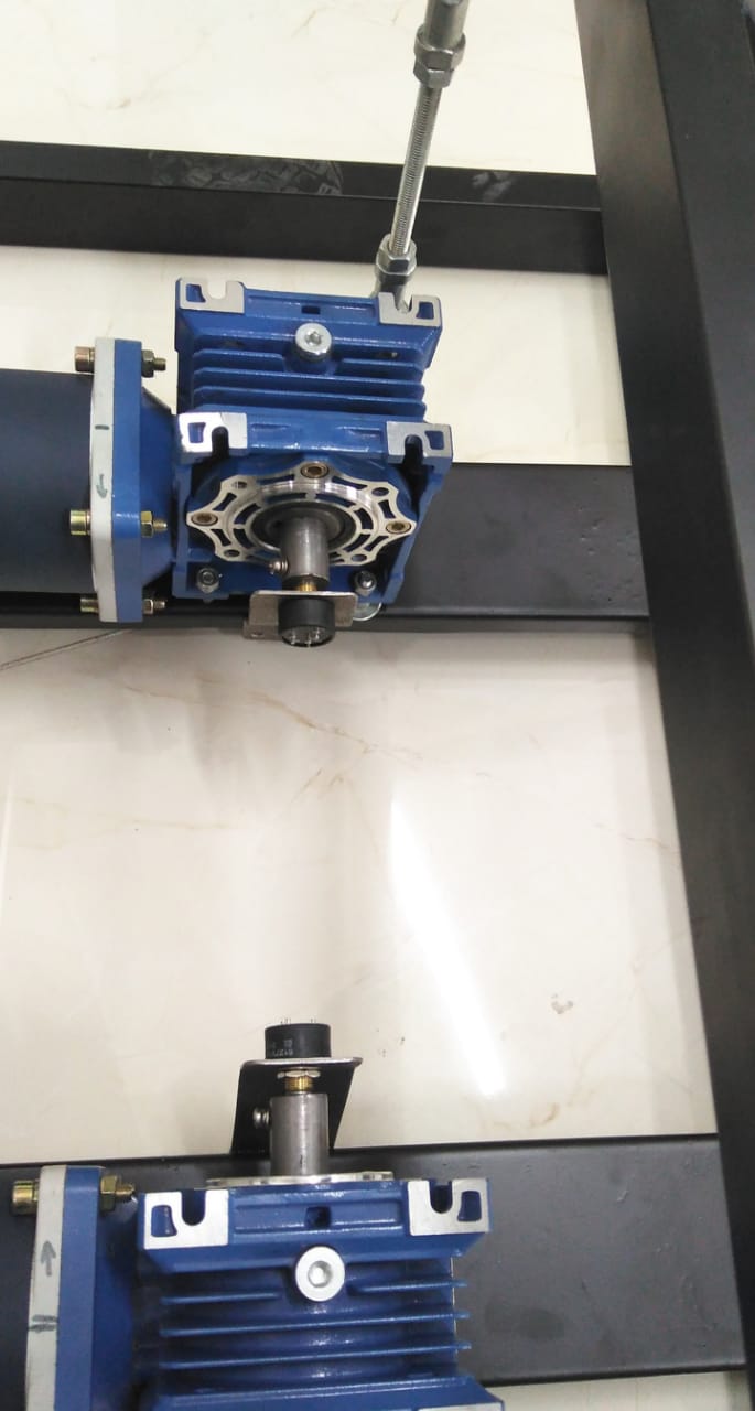

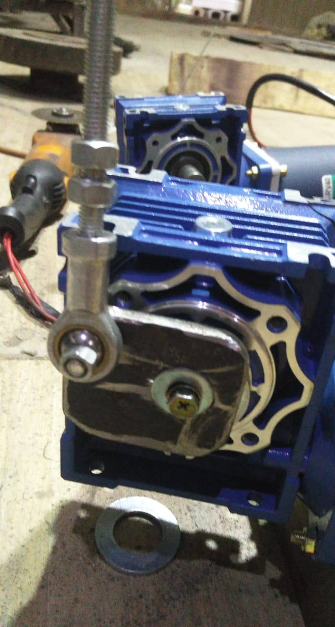

    Motor shaft

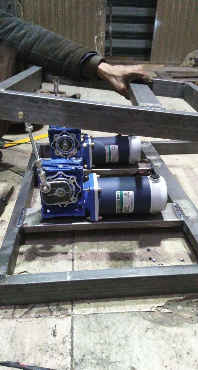

  9. imajavaid
    imajavaid Member
    Oct 25, 2021
    108
    169Coins
    +25 / 1 / -0
    Integration of swivel joint, motor shaft, motor
    and Connecting upper frame to swivel joint

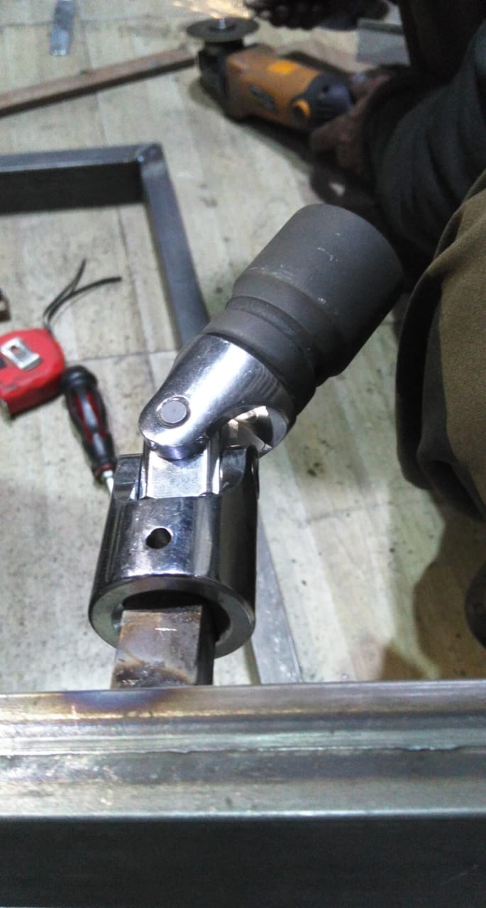

    Universal joint

    +25 / 1 / -0

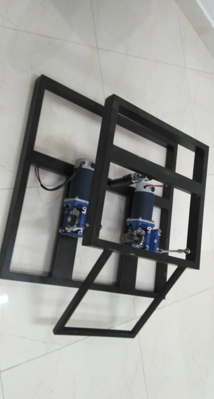

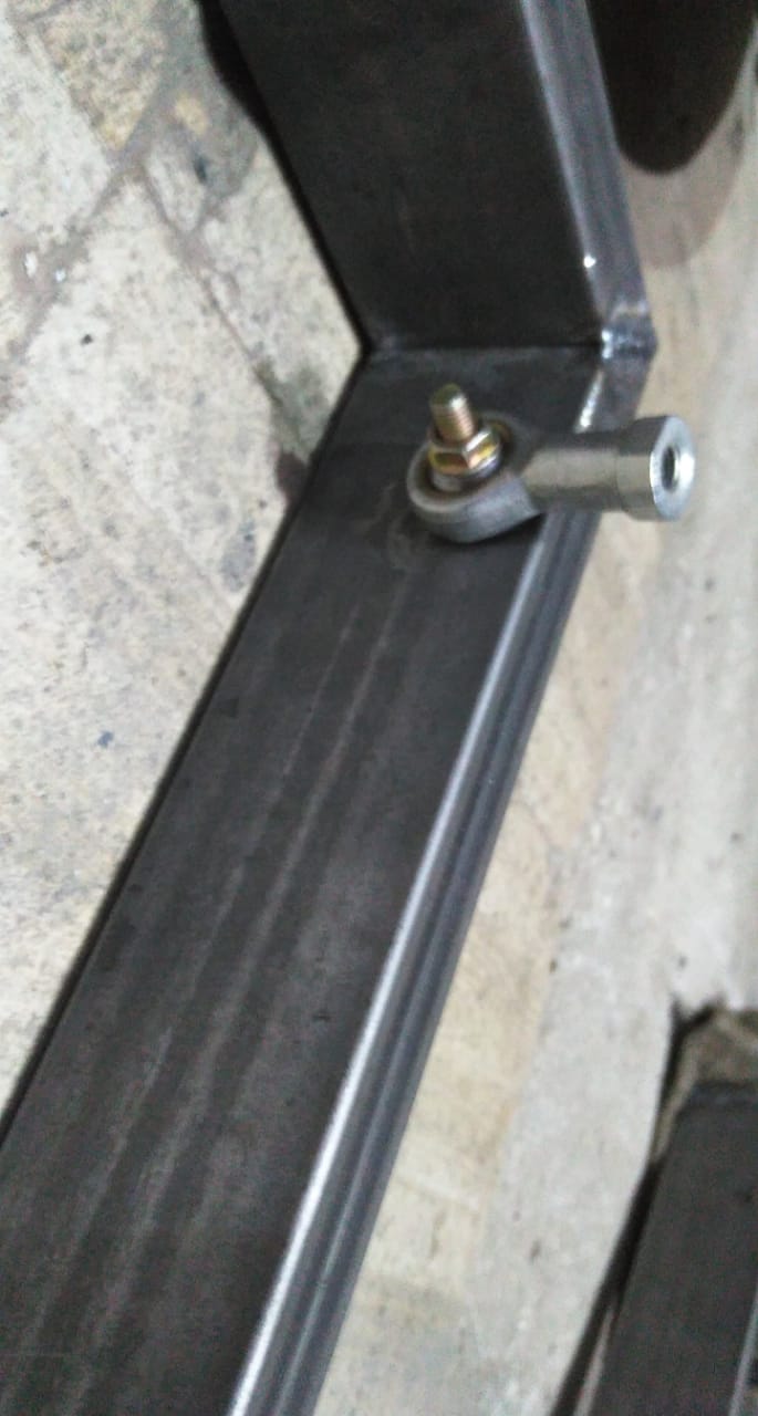

    Integration of lower and upper frame

    I have attached foot rest to the upper frame so that the user feet should not touch the ground.
    Hoping to get a more realistic experience

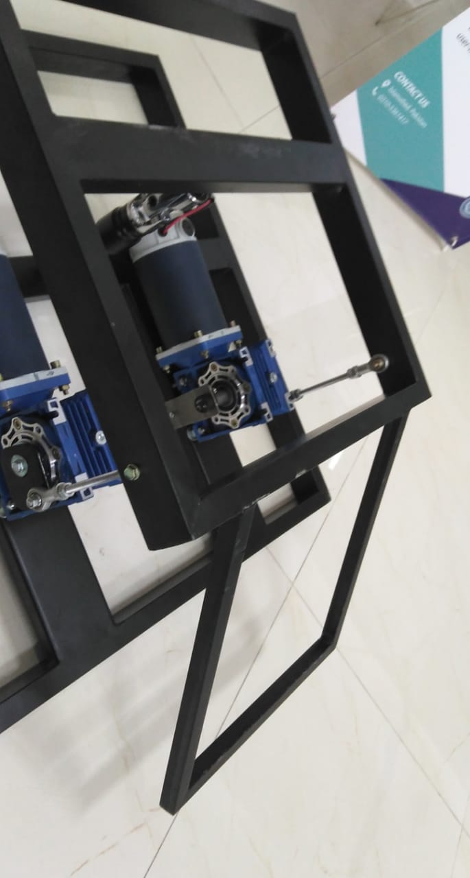

    +25 / 1 / -0

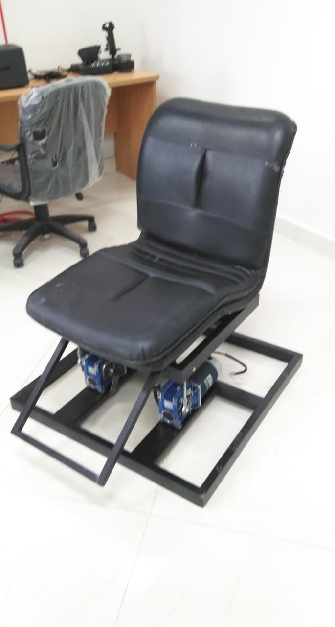

    A complete integrated motion platform

    +25 / 1 / -0
    Going to attach seat now

    Nice work :thumbs
    Have you hooked up the electronics and tested it under load?

    Thanks. It's still in progress. I will try to complete it by thus weekend

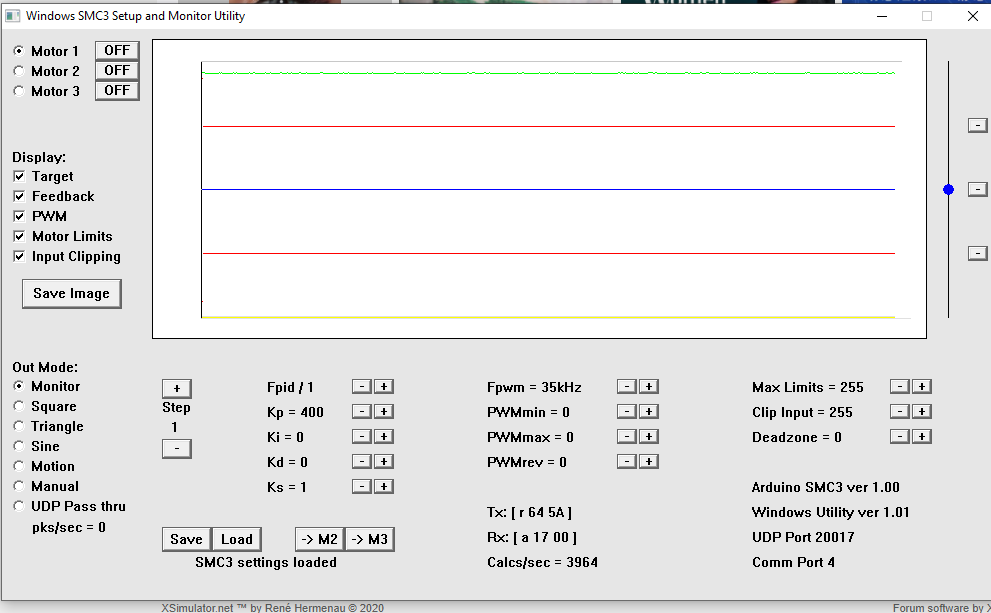

  20. imajavaid
    imajavaid Member
    Oct 25, 2021
    108

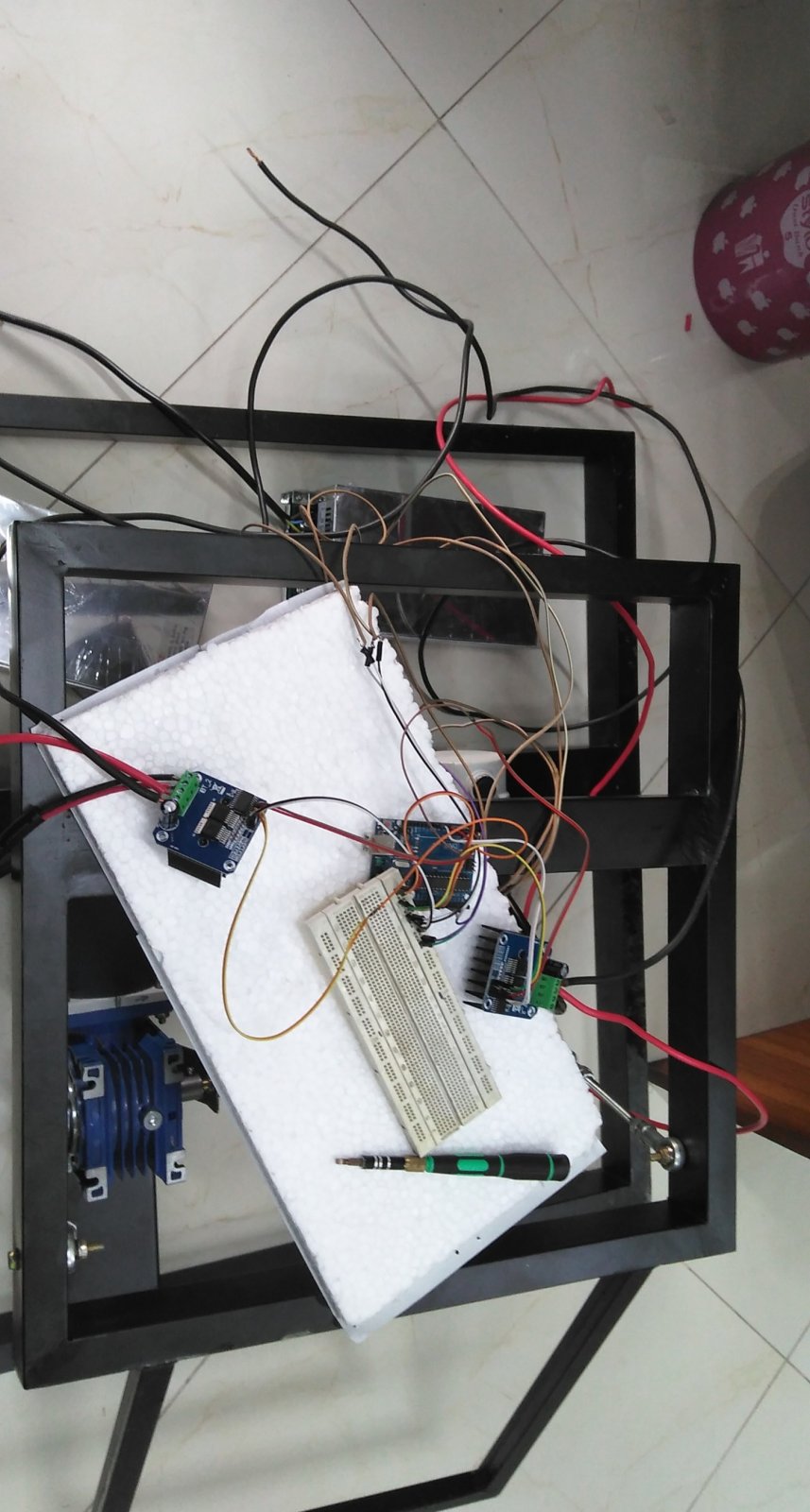

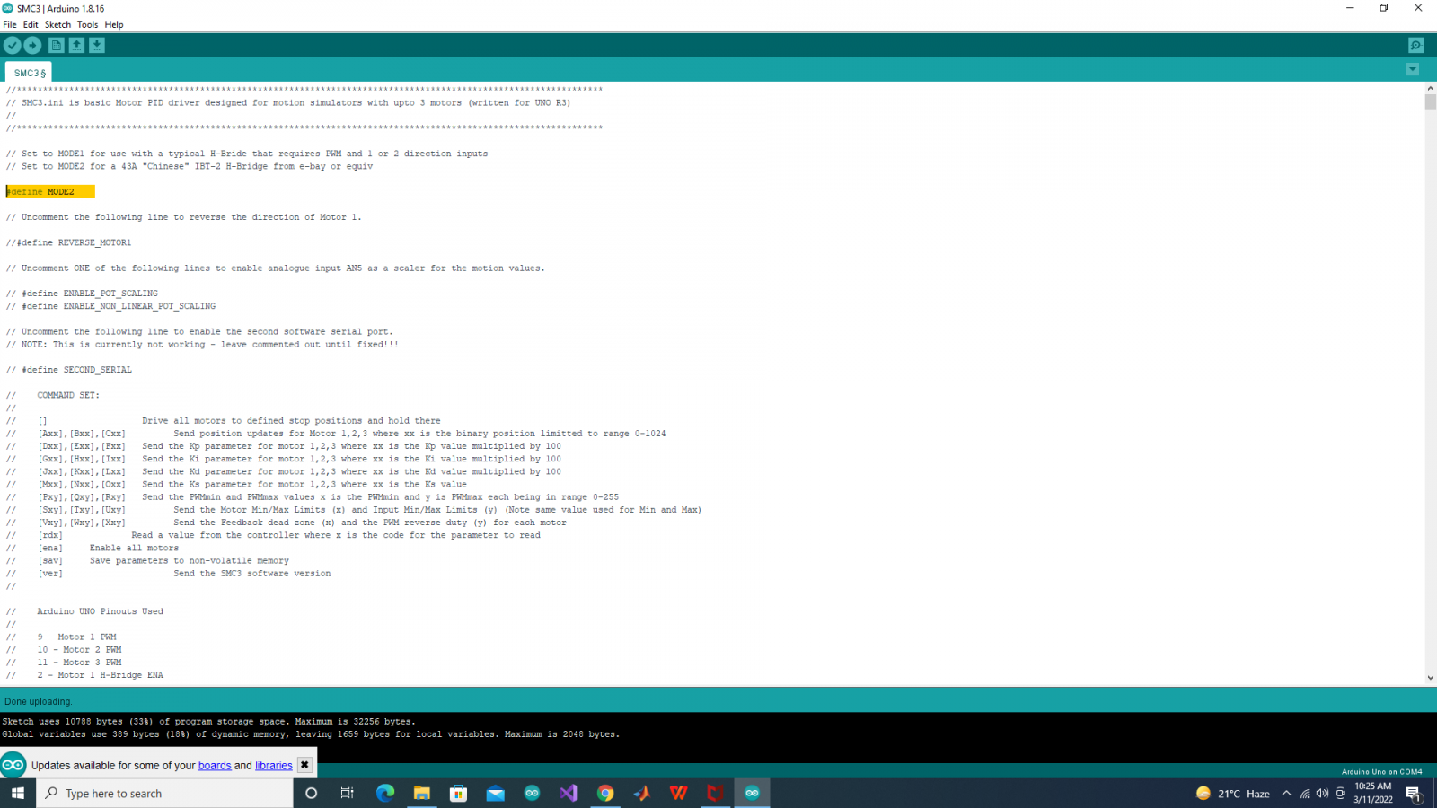

    169Coins
    +25 / 1 / -0
    I have defined mode 2 in arduino and set com port to 4 as of arduino adn it is also showing in smc3. But why the motors are showing turn off status. I clicked on it but they are not turning on. I also have rechecked the circuit diagram
