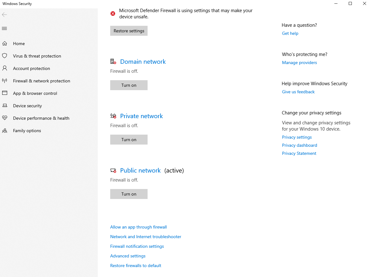

    If SMC3 is properly configured, and Interface Settings are correct, then something is interfering with communications. Make sure SMC3 utility is not running at the same time as SimTools.
    If that is not the issue then likely your firewall/antivirus are the culprits. Temporarily disable both, restart everything and re-test Output Testing.

    Still facing this issue . The motor is producing the humming sound
    Firewall is off though

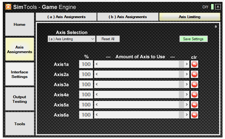

  6. imajavaid
    imajavaid Member
    Oct 25, 2021
    108
    169Coins
    +25 / 1 / -0
    Issue resolved. I was using range of 0%on my axis assignement . I increased it to 100% and my motors start moving

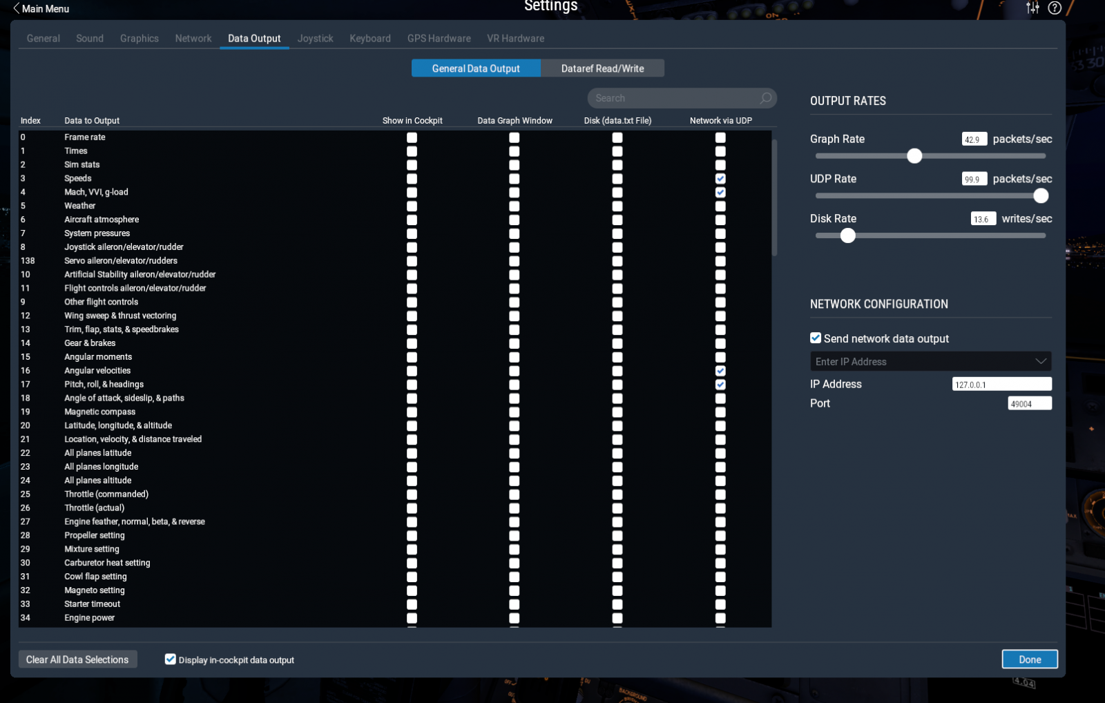

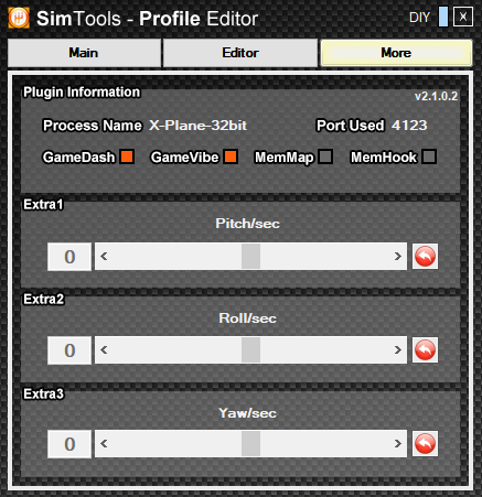

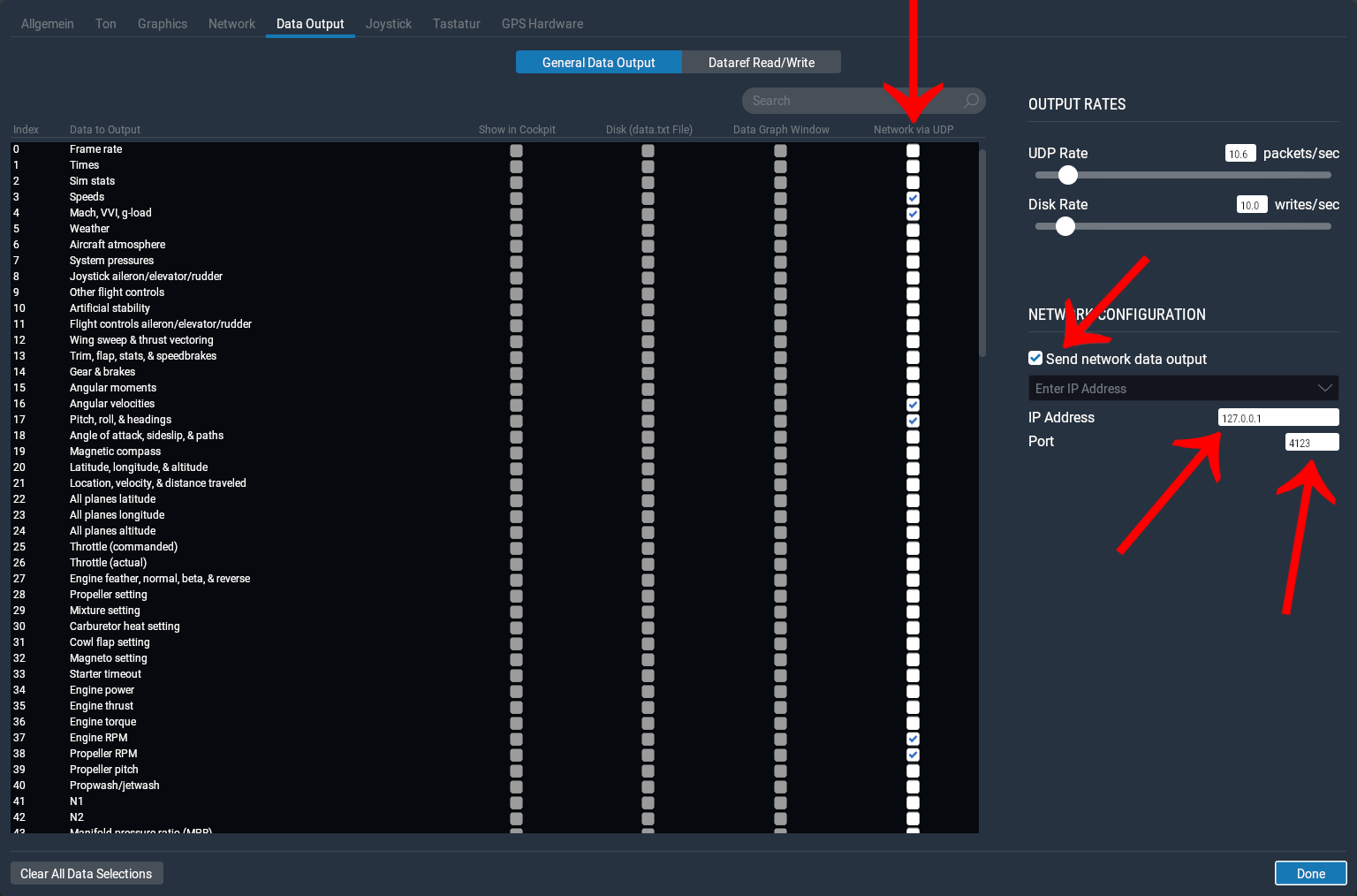

    The virtual axis of output setting is not working as I patched the game. I have set data ouptut settings and i have patched the game . But dont know whats going wrong

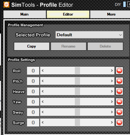

  10. imajavaid
    imajavaid Member
    Oct 25, 2021
    108
    169Coins
    +25 / 1 / -0
    these are profile editor settings

    Try port 4123:
  12. imajavaid
    imajavaid Member
    Oct 25, 2021
    108
    169Coins
    +25 / 1 / -0
    Port 4123 worked

    Now I got my virtual axis moving. But when I turn my motors on they dont roll and pitch. What the issue now :(

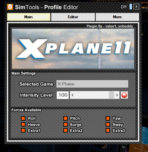

    yes the rig moves as expected in the output testing. Soon I will share its video. Does profile editor has to do something with this error
  16. noorbeast
    21,714
    151,991Coins
    +11,061 / 56 / -2
    Leave the Profile Editor at default for now.

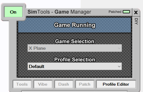

    Not with LFS. I patched Xplane and test in on output testing. It moves correctly
  19. noorbeast
    21,714
    151,991Coins
    +11,061 / 56 / -2
    Please post pictures of all of your Xplane settings, including Axis Assignments and Tuning Center while Xplane is running.
