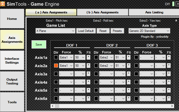

    When I pitch up in output testing tab. My rig pitches down. What should I change in my axis assignment tab. This is my axis assignment looks like
    22,185
    154,750Coins
    +11,196 / 57 / -2
    Grab a copy of the SimTools manual and keep it handy for reference: https://www.xsimulator.net/community/faq/rtfm-start-with-the-official-simtools-documentation.117/
    The DIR box in Axis Assignments being checked orange or not determines which way an axis moves, yours are obviously reversed, this is what SimTools expects in terms of axis configuration: https://www.xsimulator.net/community/faq/which-way-to-set-simtool-axis-movements.230/

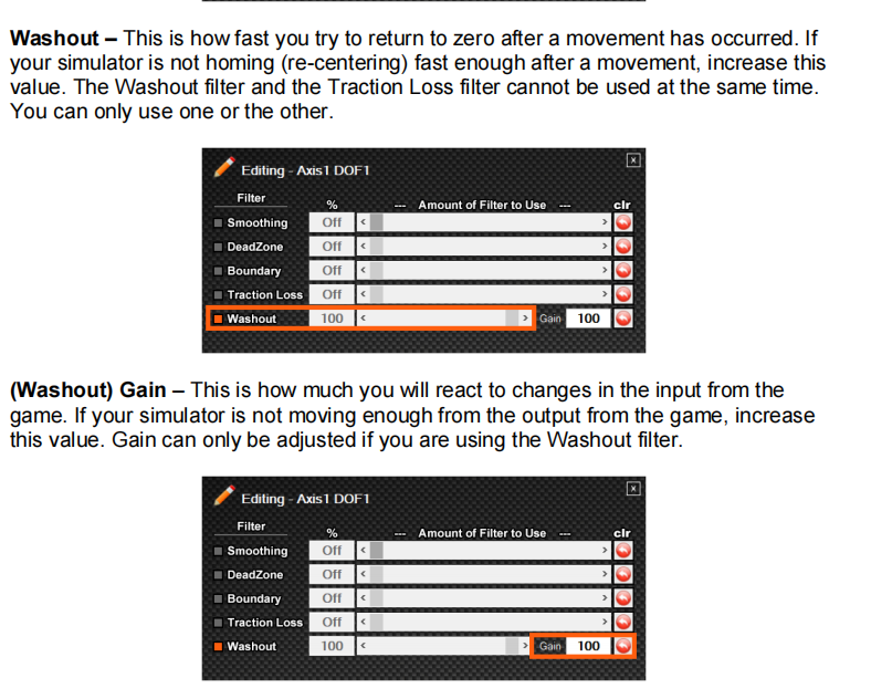

    My rig is not moving fast enough. Is that mean I need to adjust washout algorithm values? if so what value should be optimal
    22,185
    154,750Coins
    +11,196 / 57 / -2
    For now don't mess with Filters, leave them at their default settings as they should come last in terms of motion profile refinement.
    In terms of response first capture the Max/Min values in the Tuning Center and tweak from there. The lower the Tuning Center value the faster the response, but over a reduced range, see the Tuning Tips in the FAQs: https://www.xsimulator.net/community/faq/steps-to-create-a-motion-profile.228/

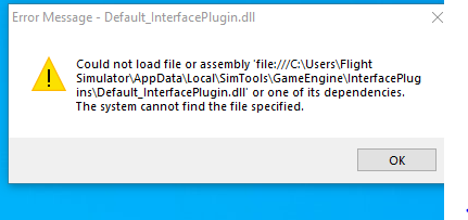

    I'm getting this error while opening simtools. Why it is so
  12. noorbeast
    22,185
    154,750Coins
    +11,196 / 57 / -2
    @yobuddy any ideas what circumstances would generate this error message?

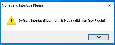

    Another error pops up after the first error
  14. yobuddy
    51,704Coins
    +5,204 / 19 / -0
    That file is installed with the SimTools installation.
    My guess is your antivirus locked some files?
    You can reinstall SimTools over the top of your current SimTools installation to fix it.
    Take care!

    The simtools should be installed on admin. That's the solution

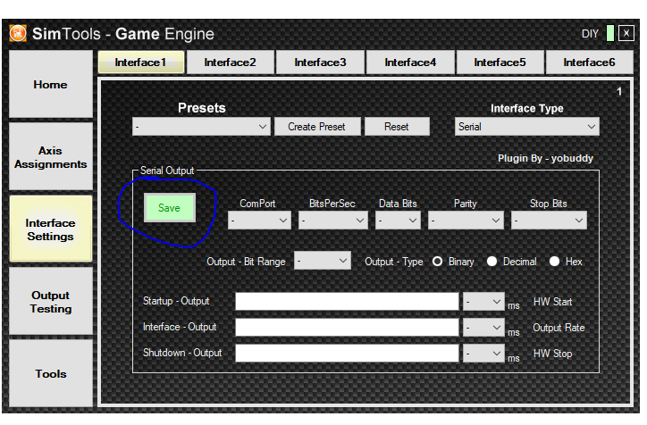

    Save button interface assignment is not working. What can be the issue
  17. noorbeast
    22,185
    154,750Coins
    +11,196 / 57 / -2
    This is a blank form that has not been configured, there is nothing to save until you get the basics filled out.
