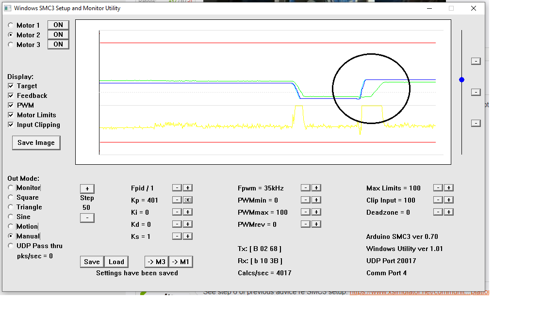

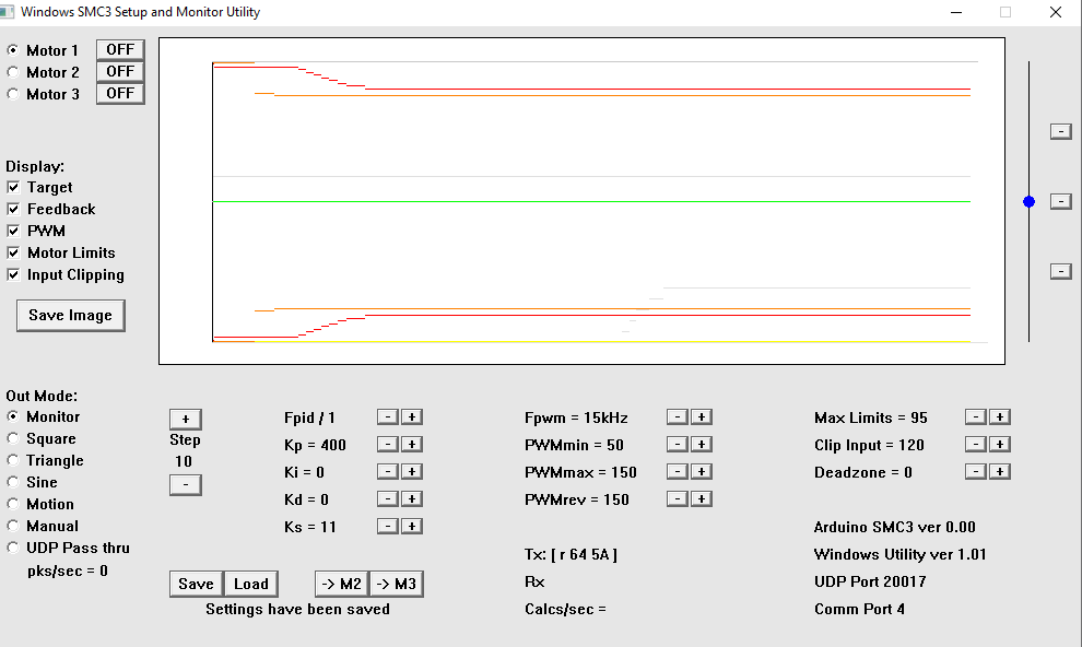

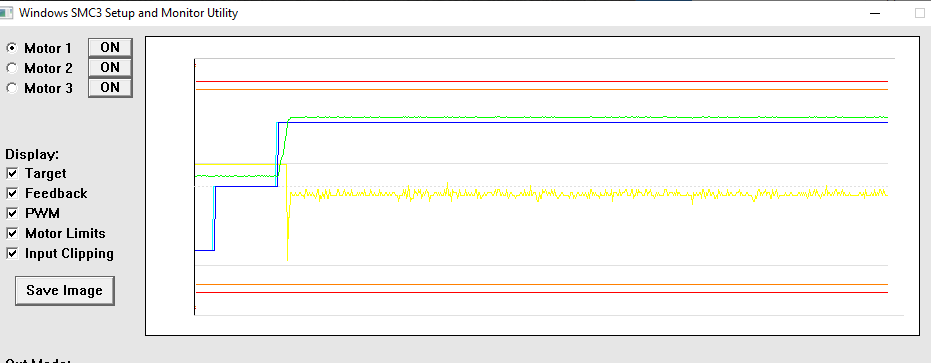

    This was your earlier settings, what changed:

    These are my settings. One motor is working fine. Other is causing the issue

    Im not using simtools in this step. Only step Im trying to copy is to move motors manually trough smc3. one motor is working fine other motor is just moving in one direction. How to solve this issue

    It could be an issue with the Arduino itself, or control boards, given the hardware you are using. If you swap hardware around side to side does the issue move or remain the same?
