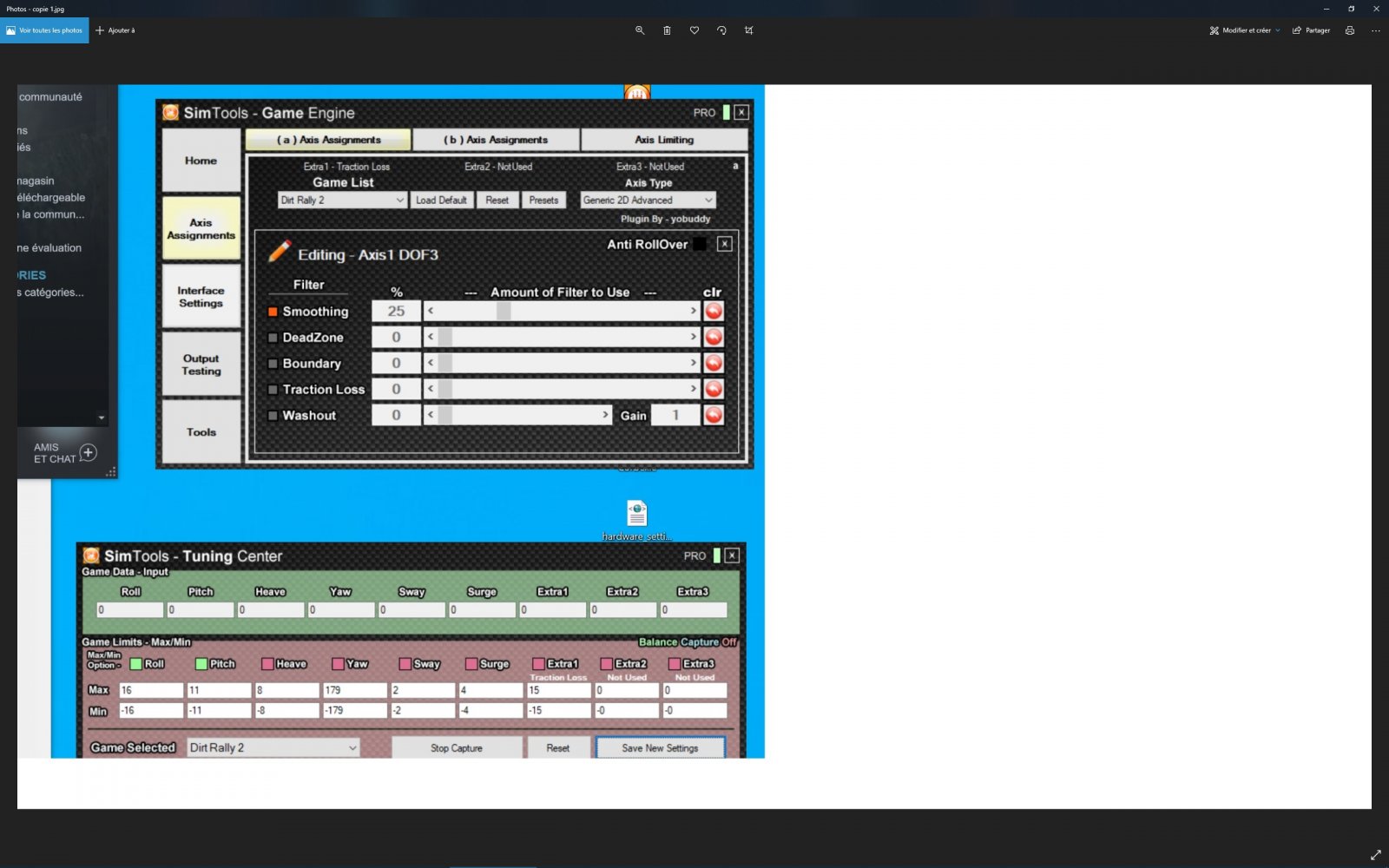

  15. Marcocer
    Marcocer Member Gold Contributor
    Apr 6, 2016
    31
    France Allier Sussat
    - 262Coins
  16. Marcocer
    Apr 6, 2016
    31
    - 262Coins

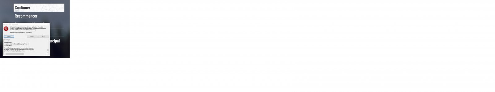

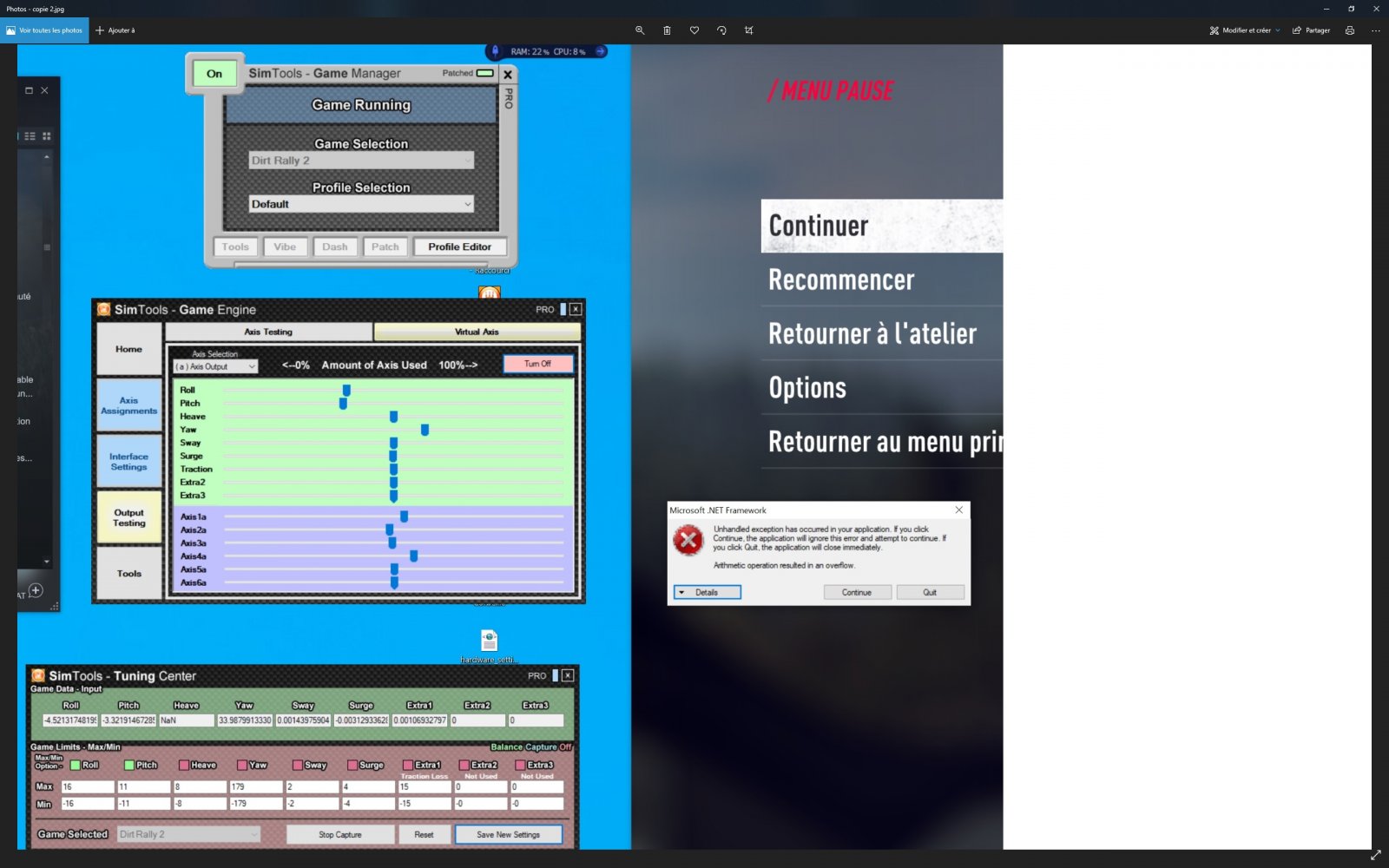

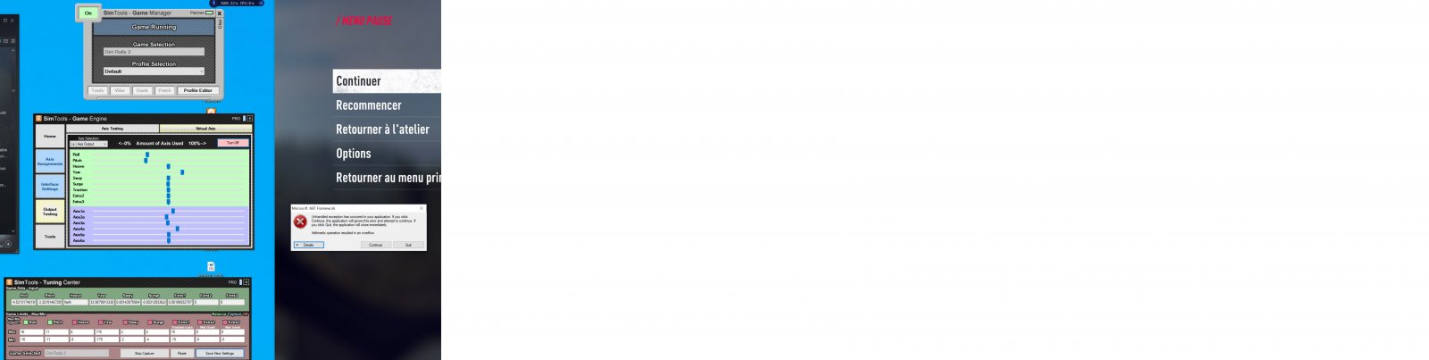

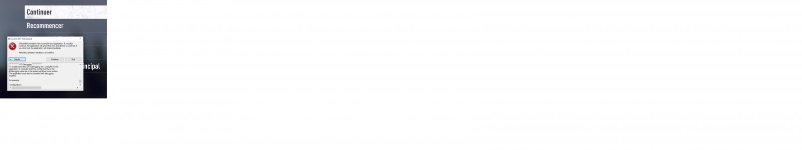

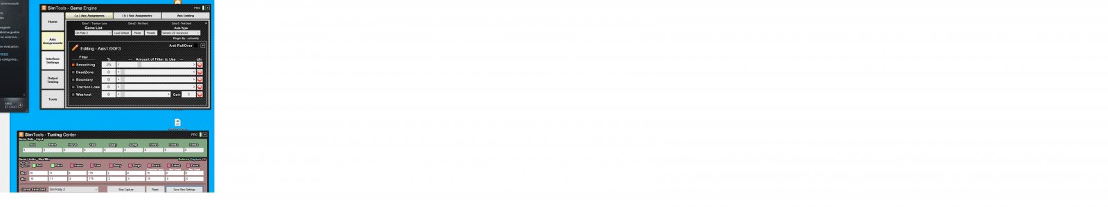

  17. noorbeast
    22,202
    154,675Coins
    +11,209 / 57 / -2
    The images aren't clear enough to read. Please copy and paste into a post the full .Net error details.
  18. Marcocer
    Apr 6, 2016
    31
    - 262Coins
  19. Marcocer
    Apr 6, 2016
    31
    - 262Coins
    sorry !
    i just have this NetFramework 'message when i use virtual axis
  20. noorbeast
    22,202
    154,675Coins
    +11,209 / 57 / -2
    Sorry but what we need to see is the full 'Details' you will fine if you expand the .NET error dialog. Please copy that error message in full and paste it here, rather than a photo.
