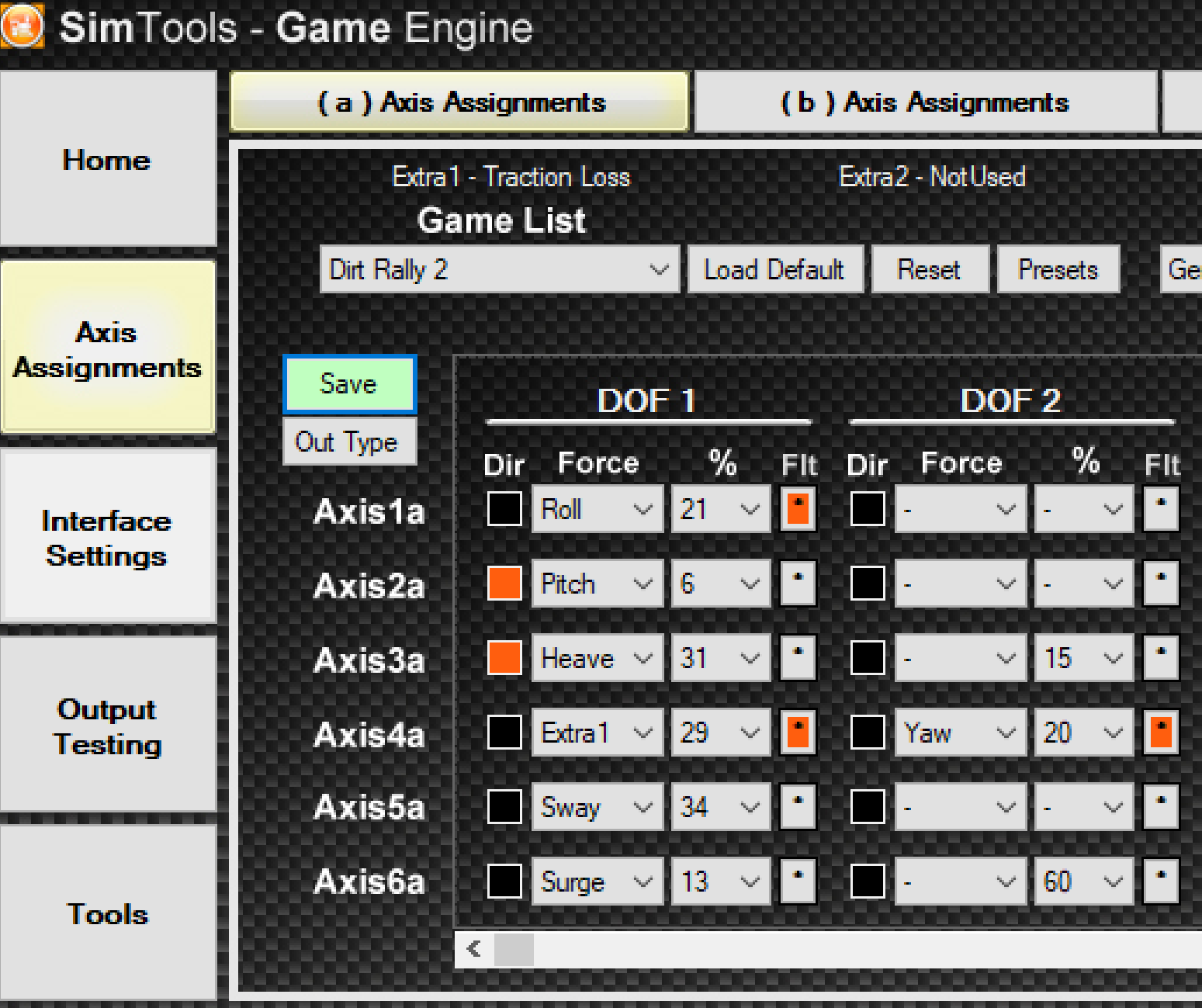

    I have posted my settings here:
    https://www.xsimulator.net/community/threads/dirt-rally-2-plugin.13081/page-14#post-187191
    @noorbeast
    I have also followed the motion profile guide and tweaked every axis by it's own.
    But then when I activated (mixed) all axis in game engine the result was totally wrong and I had to tweak all the values again (lower them) to have a good result.
    I wonder if I did something wrong. Why tweak single axis when the combined mixed axis motion feels different ?
    I use a 6DOF motor/gearbox rig.

    Your settings look closer to what I would expect, compared to @Marcocer

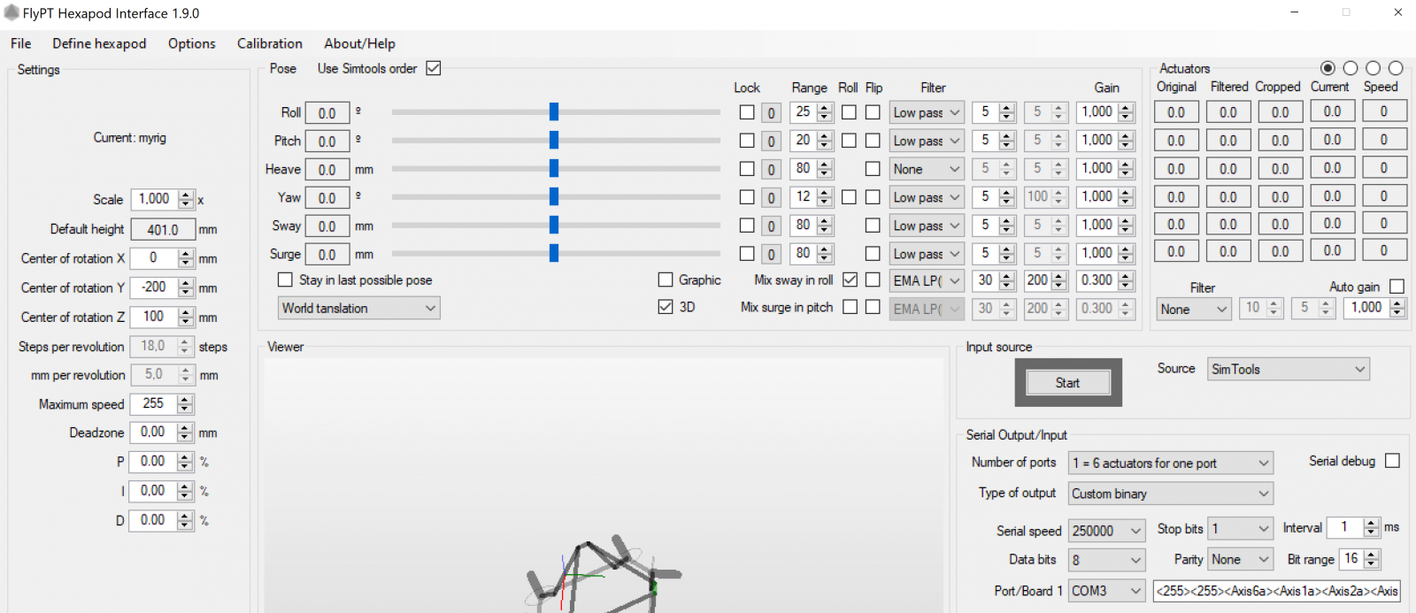

    Are you are using FlyPT?

    Yes I'm using FlyPT because the builder of the rig told me to use it with SimTools.
    I have tried to tweak the settings in FlyPT too separately.

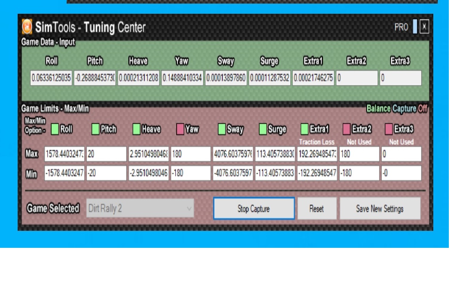

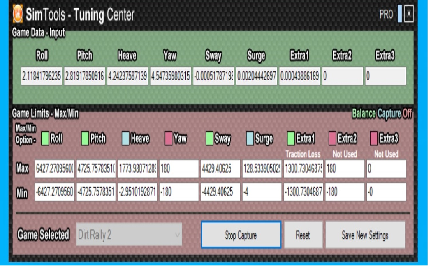

    no problem for that! but when I capture, the values are much larger than usual (with other old plug-ins of DR2) and it's not possible to Save New Setting (possible but too much bigger in Game Limit max/min but good in TCenter Game Data - Input !)
    i don't understand why ,perhaps hardware_settings_config.xml ?
    thanks
    same for me ,i tweak axis Heave in first ,after Roll and Pitch (with heave ) ,and after Surge and Sway (with roll pitch heave ) but long time to make it !

    Now I have found very good settings even with great Heave feeling. :thumbs
    I had to remove the Low Pass filter in FlyPT to get more feeling on road surface.
    Roll - Washout 30%
    Extra 1 - Washout 100%
    Yaw - Washout 50%

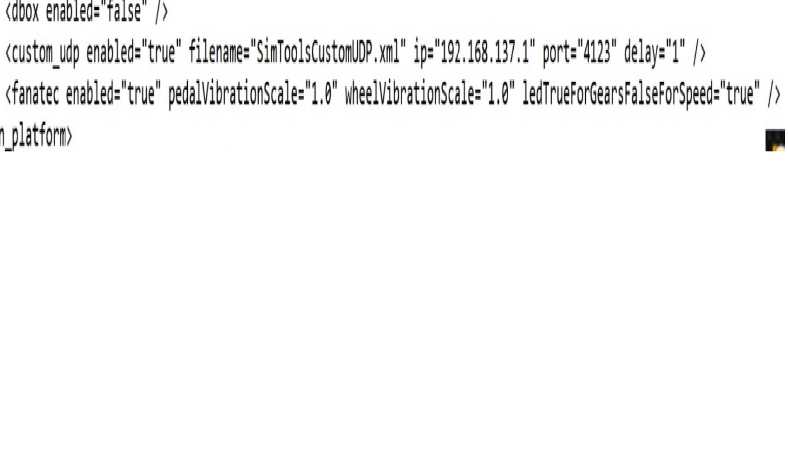

    goto: C:\Users\(your user folder)\Documents\My Games\DiRT Rally 2\hardwaresettings
    And look for the files "hardware_settings_config.xml" and "cfg.BAK".
    Move these 2 files to your desktop, in case you want to put them back later.
    Now launch the game and run a race, a new "hardware_settings_config.xml" file should be created.
    Exit the game, patch it and give it another go.
    Please let me know what you find buddy.

    Can you manually enter TC values and save them?
