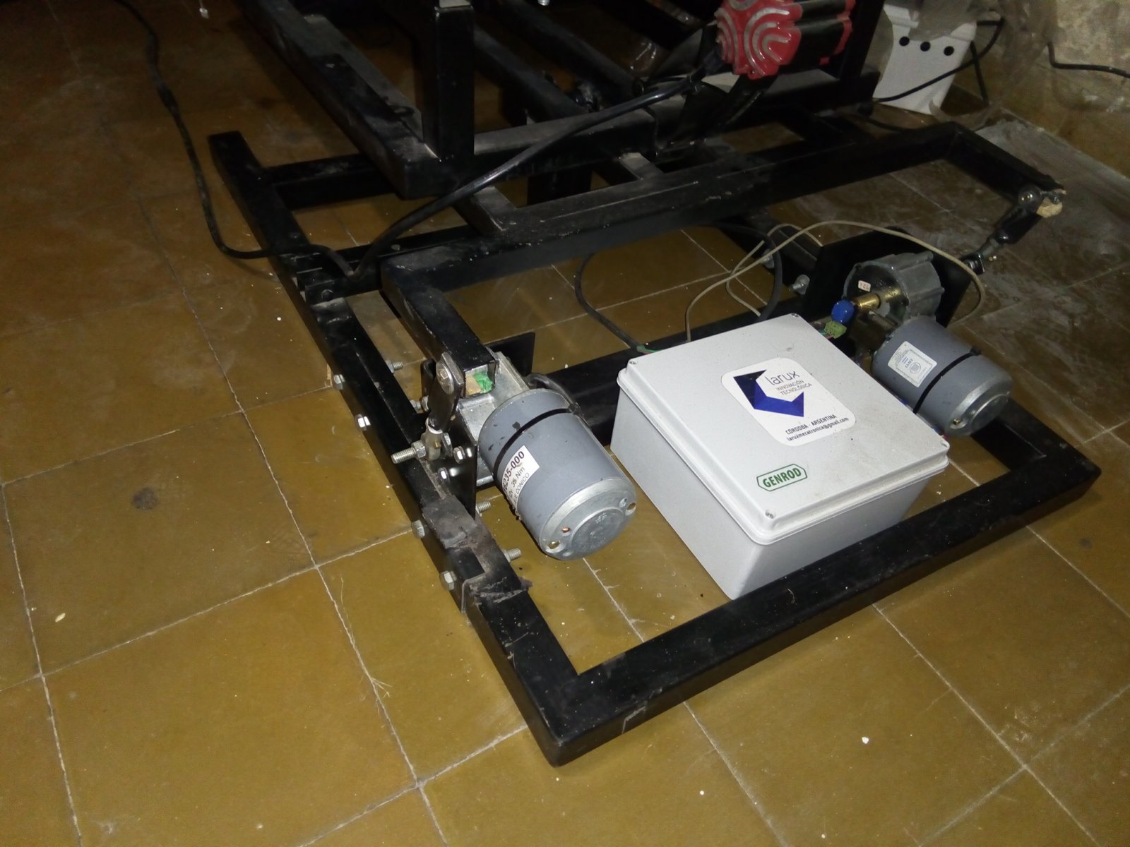

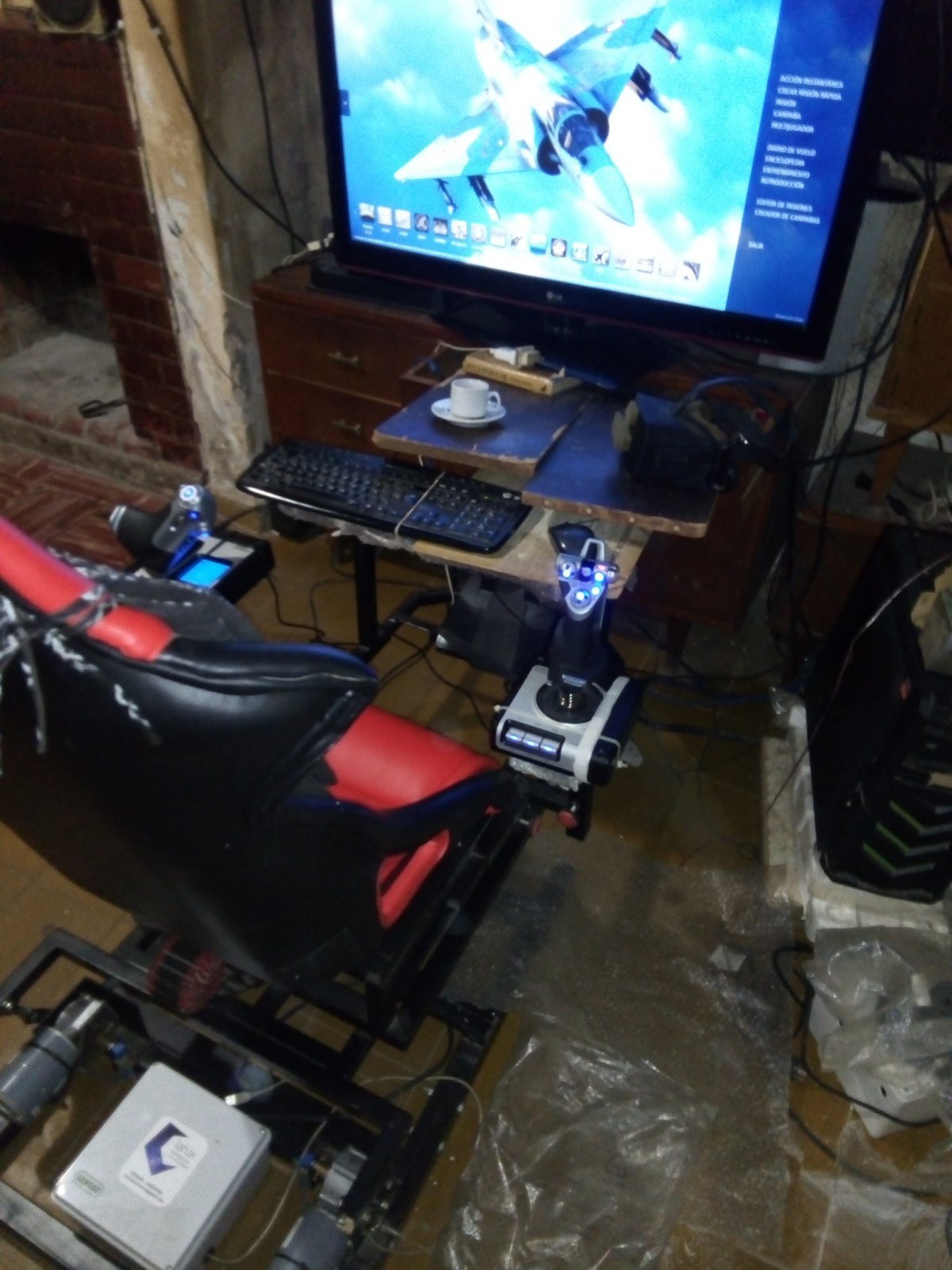

    Hello Noorbeast, download dirt 2, elite y dcs world, dirt 2 and elite work, thank you very much again for your great action,
    Greetings Australians from Argentina, from the other side of the world and that everything improves, it will be soon.
    My rig 2dof ideal for race game but not for aircraft games

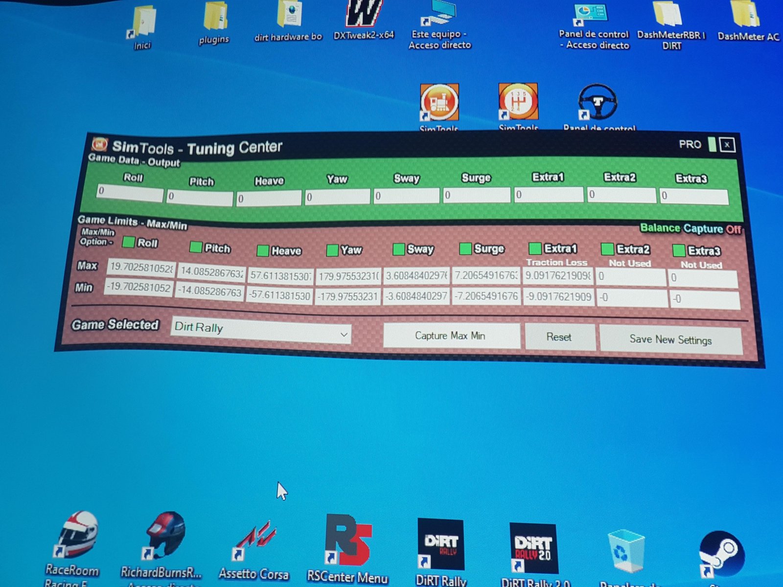

    Hello, first of all, thanks for your work with this plugin.
    I have a basic question. All the people has the same values in the tuning center? Or similar? When I take the values, I saved the values, but with a lot of decimals. When the values are near to zero, the forces are high?
    Thanks!

    Thanks for the quick answer friend. Now ill post a picture of the Tunning Center values. There is a problem with a sway, because, I can only feel the vibrations of the actuators, but nothing more. I think that sway is a lateral movement, truth?
    In Axxis put a value of 30% alone, with no more forces to feel if this Sway is correct in tunning center, but i haven't found the solution. The tuning says a value of 4-4 aprox, and it tryed diferents values in TC and the same, a vibrations or not movement at all.

    Your tuning centre numbers look to high, have you tried to capture max min ?

    Yes i captured the min max in TC but moving near to zero for sway and 4-4 and can only feel vibrations, but no lateral forces.

    you need 2 things to get at least some basic movement,
    1. an high enough DOF%
    2. low enough max and min setting
    so if you have some small movement there i would say start to increase your DOF % a bit at a time and only enable 1 DOF at a time get that set then move to the next:thumbs
