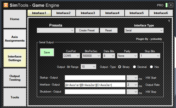

    Can you please confirm what patch path you used, as for Codemaster games it differs depending on your computer being 32 or 64bit: https://www.xsimulator.net/communit...-32-bit-install-path-for-motion-patching.260/
    Can you also post pictures of all of your settings, including the Tuning Center while DR2 is running.

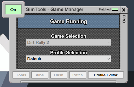

  3. khairul
    khairul New Member
    Oct 31, 2020
    22
    155Coins
    2DOF, 3DOF
    thanks noorbeast for fast reply. my computer running 64bits. here Im attach my setting and when game is running.

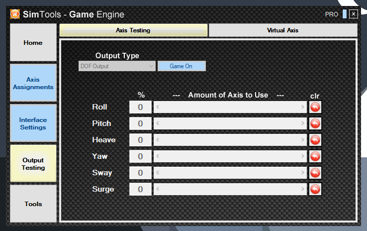

  4. BoomBoYang
    BoomBoYang New Member
    Jun 2, 2021
    25
    - 56Coins
    In GameManager, the game save road is selected, so you need to run the game at least once. If not, you can switch back to the desktop, open Game Engine, select Output Testing. Select Virtual Axis at the top, and then click turn on.

  6. BoomBoYang
    Jun 2, 2021
    25
    - 56Coins
    I saw your picture and you selected Output Testing /Virtual Axis in the Game Engine when the Game was running.Then turn on the top right corner.Then cut back to the game should be fine.My previous situation and you are the same, this is the solution.

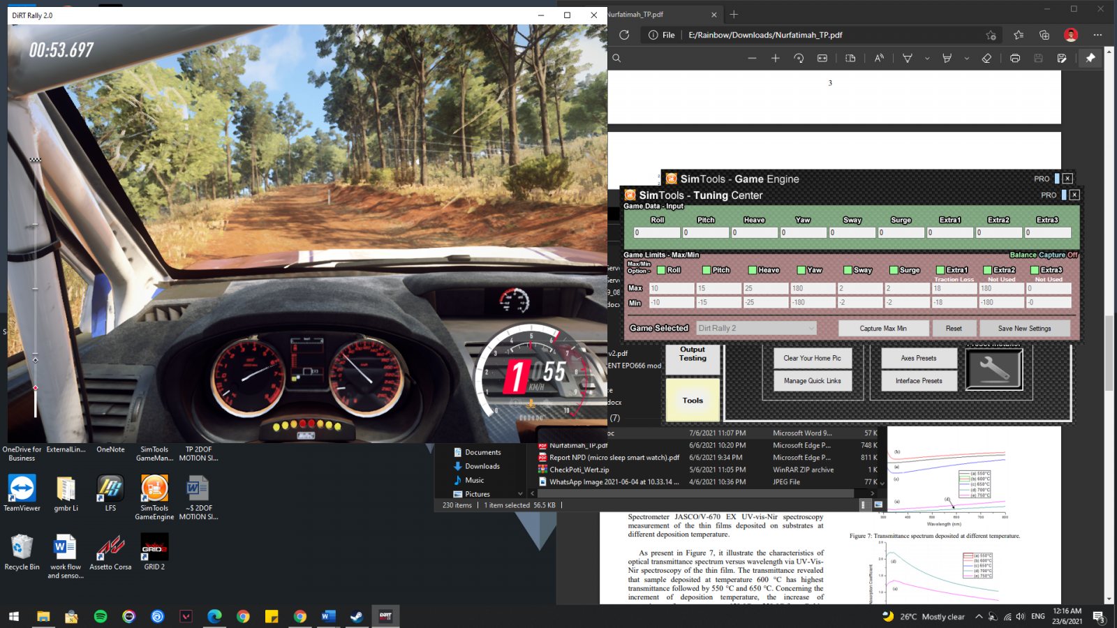

  10. khairul
    khairul New Member
    Oct 31, 2020
    22
    155Coins
    2DOF, 3DOF
    i attach print screen when game running and tuning center. no data at tuning center
  11. leonaikikai
    leonaikikai Member Gold Contributor
    Jan 27, 2014
    43
    45Coins
    +22 / 0 / -0
    i Khairul on your screenshoot your game engine is on demo mode, for me it's not normal can you activate your licence for the laptop which use game engine
    I am sorry for my poor englisch, i hope that can help you
  12. noorbeast
    22,121
    154,352Coins
    +11,179 / 57 / -2
    No data in the TC means either the patch path is incorrect or something is interfering with data communications.
    To rule out a known bug make sure your computer is set to English Local: https://www.xsimulator.net/community/faq/simtools-language-setting-bug-change-to-english-local.233/
    After that uninstall the plugin, temporarily disable your firewall and antivirus then reinstall the plugin and test to see if either are interfering, as SimTools can generate a false positive, see the outline: https://www.xsimulator.net/community/marketplace/motion-simulation-software-simtools.63/

    im using 65bit and patch DirtRally2_GamePlugin.2.0.3.0
  17. noorbeast
    22,121
    154,352Coins
    +11,179 / 57 / -2
    The patch path is the directory you select, which for 64bit will be like this: C:\Users\Your_User_Name\Documents\My Games\DiRT Rally 2.0
    Is that where you are patching for motion?
  18. khairul
    khairul New Member
    Oct 31, 2020
    22
    155Coins
    2DOF, 3DOF
    E:\Rainbow\Documents\My Games\DiRT Rally 2.0
    that where im patch. folder motionplatforms also there
