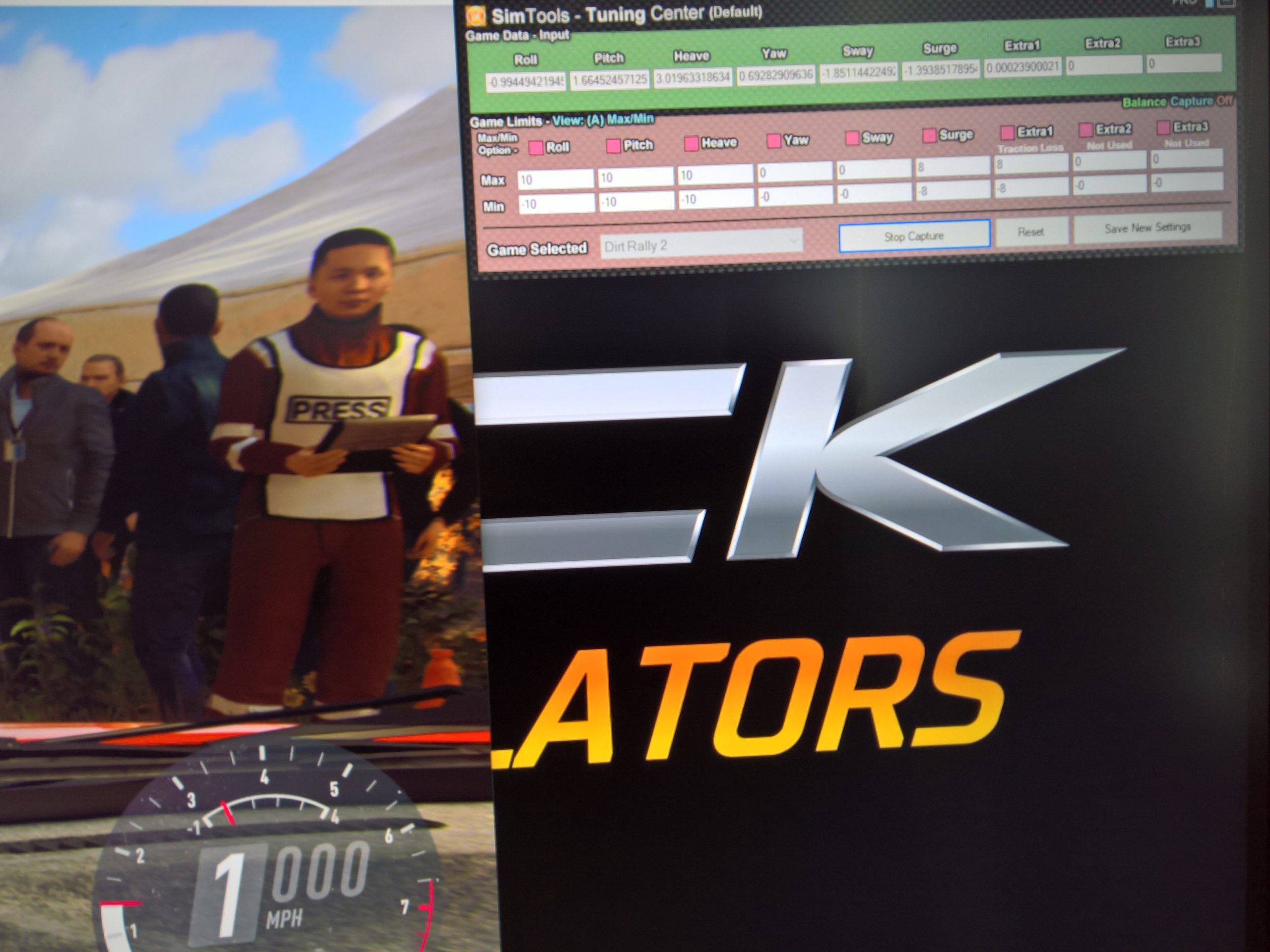

    Hi @yobuddy,
    This is a great plugin, thank you. I've just noticed there doesn't seem to be any output in the b axis assignments? If I open tuning centre they are all zero and get no movement from actuators set up with those axis. Is there a setting I'm missing?
    Thanks.

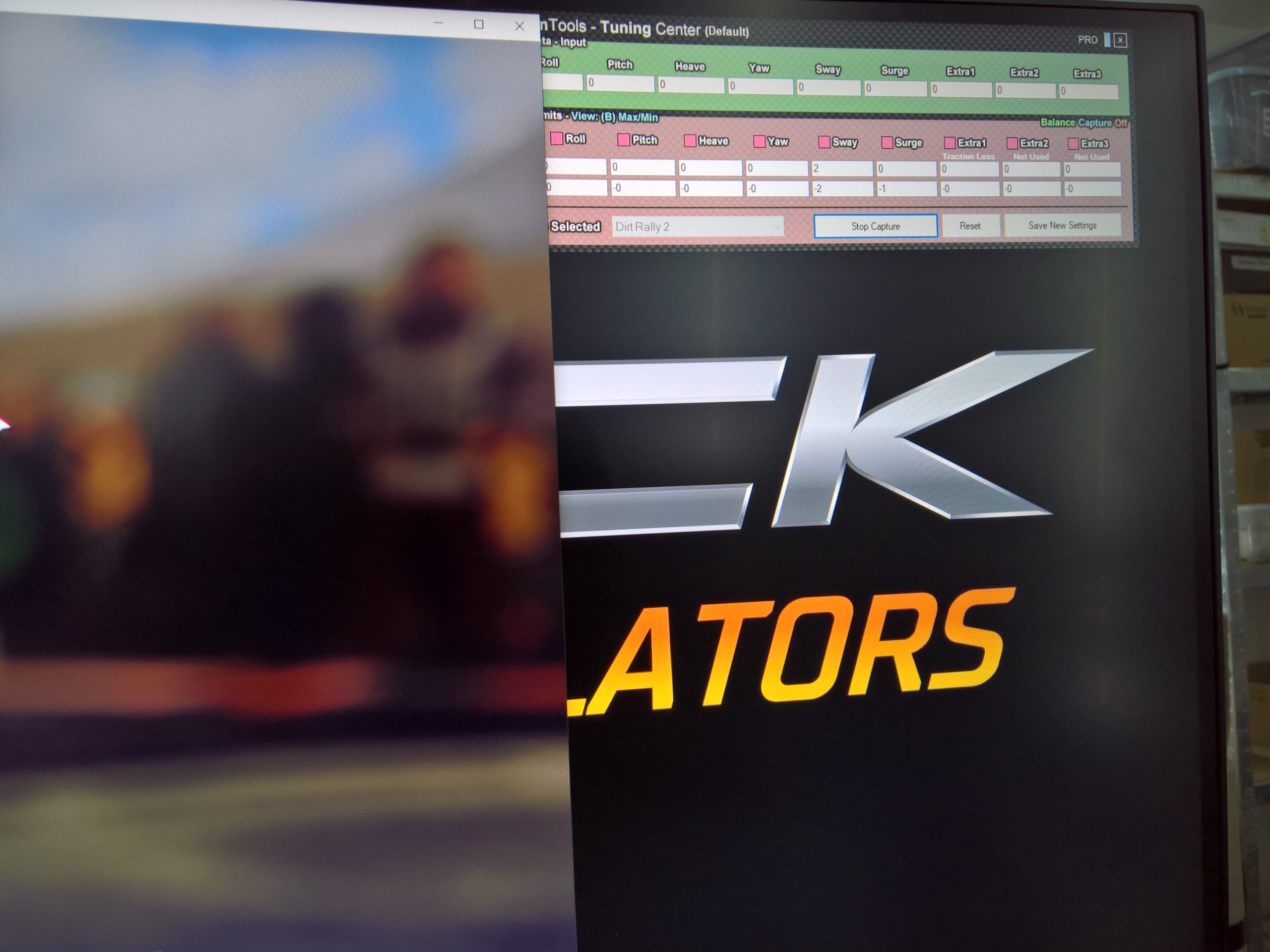

    No problem,
    Here you go. The fact Its not running in the first image isn't the reason why there's no output.
    Thanks for your help.

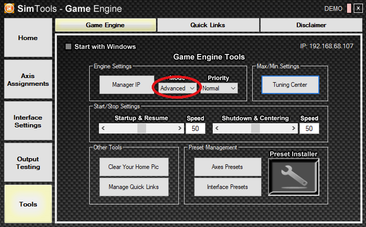

  12. yobuddy
    51,739Coins
    +5,205 / 19 / -0
    It looks like your using expert mode.
    This provides separate Max/Min files per axis settings.
    click here please and see if you have Max/Min settings for (B)
  13. yobuddy
    51,739Coins
    +5,205 / 19 / -0
    Or you can switch to advanced mode if you don't need separate Max,Min files per axis settings.
    Take care, :thumbs
  14. levers
    levers Active Member Gold Contributor
    Aug 18, 2016
    172
    UK
    1,032Coins
    +44 / 1 / -0
    Hopefully it shows in the pictures I have separate values for the A and B axis values. the issue seems to be the top level input values. In other games they are working for all 12 inputs but for some reason DR2 has zero values when I switch to the B axis inputs in tuning centre and there is no motion from the B axis actuators.

  16. levers
    Aug 18, 2016
    172
    UK
    1,032Coins
    +44 / 1 / -0
    I will PM them to you but they are no different to all the other games and I'm not sure how that helps but I'm happy for you to look at them. The issue seems to be the actual output from DR2 going to both the a and b axis. which you can see when in tuning centre. There are no input values at the top of the box for each DOF for B axis values. In A axis you can see the dynamic number values, in B axis they are all zero so it shouldn't matter what I set for the values

  18. levers
    Aug 18, 2016
    172
    UK
    1,032Coins
    +44 / 1 / -0
    I managed to get it working. Firstly, I'd made a schoolboy error on the one axis i.e. I hadn't set it but the other one was there and didn't work. I saved and opened the b settings from another game and it worked. I can now also see the dynamic values at the top in the a and b axis pages in tuning centre.
    On a different note I have had it on 2 setups where if you stop in the game and resume some of the motion stops and you have to restart the whole game for it to work but I've reinstalled the plugin and it seems fine.
    This plugin really brings the game to life so thanks for writing it!
