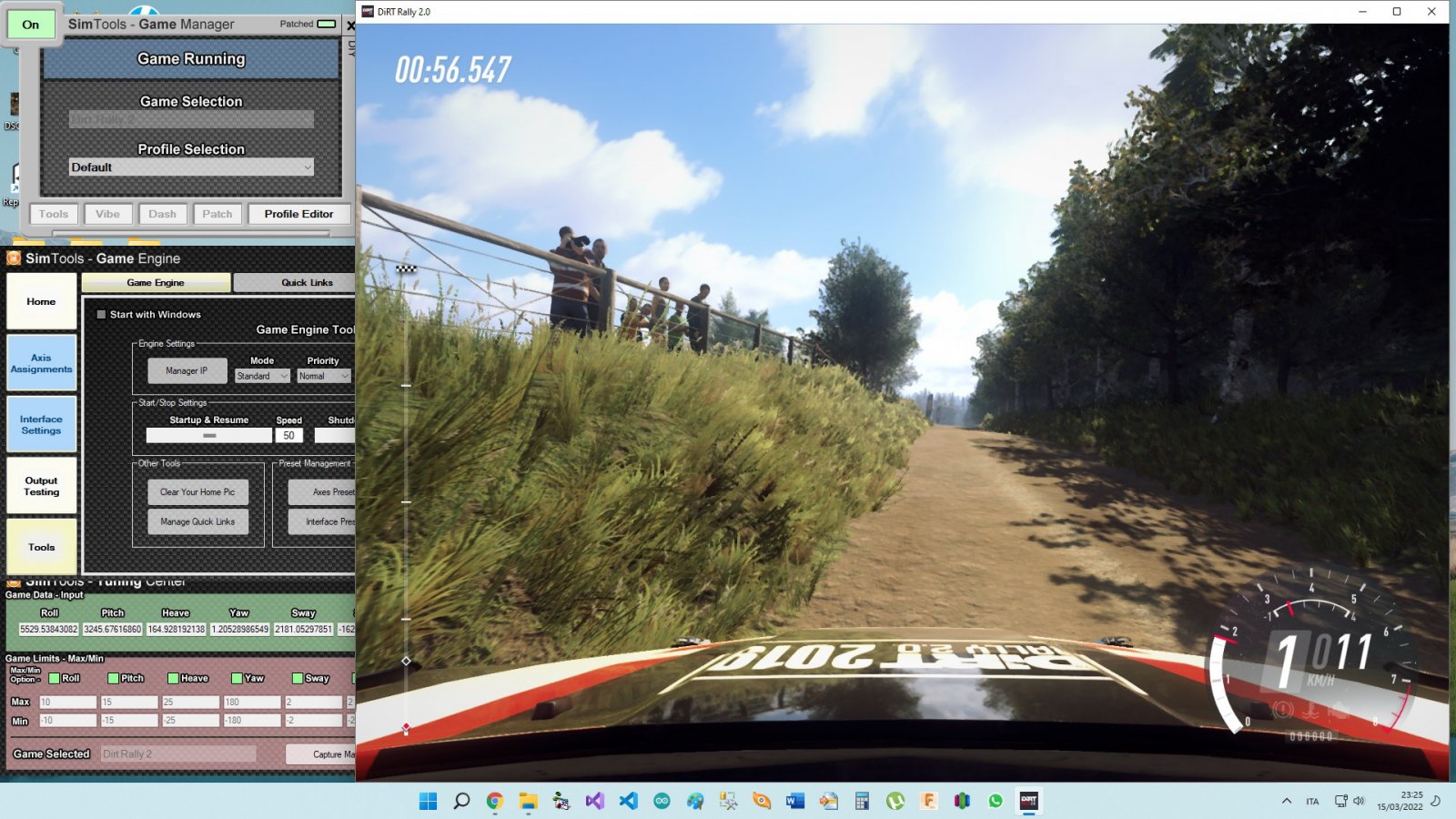

    Hello everyone, yesterday I installed DirtRally2.0 and from that moment my problems started ..... I read all the pages of this thread and tried everything, I got to the point that the telemetry data on the tuning center there are but the rig does not move. I finished a race, I quit the game, I patched and nothing moved and there was no telemetry data either, so following the various posts I changed the lines of the hardware_settings_config.xml file and the data arrived but no movement. Can I check anything else ??
    These are the lines of the modified xml file:
    <motion_platform>
    <dbox enabled="true" />
    <udp enabled="true" extradata="3" ip="127.0.0.1" port="4123" delay="1" />
    <custom_udp enabled="true" filename="SimToolsCustomUDP.xml" ip="127.0.0.1" port="4123" delay="1" />
    <fanatec enabled="false" pedalVibrationScale="1.0" wheelVibrationScale="1.0" ledTrueForGearsFalseForSpeed="true" />
    </motion_platform>
  19. noorbeast
    22,202
    154,675Coins
    +11,209 / 57 / -2
    The game data is there in the Tuning Center, so this is likely a settings issue.
    It would be helpful to include a picture of your Axis Assignments.
    See the tips in the FAQs about refining a motion profile, in particular take note of capturing the Max/Min values in the Tuning Center and then tweaking from there: https://www.xsimulator.net/community/faq/steps-to-create-a-motion-profile.228/
  20. Daguru
    Sep 4, 2013
    725
    Kitchen installer
    Wales uk
    233Coins
    +634 / 1 / -0
    Motion platform
    My best guess is max and min numbers too high:thumbs
