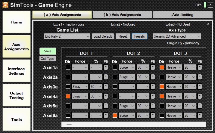

    This is the axis setup, I'm only using Sway, Surge and Heave

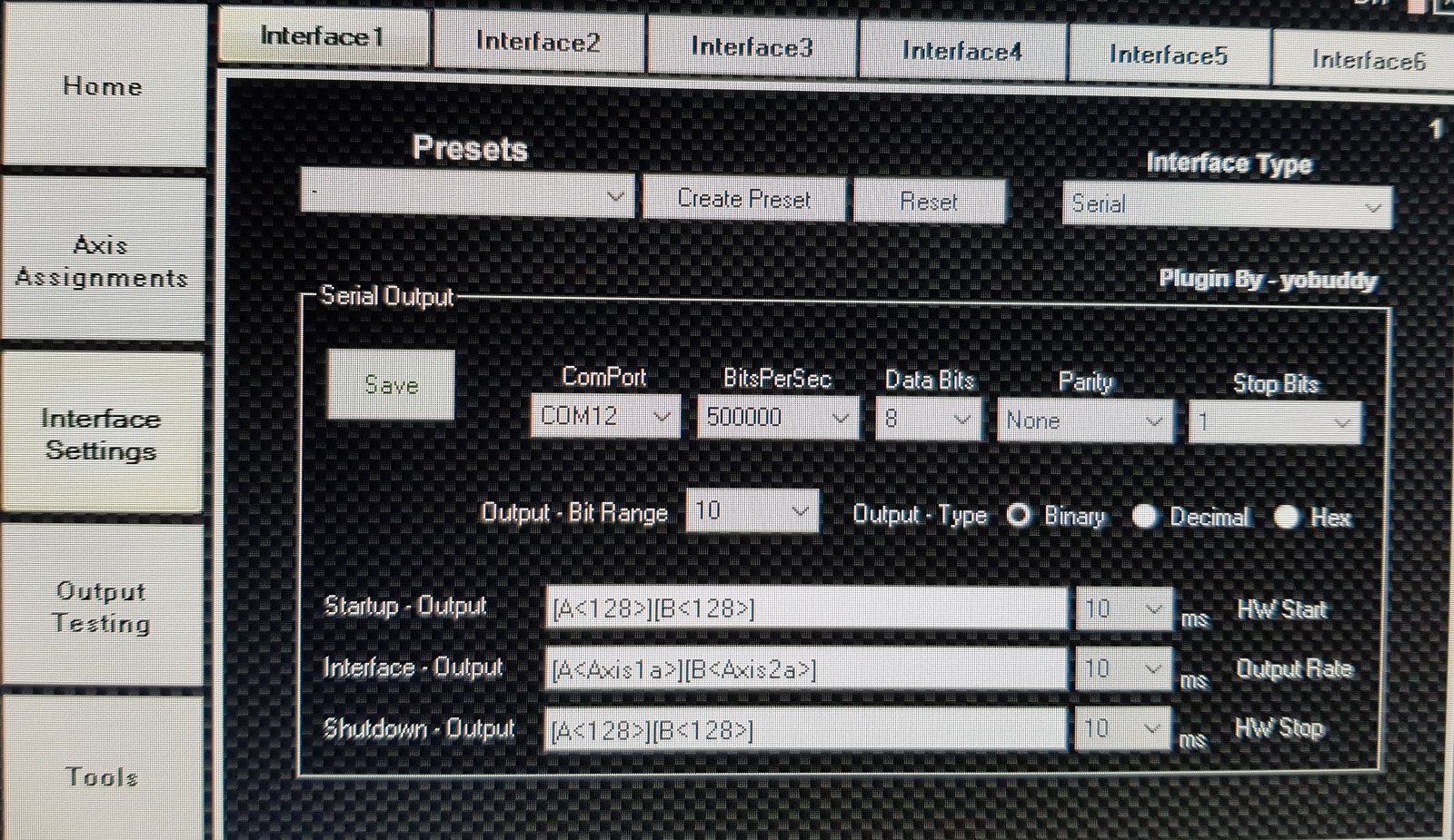

    I've a problem with dirt rally 2 plugin.
    I post photo, but my motors go only in one direction, when i move manual the motors with the option in output simtool, roll move only on the left, on the right don't move the motor, pitch on the left move the left motor down and on the right move the right motor up. I've 2 dof simulator with the motor inverted.
    Thanks...
    I post the photo of my setting in smc3.
    With flypt go all...

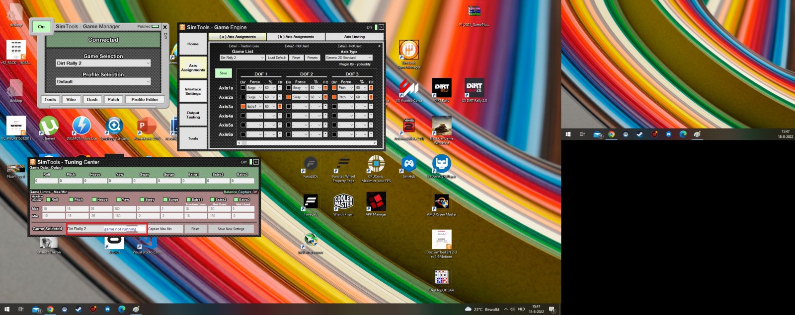

    Hi the dirt plugin for dirt 1 works but i cant get dirt 2 to work:
    1) Version 2.51 of simtools / PRO SIMU setup
    2) PC is set to English Local:
    3) completed a race and patched the game:
    <motion_platform>
    <dbox enabled="true" />
    <udp enabled="true" extradata="3" ip="127.0.0.1" port="4123" delay="1" />
    <fanatec enabled="false" pedalVibrationScale="1.0" wheelVibrationScale="1.0" ledTrueForGearsFalseForSpeed="true" />
    </motion_platform>"
    4) game conneted (game manager selects Dirt 2 / game engine turns blue) but in tuning center to record the values the game slected is ACC.
    I would appreciate all the help that i can get to get things woking.

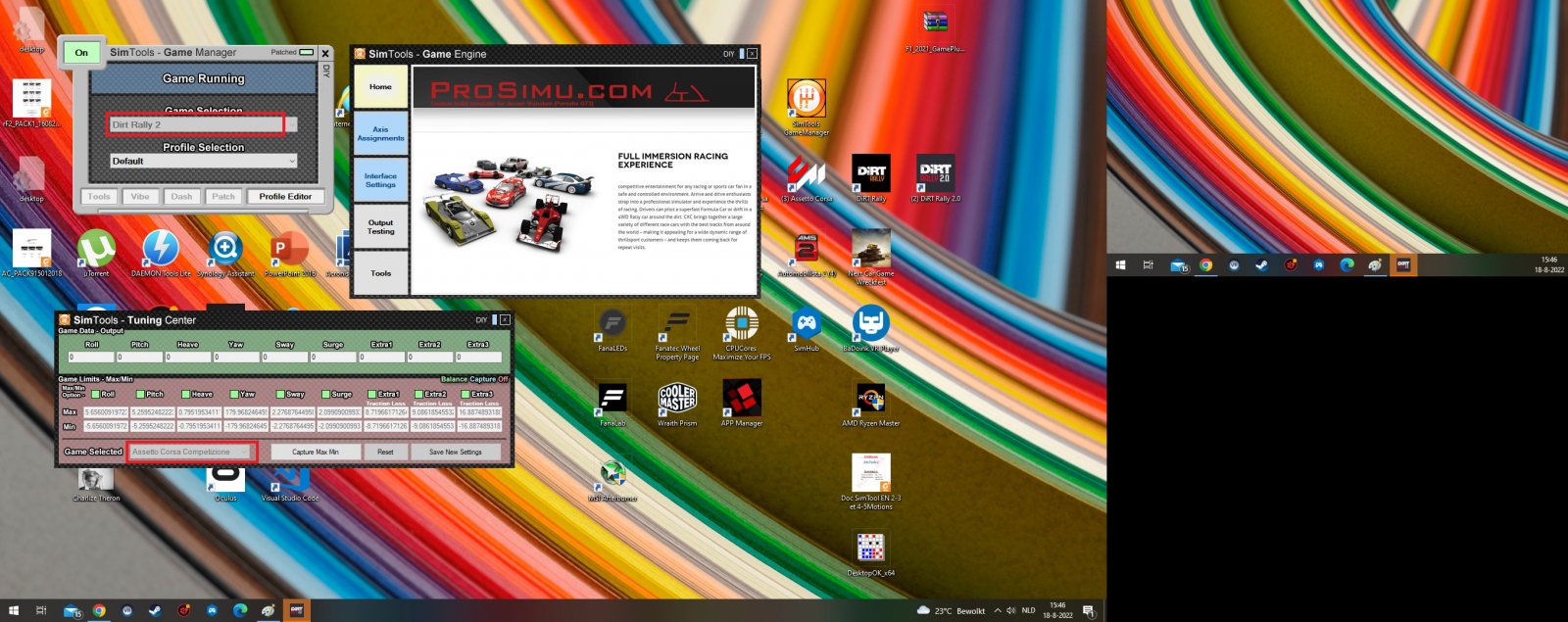

  15. Jeroen Vrancken
    Jeroen Vrancken ProSIMU T3000 Gold Contributor
    Jun 25, 2016
    31
    CPA
    Netherlands
    - 65Coins
    +11 / 0 / -0
    3DOF, SCN6
    In TC dirt available, once i start dirt it goes to ACC and the drop down is greyed out.

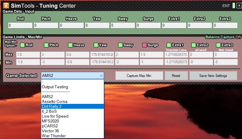

  16. noorbeast
    22,202
    154,675Coins
    +11,209 / 57 / -2
    The TC has a drop down for installed games, does DR2 appear there and should be selectable, like this:
  17. Jeroen Vrancken
    Jun 25, 2016
    31
    CPA
    Netherlands
    - 65Coins
    +11 / 0 / -0
    3DOF, SCN6
    It is, but when i select dirt and start the game it automatically switches to ACC.
