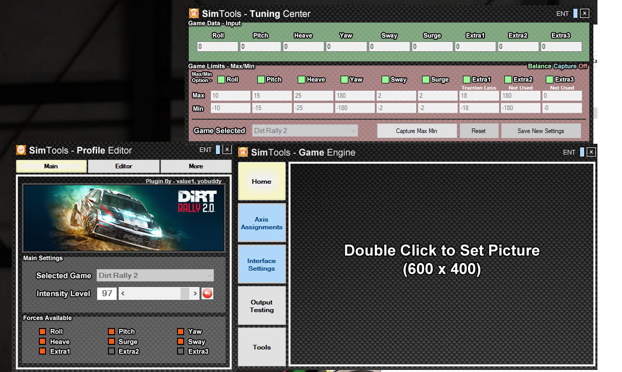

    i can´t get my plattform move.
    I finished a race and patched the game. When i start the game the actuators moves to center but when i drive there is no movement.
    Any idea?

    Does Game Manager turn blue and if so have you captured the Max/Min values in the Tuning Center: https://www.xsimulator.net/community/faq/steps-to-create-a-motion-profile.228/

    Yes, it turned blue. But i don´t understand what i have to do then.

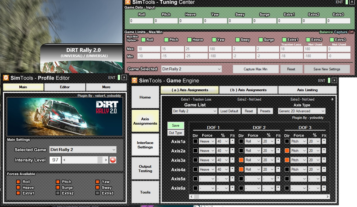

    this is during driving

    64 bit
    C:\Users\xxxx\OneDrive\Dokumente\My Games\DiRT Rally 2.0
    22,230
    154,849Coins
    +11,229 / 57 / -2
    Something could be interfering with the plugin. Temporarily disable any firewall and anti-virus, re-install the plugin, then see if data is transmitted to the Tuning Center.

    Being a codemaster game, you need to complete a race before patching the game.
    If the game is patched, please unpatch it with Game Manger.
    then launch the game and complete a race.
    After the race is completed, close the game and patch it with Game Manger.
    Then try for motion again buddy.
