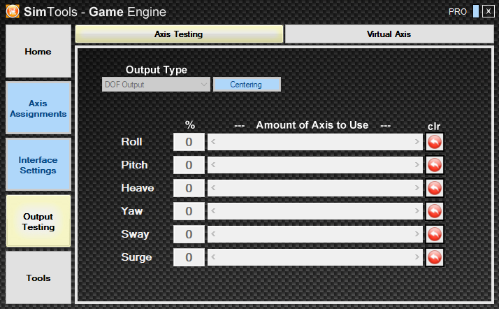

    Dunno if you can fix this one lol, I have major issues going on when you turn Game manager off in game , game engine starts going all crazy Axis assignments and interface settings buttons flash on and off blue and in output testing it keeps flashing up centering ??? I have to restart simtools by killing it in task manager to get it working again. Tried to grab screenies of what I mean ;)

  10. yobuddy
    51,781Coins
    +5,206 / 19 / -0
    This is the centering routine at work is all.
    You can turn it off in the tool section in game engine if you don't want to use it.
