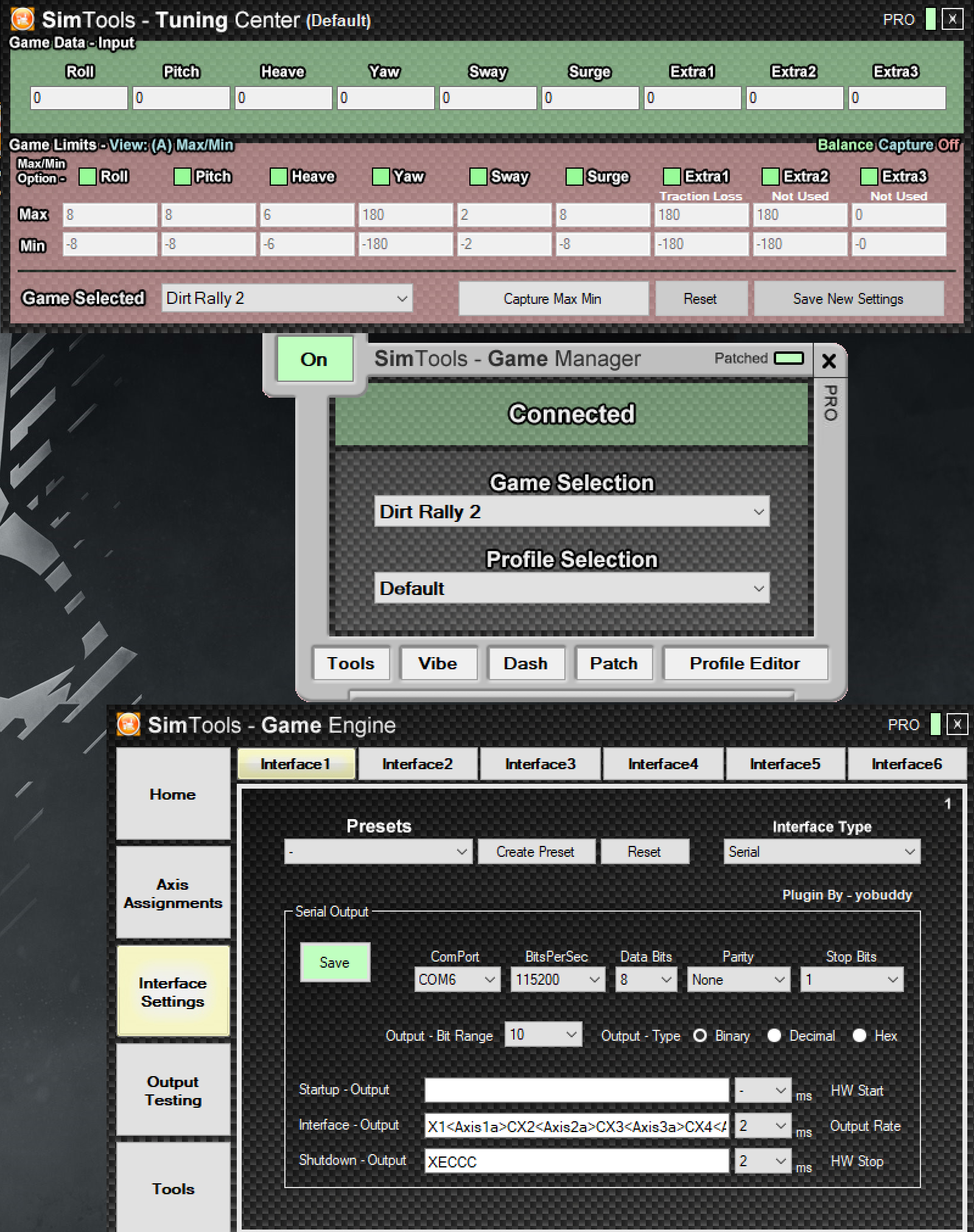

    Could I see your interface settings please?

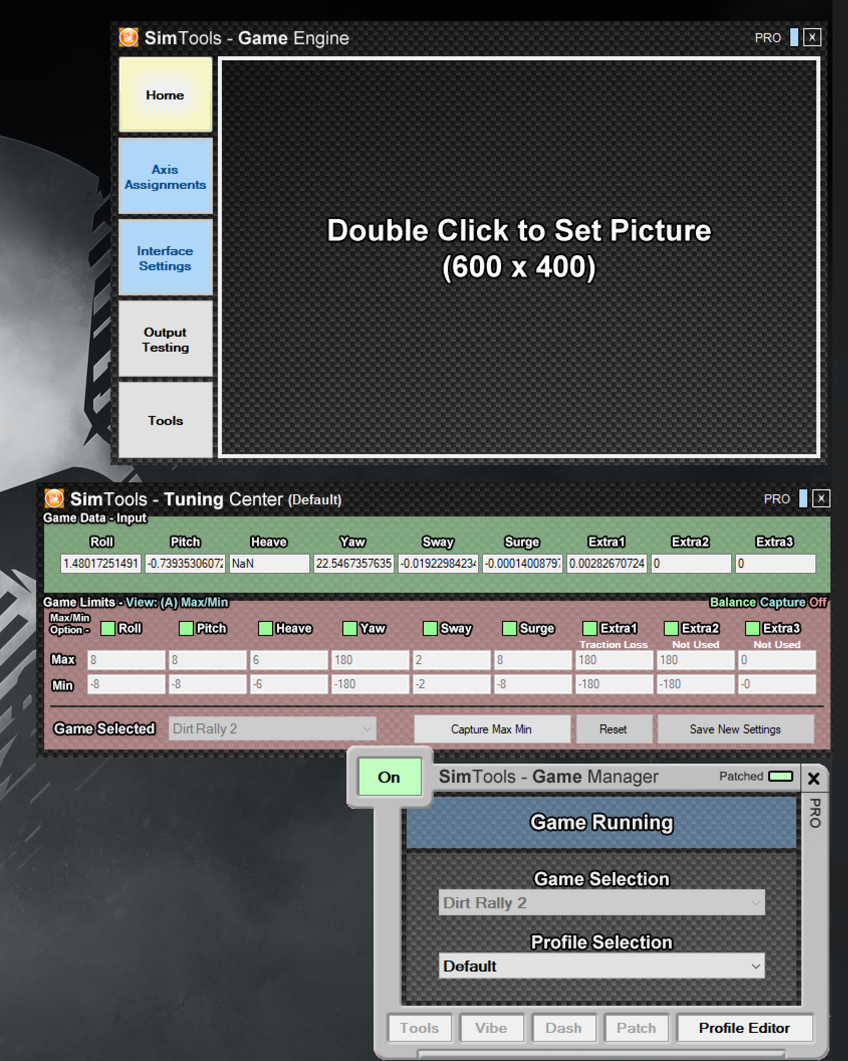

    hello, I have the same problem as them
    and I'm not "heave", the value displayed in tuning center is NA (heave)
    22,122
    154,358Coins
    +11,179 / 57 / -2

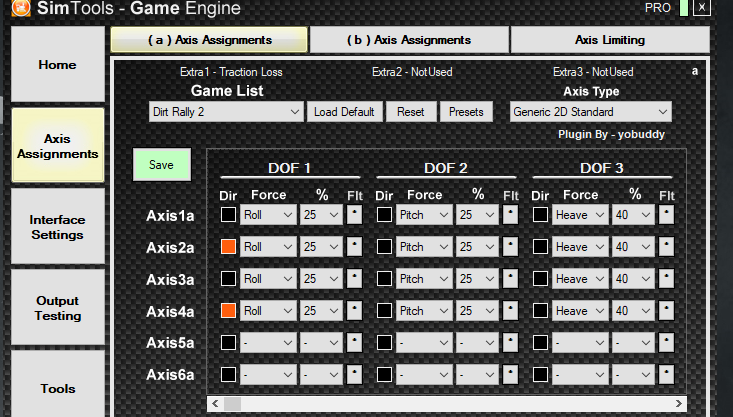

    Please post pictures of your Axis Assignments and also of the Tuning Center while the game is running in a stage.

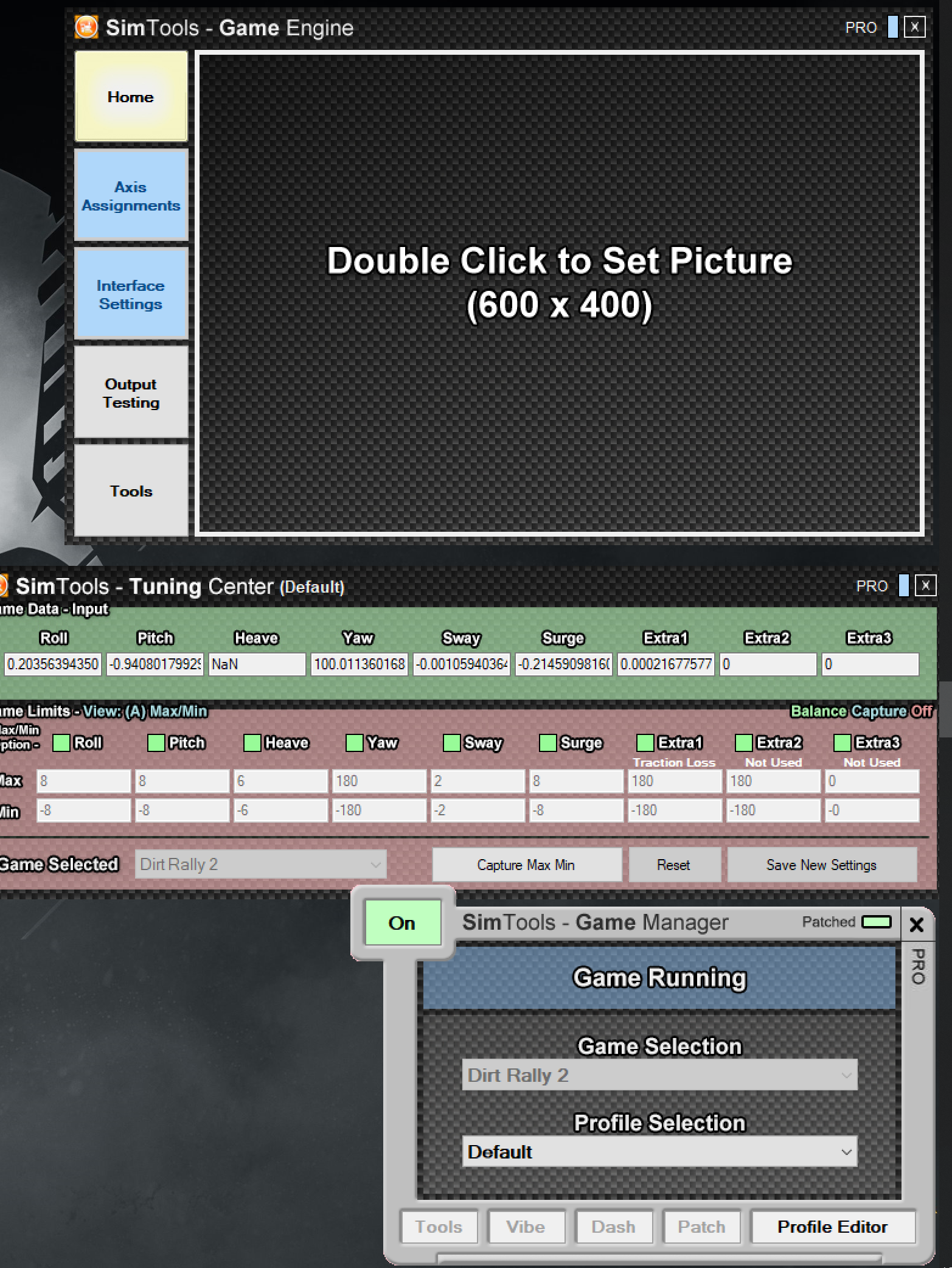

    simulator in motion but no heave
    [​IMG] [​IMG] [​IMG] :)
    second race, no movement[​IMG]
