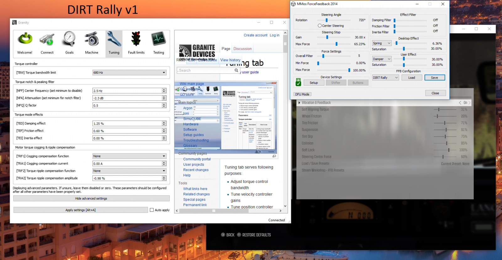

    Holy poop did i make some major progress today on my Wheel setup. Ill post up settings asap but its light years better than the default suggested here. (sorry to who ever created it) Tho I feel ive got a Very nice mix of Wheel weight and TONNNNNNES of minuscule details coming through the wheel. Uber impressed. :thumbs

    The TBW which i found to squeal like a stuck pig on 3300hz I also Dropped the TED .50% And what REALLY did it for me was going up to 100% on the mmo's and turning down the in game forces. Exactly as i do in Assetto, MMO's on 100% but In game Gain and On track gain are dropped depending on what car.

    Are your granity machine settings the same as your AC settup?

    Ya machine tab isn't something i think needs changing Per game.

    SAT and Wheel friction got tweaked a litttle bit in play last night. Up to 35 for SAT and up to 25 for Friction. It was a bit too light with those first numbers, but the overall road detail put the blinders on me. :D:p
    Also Id like to make it known, I basically drive 2 cars in DR, the Main car being the Lancia Delta Integrale and the 01 Suby.
