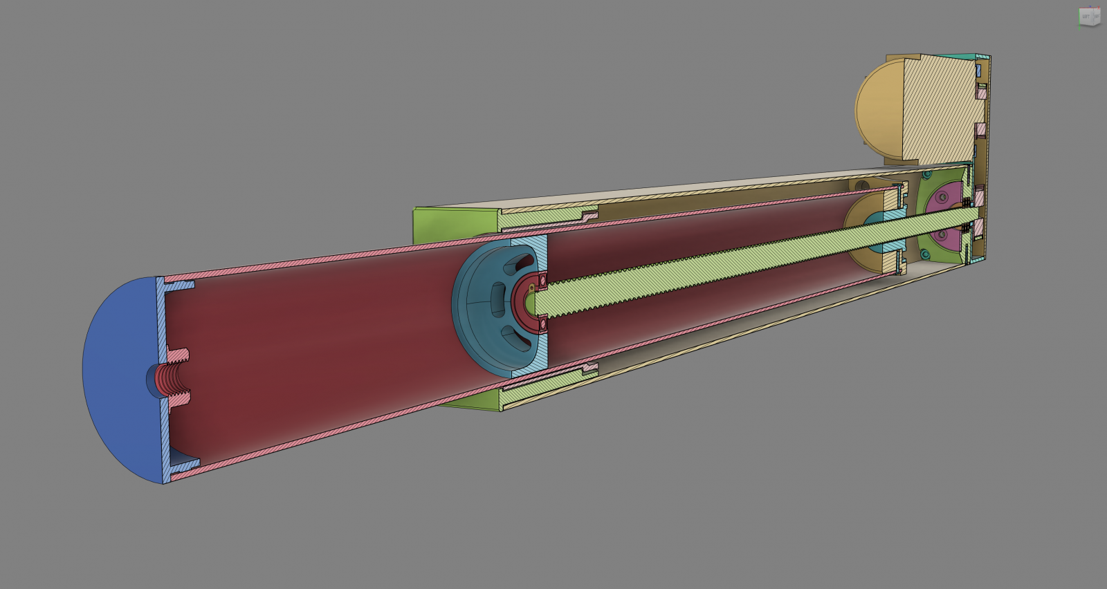

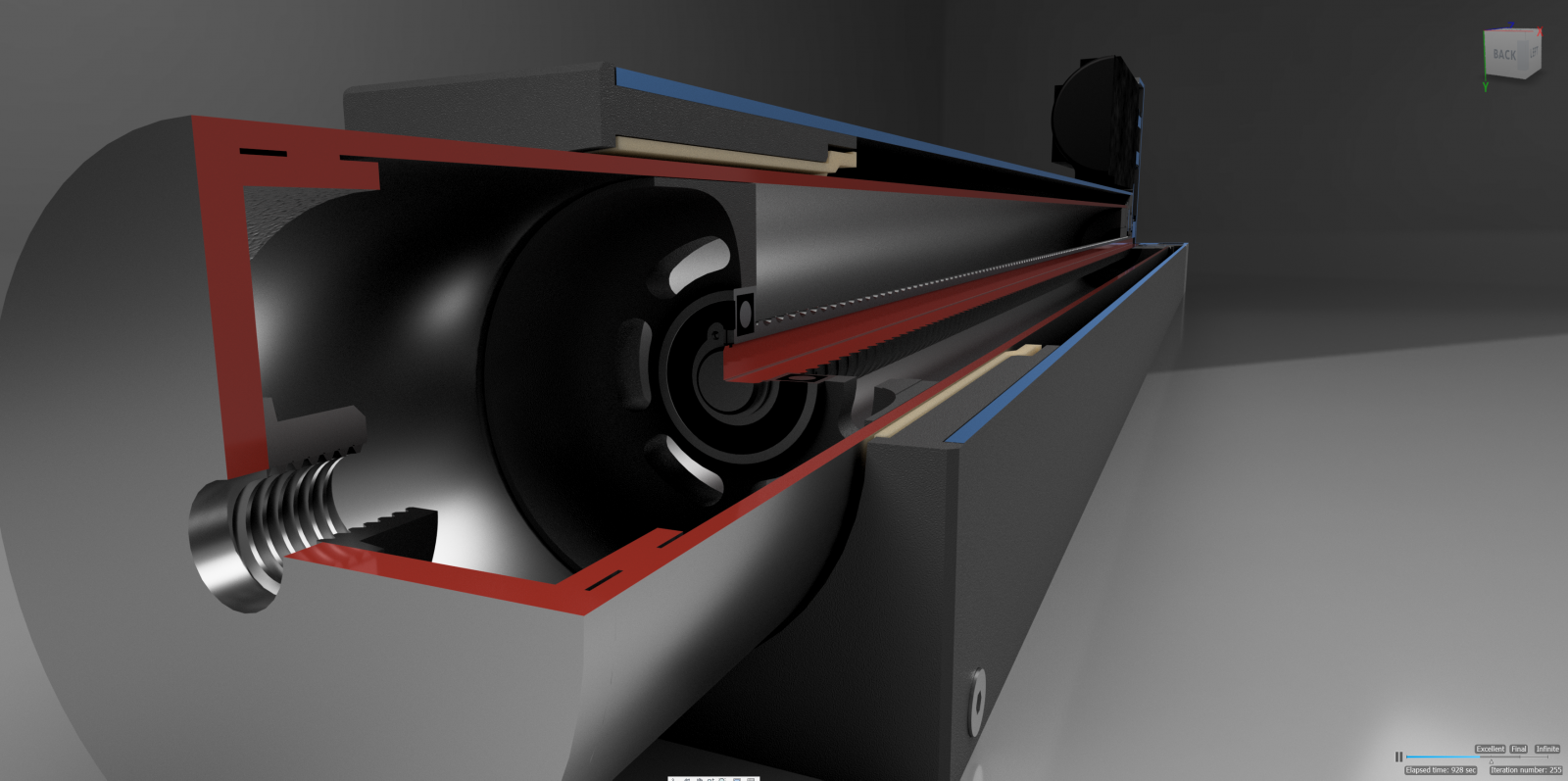

    Your explanation of various solutions for the linear actuator was extremely helpful. I am still struggling with one piece and haven't found solution if you (or anybody on this forum) can advise:
    How to stabilize the ballnut in the shaft. Ballnut needs to be moving up and down without rotating when ballscrew rotates. I understand there has to be some kind of "rail" that prevents the ballnut from rotating while allowing it to slide up and down and have seen few commercial examples but nothing DIY friendly).
    Is there a documentation anywhere how it's done?
    Thank you.
    P.S. I have seen standard SFX150 design which works with 80/20 but I am using a square tube, same as in this design from @Dirty

    Yes, the ball nut needs to be freely moving in the linear direction while being locked in the angular direction. So something has to take the reaction force of the motor turning the screw. There are two possibilities:
    1. Use a square tube and some sort of slider that moves linearly inside the tube but blocks rotary movement. In this case you can use simple ball joints to attach the pushrod to the rig as all torque is handled internally.
    2. Use a round tube (like @Dirty did) and ommit the anti-torque feature (at least internally). In this case there has to be a U-joint at the end of the pushrod that can take the torque and stop the nut from rotating.
    Solution #2 introduces a small error as the Pushrod and the nut will rotate a little bit when the rig moves around the yaw axis. You could theoretically compensate that error by mixing yaw into the position formulas of all actuators (I think, FlyPT Mover could do that). But in practice this is not really necessary. 20° of yaw will translate to ~1mm heave error with 20mm pitch screws. You won't feel that.

    I understand the theoretical concept, but what would be the practical implementation of either 1 or 2? Pictures or description with parts used, etc. I have seen commercial implementation on an actuator, it was very well done but not suitable for DIY. It was using Igus bearings and some proprietary parts.
    Also, @Dirty has description of the ball-nut housing but what would be acceptable print material for it? I would imagine PETG would wear out within the first hour and then that ball-nut housing will be banging against the outer square tube?

    A good example of a square tube/extrusion design is here.
    IGUS sells 3D printer filament especially designed for plain bearings. But I think PA (polyamide=nylon) together with an anodized aluminium or polished stainless steel surface would also work quite well.
