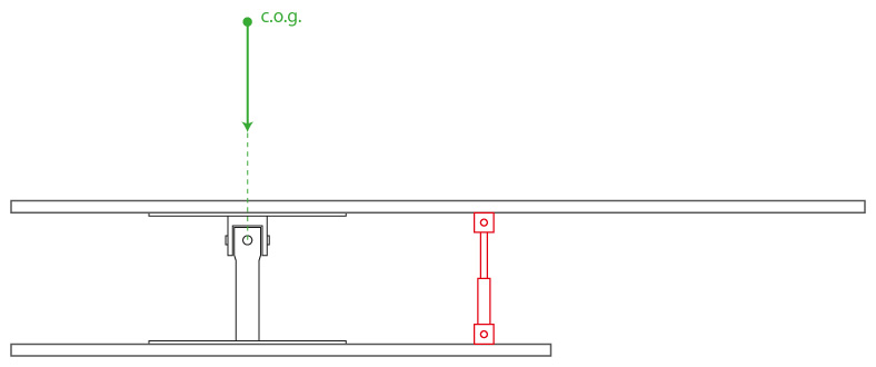

    If I'm correct this is what happens in this case:

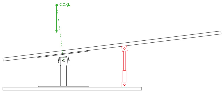

    Center of Gravity 1.jpg While the platform is horizontal and correctly balanced the center of gravity (c.o.g. for now) is centered above the pivot and no force is applied to the motors.
    Center of Gravity 2.jpg As soon as the motors start to move down the platform is tilted and the c.o.g. shifts next to the pivot which results in the platform falling on the motor side and the motors having to catch the falling platform and bring it down to the wanted position in the correct timespan..

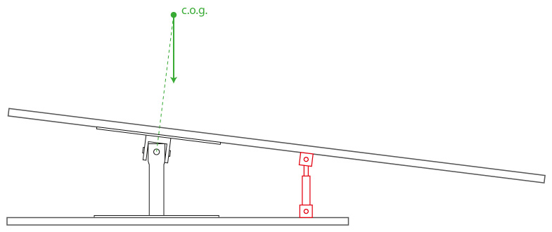

    Center of Gravity 3.jpg As soon as the motors start to move up the platform is tilted and the c.o.g. shifts next to the pivot which results in the platform falling on the other side, thus rising on the motor side and the motors having to catch the rising platform and bring it up to the wanted position in the correct timespan.
    So instead of needing springs/cylinders or ... to help the motors pull down or push up the platform we need them to help the motors catching it and bringing it back in a level position.

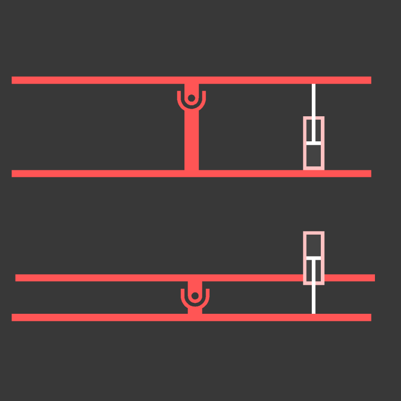

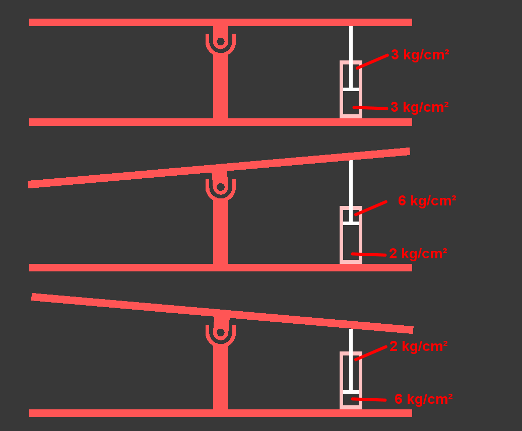

    I made a drawing to illustrate how it works without an expansion tank.
    In the top figure the platform is level and balanced, and the pressure in each end of the cylinder is the same.
    In the center figure the platform tilted back, moving the piston 50% up. The air in the top chamber is compressed to twice the normal pressure since the chamber volume is halved. The pressure in the bottom chamber is reduced by 50% since the chamber volume is increased by 50%.
    The bottom figure shows the same as the middle figure in the opposite direction.
    As you can see, the pressure differential in the cylinder will try to push the platform back to center. You can calibrate the force by changing the pressure in the chambers. Make a hose from each chamber with a schrader valve from an old bicycle tube on the end and fill the chambers with a bicycle pump, for example. Road bicycle pumps can pump up to about 10 kg/cm².

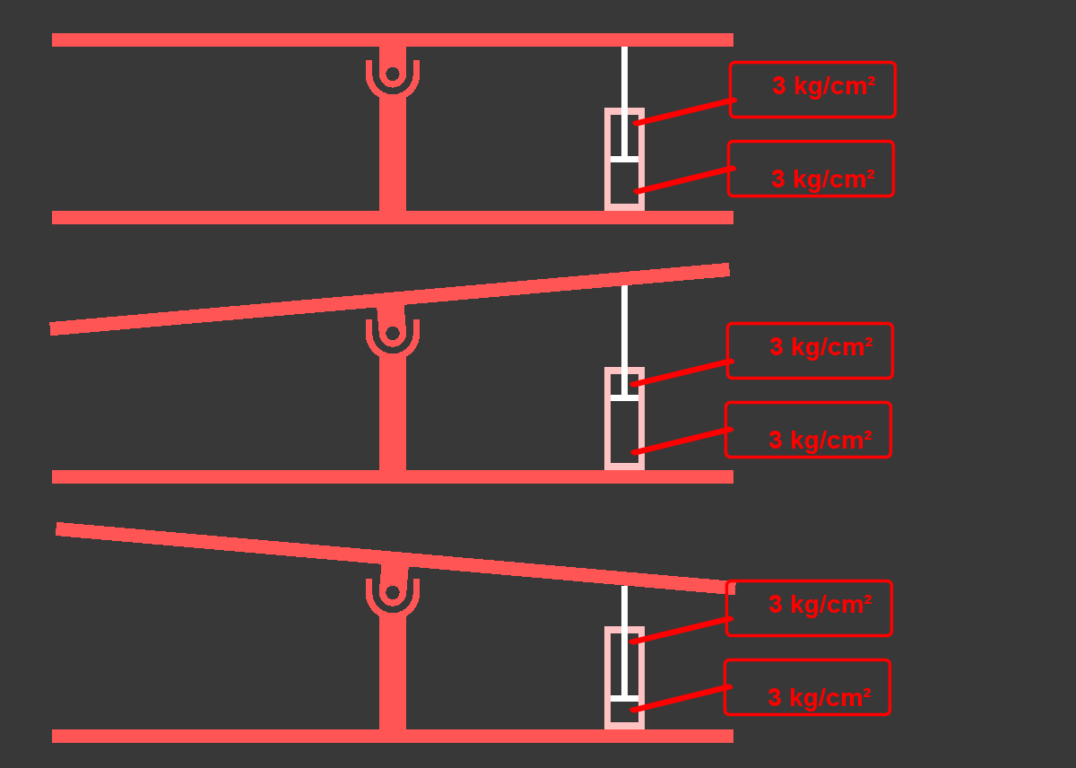

    And here's what would happen with expansion tanks. No pressure differential between the two chambers, means no force. Expansion chambers are great for something like Aldoz's sim, because they are under a contant lifting force. One cylinder for each actuator would be great in a lifting sim.

    And the bottom sketch is with an expansion tank only on the bottom connection of the cylinder and no connection at the top one?
    Wouldn't pressurizing the bottom part of the cylinder create a constant upward force (since atmospheric pressure is 1 kg/cm2 and e.g. we add 3kg/cm2 to the bottom part). Resulting the platform being tilted upwards when idle and due to the expansion tanks the motors only having to aply a little force to pull it down?
    Sorry for being a pain in the #$$ but I want to try and understand it ;)
  11. tahustvedt
    tahustvedt Member
    Nov 23, 2011
    201
    62Coins
    +8 / 0 / -0
    You're not a pain. :) I have another project going that needs something similar so it's a useful thought experiment for me too.
    With only the bottom chamber pressurized, and with an expansion tank, the platform in my drawing will want to tilt back all the time. The motor will have to oppose both the force from the cylinder, plus the weight of the sim when it has to move the platform forward after going back. The only time the motor will be relieved is when the platform is fully forward.

    Like the bottom drawing here.
