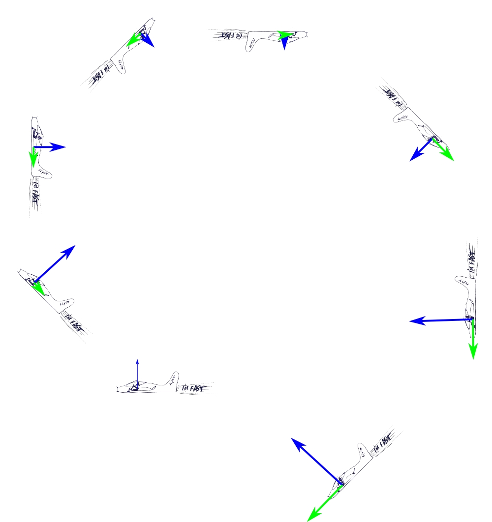

  6. pmvcda
    pmvcda aka FlyPT
    Nov 3, 2010
    2,260
    Portugal
    15,830Coins
    +2,705 / 17 / -0
    Use pitch for sustained heave acceleration? I don't think it's correct.
    Need to think more about it.
    Surge and pitch yes, and we are already making it.
    Now heave. If we have a constant 9.8m/s^2 down, it means, we would have a constant pitch down. Doesn't make sense to me.
    EDIT:
    Arrows show the "pressure" of the seat we feel on the body.
    Heave in a loop (blue):
    0º Heave is just 9.8 (gravity)
    45º Heave force increasing
    90º Heave at maximum while climbing
    180º Inverted, we have the minimum heave
    from there, heave increases.
    We change heave in the rig to feel those changes, with a filter that would have washout so we regain range to more heave. I'm not sure, but I think that LP(HP) might be a good solution, where the HP should allow a good range of frequencies.
    I think we need the filter in such way, that we have heave in the rig until the heave force becomes equal to gravity, maybe around 100º. Then the washout should make it's work to give us enough range to start a new heave when we reach around 250º.
    Surge in loop (green):
    0º We have no surge, we are at constant speed to start loop
    From there, as we climb, surge changes as we loose speed (rig goes back so we feel deceleration)
    From 180º down, surge changes as we gain speed (rig goes front, we feel pressure on the back as speed increases).
    Now that's that deceleration/acceleration (in longitudinal direction - surge) that we can apply to pitch.
    Idea here is to use rig surge for changes (high pass, but smoothed) and send low pass to rig pitch.
    Conclusion, why there's people doing 360º rigs?
    Only advantage is if you are doing steady inverted flight.
    For our rigs, inverted steady flight is the rig just in neutral position. There are no accelerations, except gravity, and that after a small amount of time is already washed out.
    Your cueing is done just visually in your VR headset.

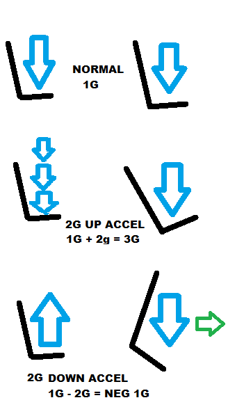

    Thanks for the responses guys. @pmvcda
    Here is where I see the problem. During the upward part of the loop, because we can not apply a sustained heave cue the pilot is basically going to be feeling the green arrow cue as the main force.
    But in reality I'm almost certain the main force the pilot would feel in the climb is the blue arrow. Because of that I don't think we should accept that it is ok to not have any cue for the blue arrow during the climb (after the simulator heave travel has been used).
    Now here is my basis for using pitch tilt for sustained heave:
    Sustained upward heave acceleration "pushes you down into your seat".
    Platform Pitch up will make you feel "pushed against seat" We pretty much ignore 1G straight down, but by tilting so that it's not straight down but into the "corner" of the chair I think it will be perceived as being pushed into the seat.
    Sustained negative heave acceleration makes you "float up off the seat".
    Platform Pitch down will make you feel like you are going to come out of the seat. (not perfect but better than no cue IMO). The green arrow is the direction the pilot will feel he is being pulled (because he is ignoring the slightly less than 1G now going straight down). Now note that with the platform tilted forward the green arrow (perceived force) is actually a somewhat upward angle, negative heave! Go ahead, tell me I'm a genius. =P
    heave tilt.png 62990
    Now in @pmvcda drawing, on the up side of the loop once the sim runs out of heave travel the cue is pitch down (because it is cue for negative surge, airplane slowing down), which will make the pilot feel somewhat weightless falling forward out of the seat , but this is incorrect overall effect caused by the missing sustained heave cue (the deceleration cue is actually an upward cue to some extent as per my green arrow above). The pilot should feel pushed down into the seat (from heave cue which is missing). So if we use pitch to push the pilot into the seat as in my drawing I think it will be better.
    Even better, this cue will be additive to the cues at the end of the loop (or dive) when you are pulling out of the dive and G-force should be at it's maximum, enhancing that cue which is good!
    What's more, I don't think my idea of tilt coordination for heave axis will cause false cues elsewhere. In a normal climb there is basically no sustained heave, so this cue will not occur and the pilot will simply feel the airplane decelerating (negative surge cue) as is proper.
    In a banking turn the heave cue should only be momentary as the turn is initiated, so my proposed cue (which is for sustained heave only) should not occur.
