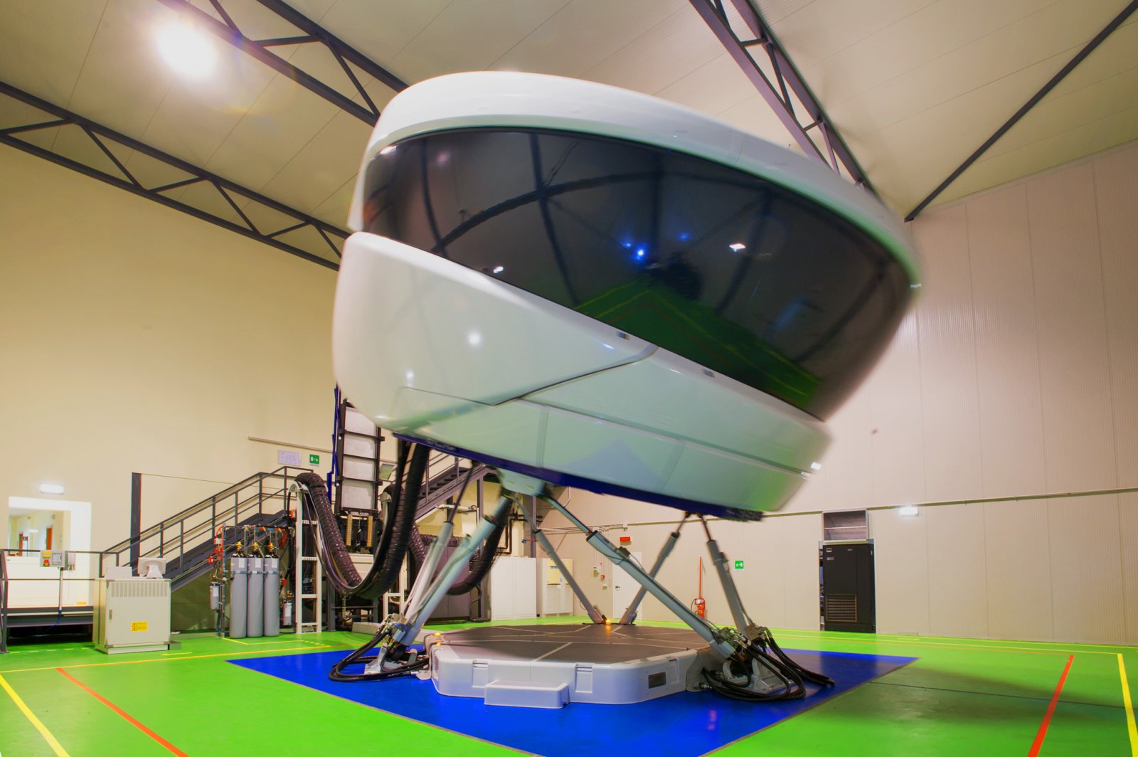

    On a sidenote:
    These hexpods...
    ...are certified for "Zero Flighttime Training". That means you can get a license without ever even having seen the real aircraft. It is not because they provide 90% correct cues (which they don't), it is because they avoid 99% of the false cues.
    Dirty :)
    ...oh, and did I mention that I'm hungry for coffee and cake?
