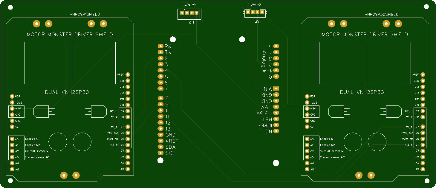

    I found another post from @noorbeast (you are a champ mate!) pointing me to the motors I have now - from MotionDynamics here in Australia - https://www.motiondynamics.com.au/worm-drive-motor-12v-24v-200w-180-rpm-20nm-torque.html
    After ordering a couple of those, I checked out another post HERE that shows how to run each motor with it's own Monster Moto shield. I then jumped onto easyEDA.com and made up a quick custom PCB design, then used JLCPCB.com to have the boards printed - 5 boards delivered for roughly $21USD. The plan here was to be able to easily drop in a new Arduino / monster moto shield if I every blew up a component again. Here's the design:
    So the plan was that I'd solder in some female headers for the monster moto shields, and male headers for the arduino. Then then basically flip the arduino upside down and just pop it on top of my PCB, and slot in the Monster Moto shields, and away I'd go.
    Unfortunately I'd stuffed up the placement of the Arduino pins - so long story short, the arduino now sits underneath this PCB.. oops.. But for $20USD, I'll end up just tweaking the design and having some new ones sent out. This design will also be updated shortly with some sort of connector added so I don't have to solder the 12V lines to the monster moto shield. Currently I haven't got a connector rated to a high enough amperage between my PCB and the power supply / motor lines, so I'm still soldering onto the shield, but that will change soon.

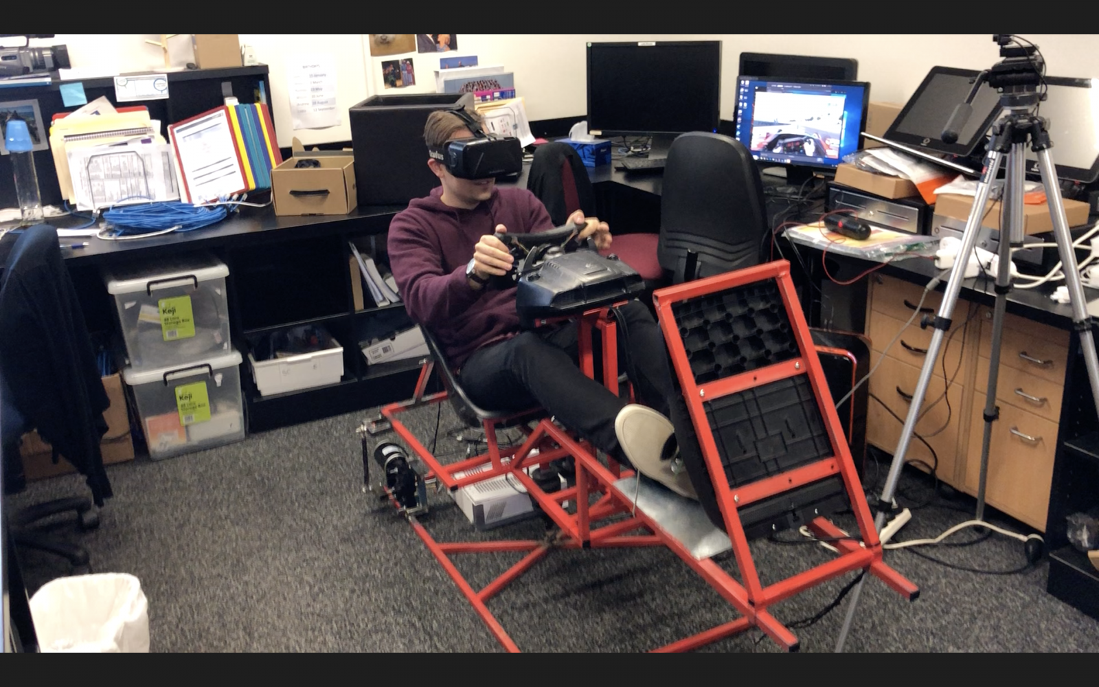

    Alrighty, well about time I probably posted an update.
    The legitimate Sparkfun driver boards worked straight away, so lesson learned.. After dropping them straight onto the custom PCB I had made, all worked well. I've gone with using the coolers mentioned at https://www.xsimulator.net/community/threads/xilence-cooler-for-moto-monster-sparkfun.6277/ which are also working well. I know others have asked about how to mount these, and I'd be interested if anyone has a good way. I've gone with cable ties for now, which I'm not so keen on, but it's working for now.
    Now that I have motion working, I'm starting to find a couple of things that need a little tweaking, so a few things to possibly look out for if you're just coming into this:
    • There's a little slop between my motors and the steel rod / lever arm. At this stage it's looking like I'll re-drill the hole through the rod and the motor itself and put a tight-fitting fastener through there to try to eliminate it. The effect doesn't seem too bad, but I'm sure it will be a much better experience with the slop removed.
    • For the current design (attached), the steering wheel and pedals have now lots some support due to some modifications I made to the frame. If you modify your design much, take a sec to look at how different parts are supported. I managed to have one of my potentiometers come loose during a test/calibration run (no driver), and the whole thing went off like a bucking bull. Everything seems to still be OK, but to be honest I'm surprised nothing broke - I think I got off lucky, so just a heads up :)
    One last question for anyone with a similar setup - In a couple of instances, one of my motors will get stuck at it's limit (straight up/down). I think this is stopping at the clip input limit I set in SMC Utils. But at those times, it seems to stop completely until I manually rotate it back to the neutral position. Is this expected? I have set the absolute limit a fair way past the clip limit bounds, so I don't think it's turning to that limit, but it may be - I still have to test it further. It may have something to do with the slop that I need to take out of the system, but just wanted to know if that behaviour indicates a particular limit that's set in SMC Utils being reached, or if it sounds like something else.

    22,045
    153,866Coins
    +11,152 / 57 / -2
    When it comes to levers they are very ineffective with respect to torque if they are using more than 40 degrees up and 40 degrees down.
