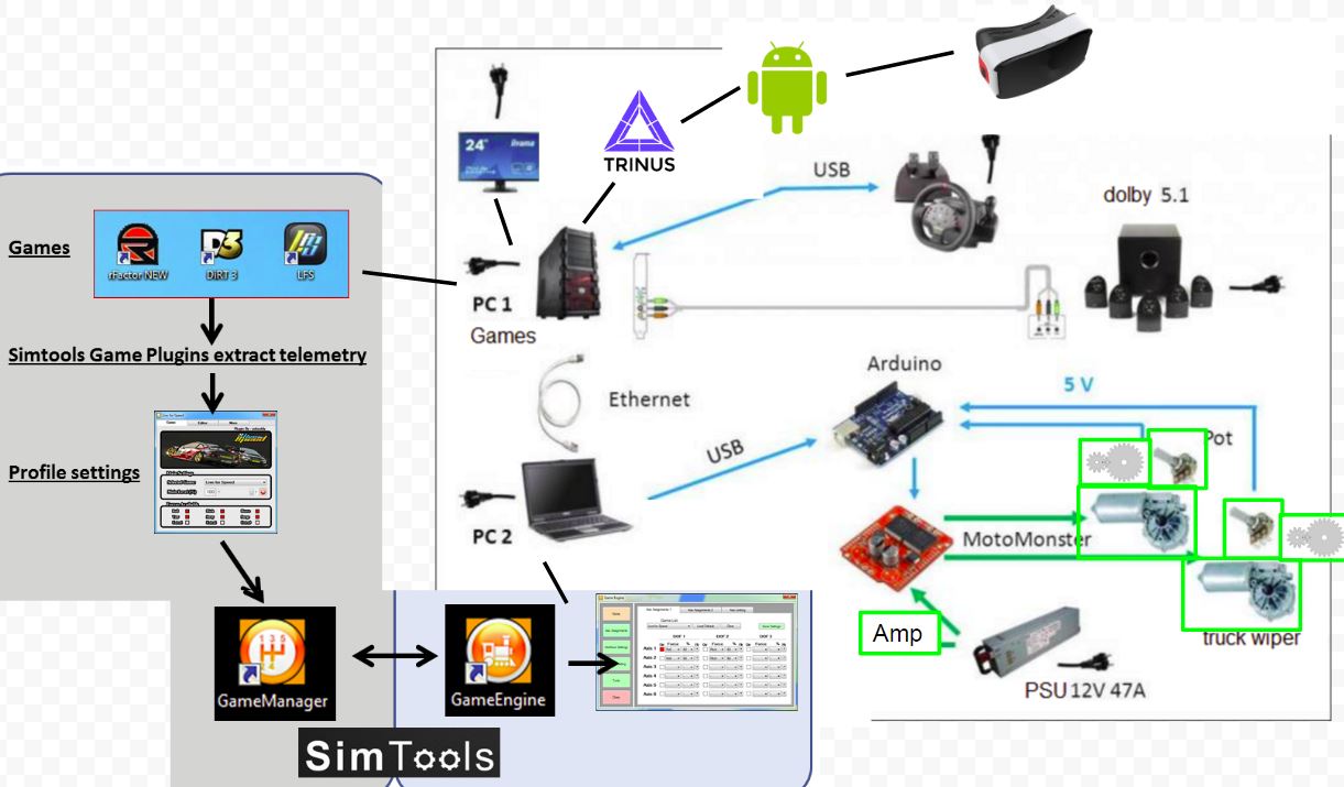

    You forgot the price for the two motors. If you're using common wiper motors, you should have them for 30€ each on the bay.
  6. Martoul
    Martoul Member
    May 4, 2016
    37
    Paris, France
    177Coins
    +17 / 0 / -0
    Yes... I forgot the 2 wiper motors for Renault Clio III secondhand 2 x 30€
    :roll
    If you add 60€ -> you still obtain 201€ :)

    I update the price list according the community advice:
    Car universal joint (cardan) secondhand
    20€
    2 x 30€
    Arduino uno
    3€
    Sparkfun Monster Moto Shield
    5€
    2 potentiometers FCP22E
    5€
    alimentation 12V 30A
    25€
    4 gears for potentionmeter coupling (3D printed)
    0€
    screws
    20€
    wood
    20€
    Cables
    5€
    reinforcing metal plates
    15€
    heat sink
    1,5€
    Cooling fan
    1,5€
    Total = 181 €
    Optional parts :
    Ampermeter + shunt
    7€
    http://www.ebay.fr/itm/Double-LED-V...328245?hash=item487c233835:g:KiQAAOSwKtVW0BNp
    steering wheel and pedal secondhand
    30€
    VR cardboard
    5-20€
  8. Martoul

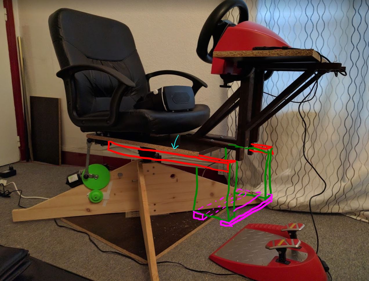

    I try to upload more photos this week-end.
    The main idea to save money is to use the articulations from the wiper motors.

    Hi Martoul and thanks for sharing your project, it's seems very funny and doable for me, so that I would like to try it by myself...
    Could you please update the links for the monster moto and the potentiometers FCP22E, because they are dead and I don't want to command the wrong ones?
    Also, could you point me an alimention on AliExpress as I want to group my command (and I don't have an account on Amazon)?
    Anyway, thanks again and in advance.
    Stan.

    Hello, I'm also a beginner so I'm not sure of the following informations.
    I think, you can buy any moto monster with 2 VNH2SP30 :
    https://fr.aliexpress.com/wholesale...20161122033420&SearchText=monster+moto+shield
    and any potentiometers FCP22E 10K ohm :
    https://fr.aliexpress.com/wholesale...22033737&SearchText=potentiometers+FCP22E+10K

    Thanks Martoul (and obobo), here is the list of the electronical/electrical stuffs that I am going to command:
    shoppingcart.aliexpress.com/shopcart/shopcartDetail.htm?spm=2114.13010208.1000002.2.4W93L9
    Thanks again.
    Stan.

    Few people suggest me to fix the pedals on the moving platform for more realism.
    It's a good ideal but I want to do it very simple and cheap.
    I also want to avoid to move the wood board (indicated in blue) because there are already a lot of screws through it to fix the motors and the cardan.
    The idea is to fix 2 metal L profiles (in red) + 2 wood boards (in green) + 2 wood boards (in pink).
    Do you have easier/cheaper ideas?

    We can't see your shopcart.
    You have to send us the links one by one.

    My remarks :
    - power supply input is 220V. Is it ok with your country?
    - FCP22E looks OK
    - arduino looks OK. You will need a USB cable for PC connection (see below picture)
    - moto monster looks OK.

    I'm from France too, so everything seems good, I'm gonna go for it, the picture of the full process seems very clear (thanks for it)...
    As I also wanted to start a project of wind simulator (like Avenga76 did), I'll see which one I'll start at first
    Thanks for the inspiration, and thanks again Martoul

    ça à l'air bon pour ta liste
    pour les simulation auto, je ne mettrais pas les pédales mobiles
    si tu fais des simulation aériennes, par contre, c'est bon
    It looks good for your list
    For auto simulations, I would not put the mobile pedals
    If you do aerial simulations, on the other hand, it's good
