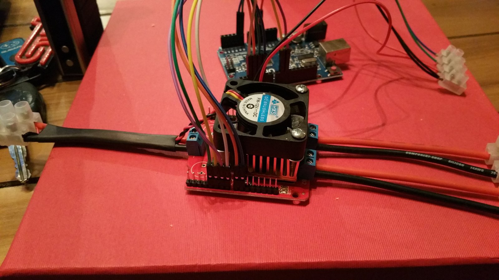

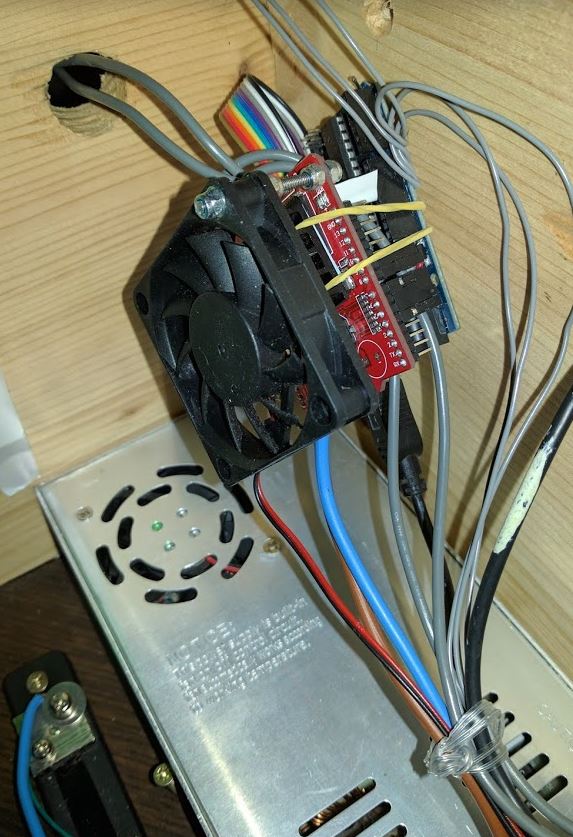

    Good idea, I will add a fan for cooling!

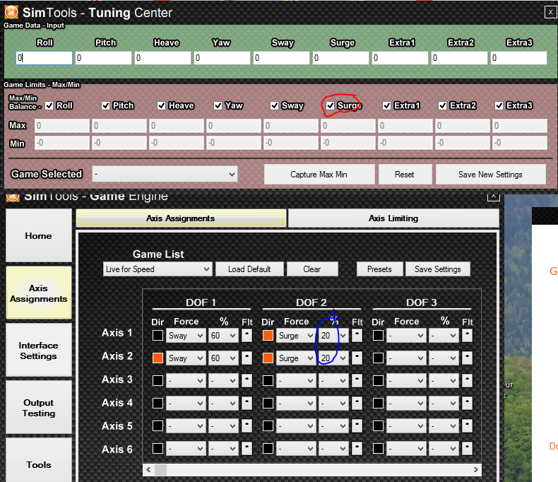

    Hello noorbeast, I tried to adjust the motion profile but my english is not so good and I have difficulties to understand the tutoral (link you sent me).
    I put 20% on Surge (in blue) but my simulator is not moving when acceleration.
    50% seems to be lighter than 60% but I still can't feel the vibrations on the track surface bumps.
    I also tried to uncheck the Surge (in red) but nothing happens...
    How can I easily have the vibrations please?

    You also need to adjust the Tuning Centre values, with the game connected.
    The lower the value in the Tuning Centre the sharper the simulator response.
    If you tell us what game you are working on and post pictures of the Tuning Centre while the game is connected then members can give advice on what values to try.
    We have plenty of dual language members so perhaps @RacingMat or others could help translate explain the basic steps of setting up a motion profile, as they are important to know and you really need to do a profile for each game.
