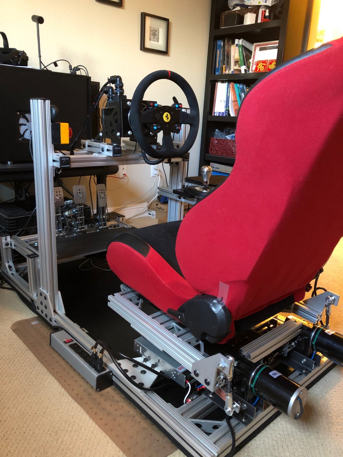

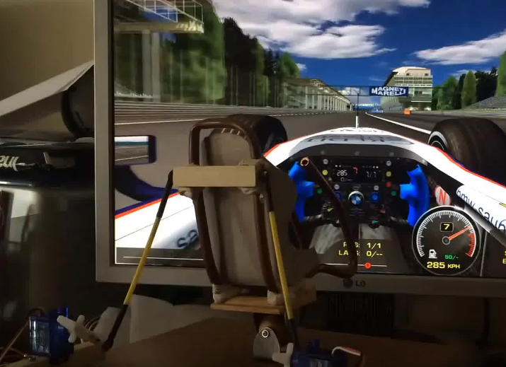

    I would like to ask for some clarification on some general things related to building motion platforms. I wasn't sure where to ask but I will be building a miniature 2DOF simulator for my first project, so I guess this will work.
    I have some questions related to the mechanical construction of motion platforms, mainly connecting various components together.
    I will post three 2DOF motion platforms, where each have a varying motor position and rod connection. All these platforms are from the talented people of this community.
    As you can see in all 3 images, I am puzzled as to how the motor position is chosen in motion platforms. You can see that image 1 has the motors positioned a little forward with the U-joint behind, image 2 has the motors positioned all the way back, and image 3 has them positioned quite far away and the rods don't even connect vertically. However, these are all working systems. How do you decide on this?
    For one, I am assuming the u-joint has to be right below the center of gravity, or at least below the player? And further on, how do you decide on how to connect the rods, so that they will be able to rotate the platform to every possible extent (as required by the simulation). How do you also choose what type of rods to use to make sure that they do not break under pressure and use?
    I am foreign to all these concepts and this is my first ever question to this community. I hope to be able to build many cool simulators with the help and support of all of you. Can't wait to share my own work!
    Thanks. :)

    All simulators are a compromise of some sort, and many design and other considerations come into play, from aesthetics and cost to parts availability and physics.
    Th U-Joint should be placed as close to the seat as possible and the rig should be balanced with you and all peripherals attached: https://www.xsimulator.net/community/faq/universal-joint-placement.108/
    If using wormdrive boxes a very slight positive weight balance bias preloading the gearboxes helps minimise the inherent backlash: https://www.xsimulator.net/community/faq/wormdrive-backlash.293/
    SimCal lets you play with some of the possible design Vs physics trade offs that are inherent in any rig: https://www.xsimulator.net/communit...e-linear-speed-and-forces-of-your-design.270/
    There are also other design/experiential considerations, such as seat shaker Vs full frames: https://www.xsimulator.net/community/faq/full-frame-vs-seat-shaker-designs-which-is-better.213/
    The designs you have posted are commonly referred to as a full frame knee design, a compact (rear motor) seat shaker design, and a shoulder mount seat shaker design. All have their pros and cons.

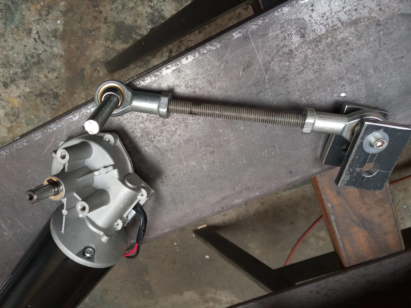

    Motor.jpg Hey there;
    I´m actually thinking about the best way to connect the shaft with the "lever" to move our upper element.
    Do you have any hints for shaft-to-collar connection ? So far its planned like you can see in the pictures. The only missing part is the connection between motor and the rest.
    We also have an own thread, go visit us there if u want to stay updated! cya
    Motor 2.jpg 59684
    thanks for your help guys
