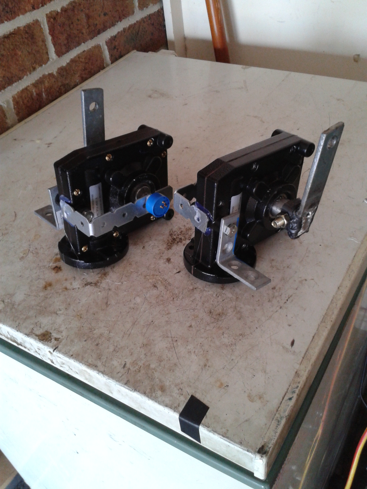

  9. bsft
    @Erwan960 http://www.motiondynamics.com.au/worm-drive-gearbox-to-suit-industrial-motors.html , they are metal internals, to change the shaft around, drill out rivets, pull aparts bash shaft out, turn around, bash in, bolt back together. Left and right hand gearboxes now

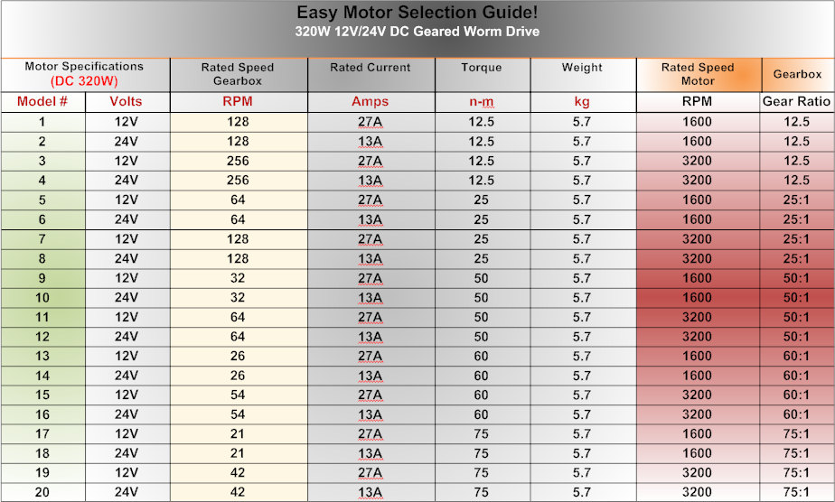

    What do you think about the model #7 (12V - 64 rpm - 50 Nm) and #11 (12V - 54rpm - 60 Nm) ?
    With the manipulation you propose to reverse the output shaft, it could be interesting, right?
    How did you manage to fix the link? You soldered directly on the shaft ?
    edit : OMG !
    2 item(s)$458.00
    Shipping$244.20
    Pity that the shipping costs are so high!
  11. bsft
    the 320 watt motors are too high wattage to use on the JRK. 250 watts is about the limit considering they get overdriven. I test a 320 watt motor, it spiked constantly over 40 amps, and JRK has 49 amp cut out.
    I dont otherwise know about the motor, where did you find that list?
    For fixing to the shaft, which was 20mm OD, I found a length on 25mm box steel, which happened to be about 21mm ID, (if you find pipe like this is would be good) I welded a bar on the top, then measured and cut the tube to a decent length, 20mm I think, drilled through the shaft and put a 8mm bolt through it. Then I tightened the !@%# out of the bolt. I may have to replace them with proper high tensile bolts, but will see if anything wiggles loose.
    I am fitting them tomorrow to this mates simulator, then hopefully we get a quick video done.

  15. bsft
    Yes the 200 watt motor would be better on a JRK. I have mine overdriven to 500 + watts to get good motion. Thats 41 amps.
    If you overdrive a 320 watt motor the same amount, it adds up to 800 watts - 66 amps. JRK will shut down.
    54 rpm is a tad slow, thats car wiper speed, but the torque is high so you have better "toss you around" power.
    Mind you, good motion can be gotten from 50 rpm with a good profile. Yo may not quite get snappy motion, but you will certainly get hard knocks.
    Up to you if want to go with that speed on motor, considering you are stepping down from a 25:1 box to a torque 50:1 box.
  16. Erwan960
    Erwan960 Active Member Gold Contributor
    Nov 4, 2013
    137
    3,832Coins
    +257 / 0 / -0
    First conclusion: 320 W motor but 200 W motor ;)
    Currently I use a 25:1 gearbox on a 1500 rpm/0.4 Nm motor : 60 RPM available and 10 Nm theoretical or maximum.
    Model 7 offers me 64 RPM and 30 Nm (50:1 gear ratio)
    Model 11 offers me 54 RPM and 36 Nm (60:1 gear ratio)
    According to me, one or the other should be fine, no ? But from what you say, 64 RPM / 30 Nm is better...
  17. bsft
    ok didnt know you used 25:1 box on 1500 rpm motor, sorry
    I use 3600 rpm motor on 25:1 box.
    So in that case you are still having 54-64 rpm ish at the shaft, just a heck of a lot more torque.
    6nm difference in torque at 10 rpm less. up to you.
    Yes 200 watt motor for sure
    you may get decent motion from 320 watt motor, but its up to you to test.
    We know what works, thats all.
