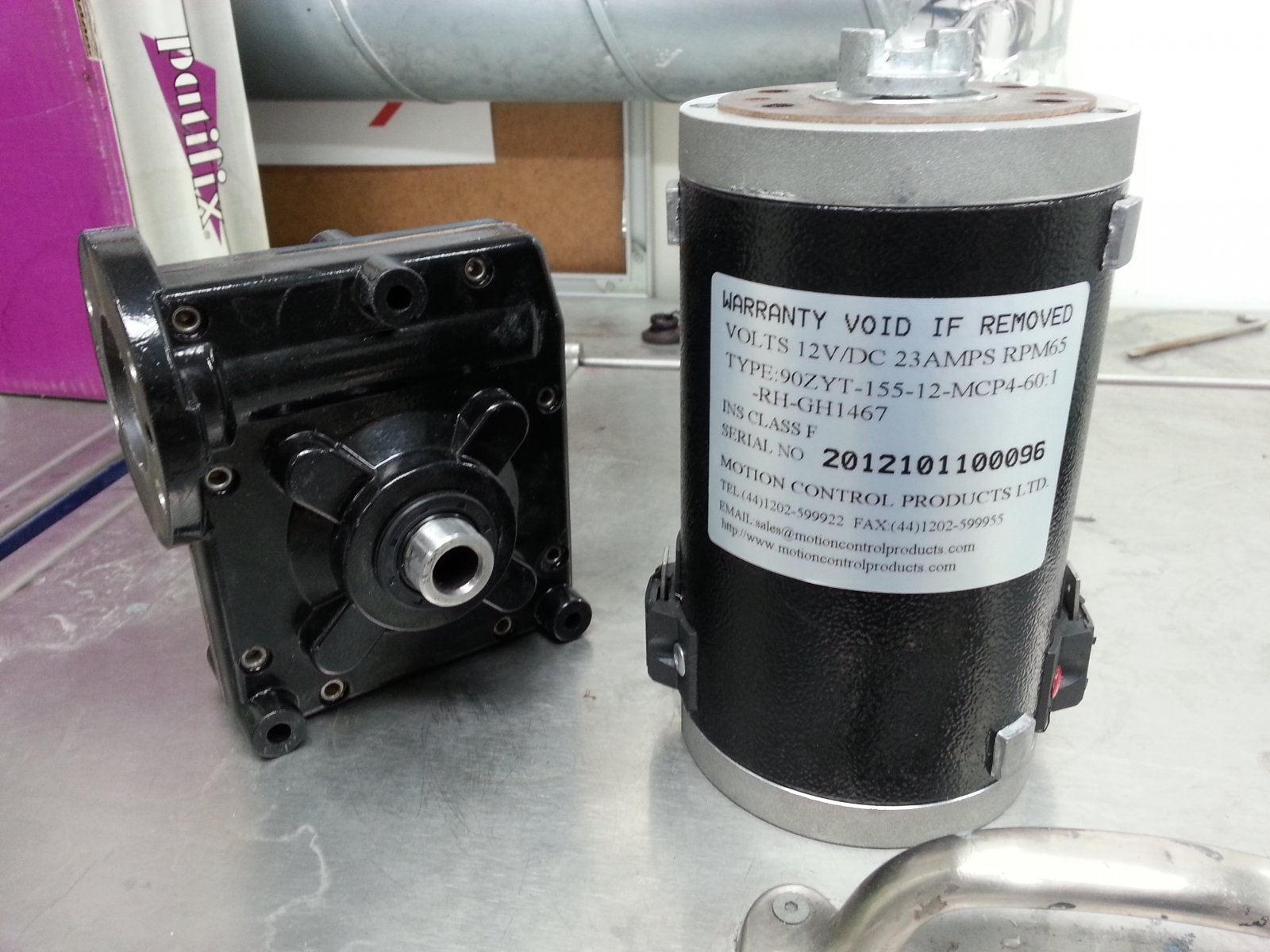

    I use motion control motors as in the pic. Some people here say that they are weak. I do not agree.
    Also these motors can move very easily when powered off. Not that it matters to me.
    Soon I will post my project. Haven't done that yet because first I want to make a good video.

  14. bsft
    My motors move with no power and again no problem

    The motors move when powered off... but not with the gearboxes ! It's not the case with mcp4 25:1...

    Strange... mine do
