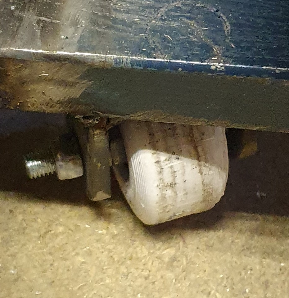

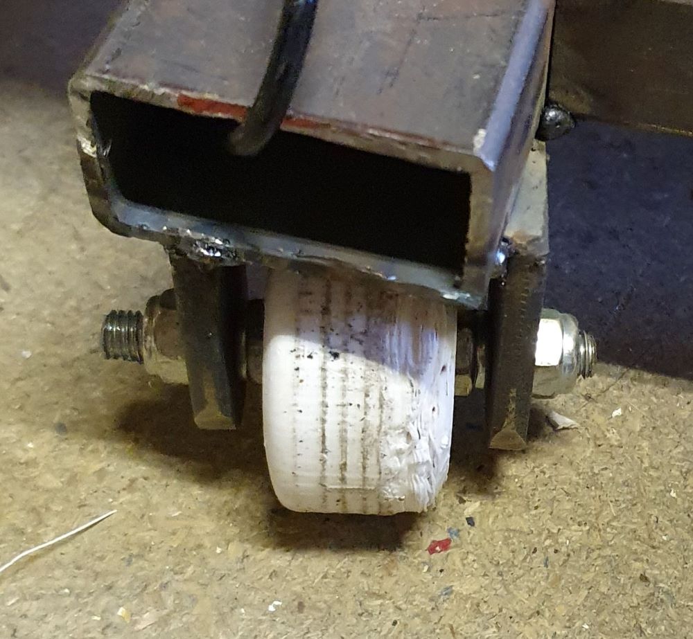

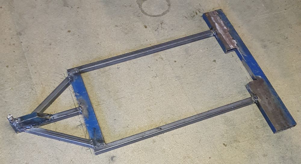

    So first off I made some wheels.....
    I should have taken some pictures when I made them but I didn't, so pffft. Anyways, I 3d printed them in petg. Not sure how that will fare but I made them the same size as standard skateboard wheels (they do have skateboard bearings in). I welded them to the bottom on an arc so the rig naturally rotates around a single point.
    I then started drawing on the floor :)
    It's a little hard to make out but the rotation point is on the far left. I put a nail in the floor and then traced out the wheels route with a pencil on a string.

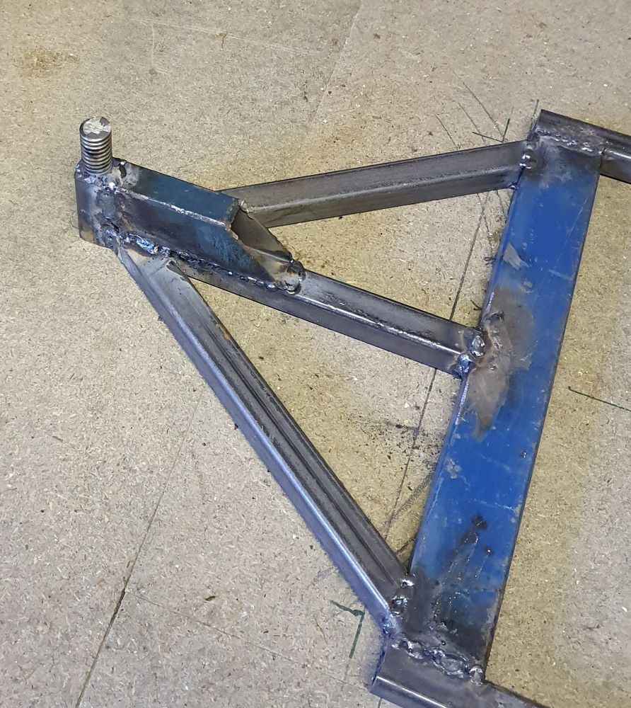

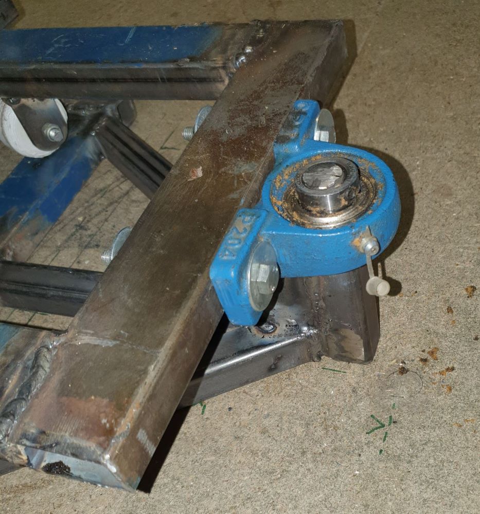

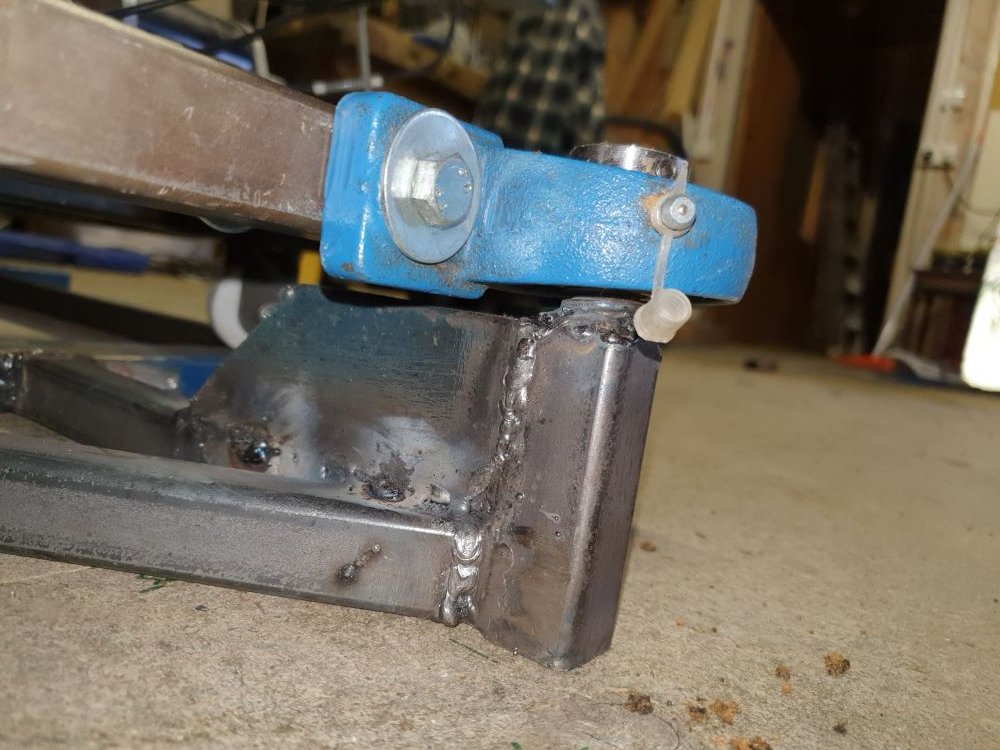

    Now I know where there needs to be a track, I put the the bottom frame together.
    Some may wonder why I used the lead screw as the pivot point. Simple answer.... I had it and matching pillow blocks.... (it also magically fitted snuggly inside my 25x25mm box section.)

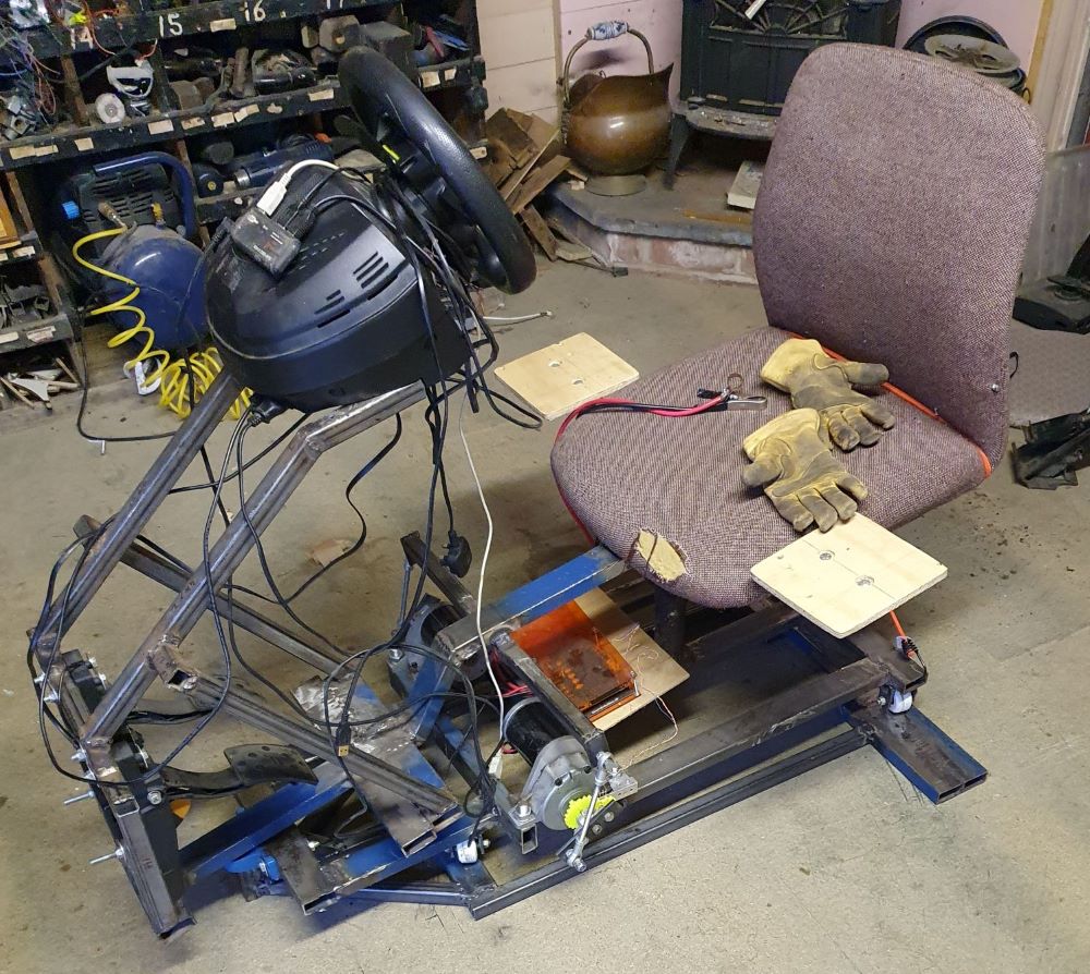

    Which I added to the existing rig under the peddles.
    Heres the rig on the platform.......
    Im planing on a swing of 150mm which Im hoping is enough, we shall see.

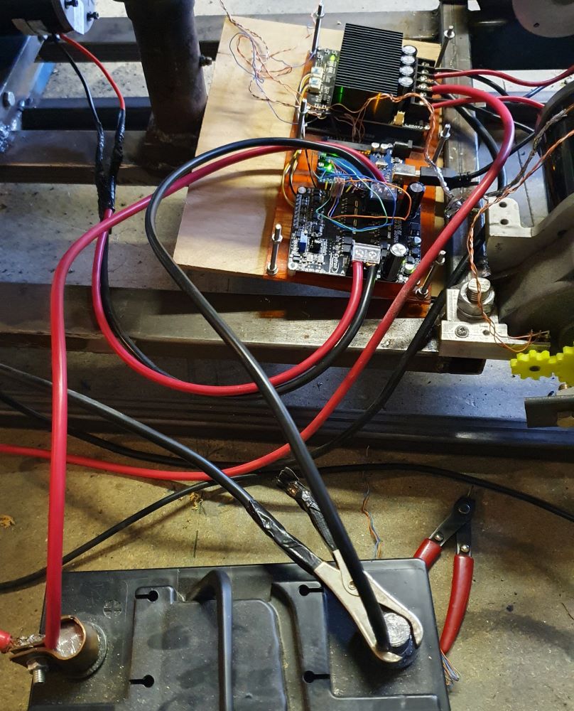

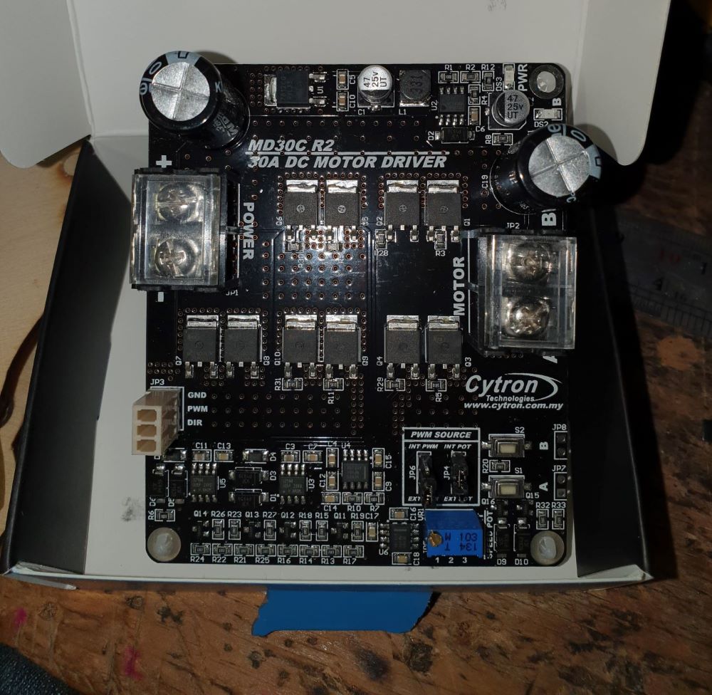

    Heres the the motor driver....
    Cytron all the way! Seemed only sensible as Im already using the dual channel board.

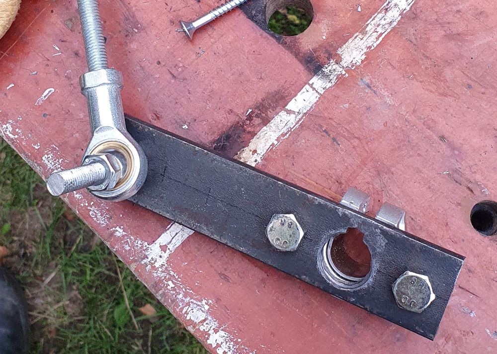

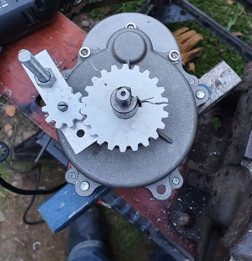

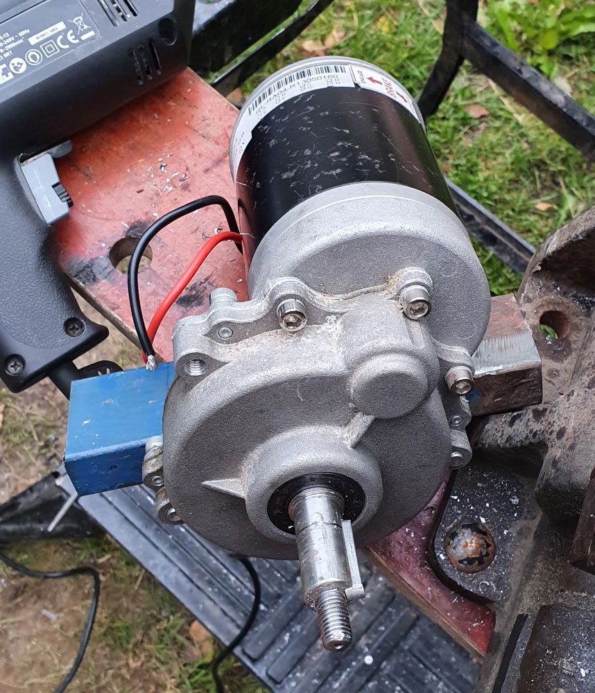

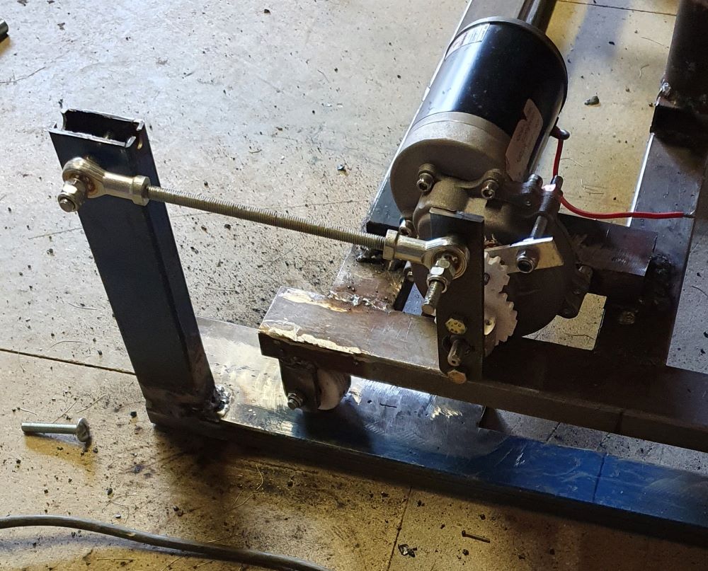

    Tuesday came and so did my new motor.....

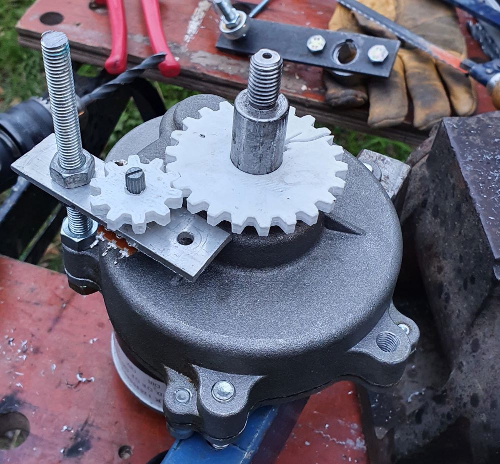

    Similar to the other 2 albeit that the motor itself is larger and the gearbox is smaller but with the same sort of reduction. So it's back to recreating what I'd made before....

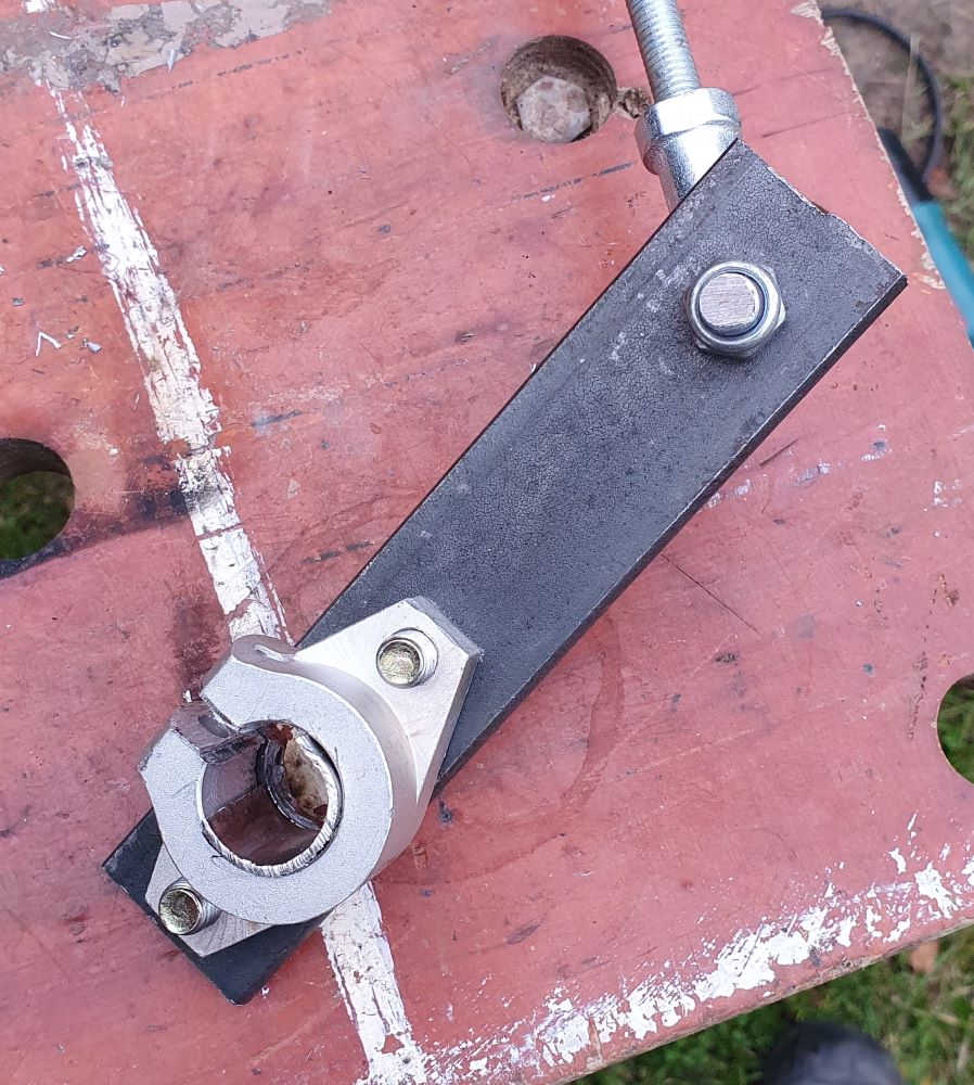

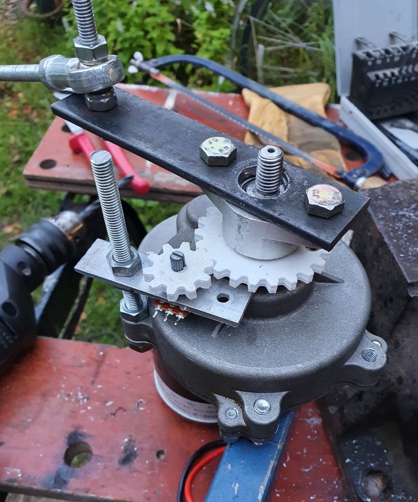

    Lever Arm.
    3D Printed gearing for the pot (this one I made a bit small and split when I put it on the shaft :s)
    Reprinted gear with the lever arm attached.
    Now to attach it to the machine.......
    And some sketchy witing for testing......
    I keep on getting wires that are too big for the terminals :D But I'll sort it out properly at some point.
    Everythings working well at this point so I'm happy :D Hopefully this wioll be enough until the urge to completely rebuild happens :)
