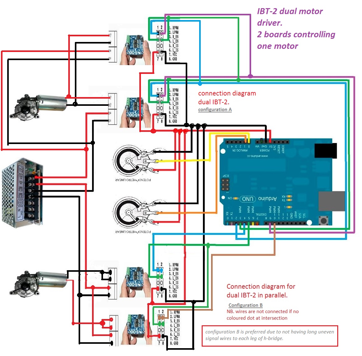

    Hi, wow, I read about 2 IBT2 connect per motor for the first time. Can you show directly how U connect them? I try to make linear actuator with IBT2 but for about 5 min it start to be very hot. I have idea to plant another radiator but I saw your thread so if U be so kind and show your solution? Another question, my prototype is on 120 volt small dc motor maybe this is the hot it's problem? Motor is not hot and working fine for the test but ibt for about 5 min r hot like hell

    Hey, nice construction you are building. Below I’ve included the schematic for connecting two IBT-2 drivers to a single motor. Connect them using configuration A, as I couldn’t get the motor to work with configuration B. I’m not entirely sure, but there might be an error in that schematic with configuration B. There are more info on the forum about the double driver to one motor connection if you want to find them.
    Heat transfer in the case of IBT-2 is a known issue. You can modify the design a bit and add an additional heatsink. You can also add a fan near the drivers, which will help dissipate heat. After the modifications, several IBT-2 units power three 300W motors for me. Without the modifications, the IBT-2 couldn’t handle two minutes of continuous motor operation.
    Since there are many problems with the stock IBT-2, it’s worth considering stronger motor drivers if you don’t have the time or willingness to modify them. The IBT-2 has current and thermal protections, but after several overheating events, shorts occur in the transistors, and it seems that the actual current capacity of these designs is significantly lower under continuous load. Good luck with your project.
