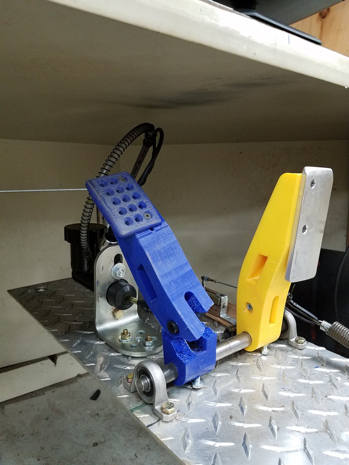

    So I went into turn 4 a little too hot!!!!!!

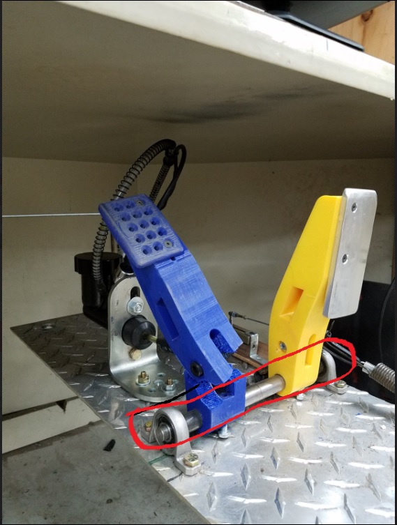

    Do you have it fixed the 2 pedals with 1 single bar? Wouldn't it be better to put 2 fasteners like the ones you have at each end of each pedal?

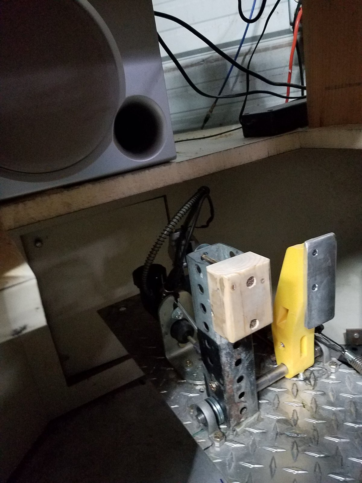

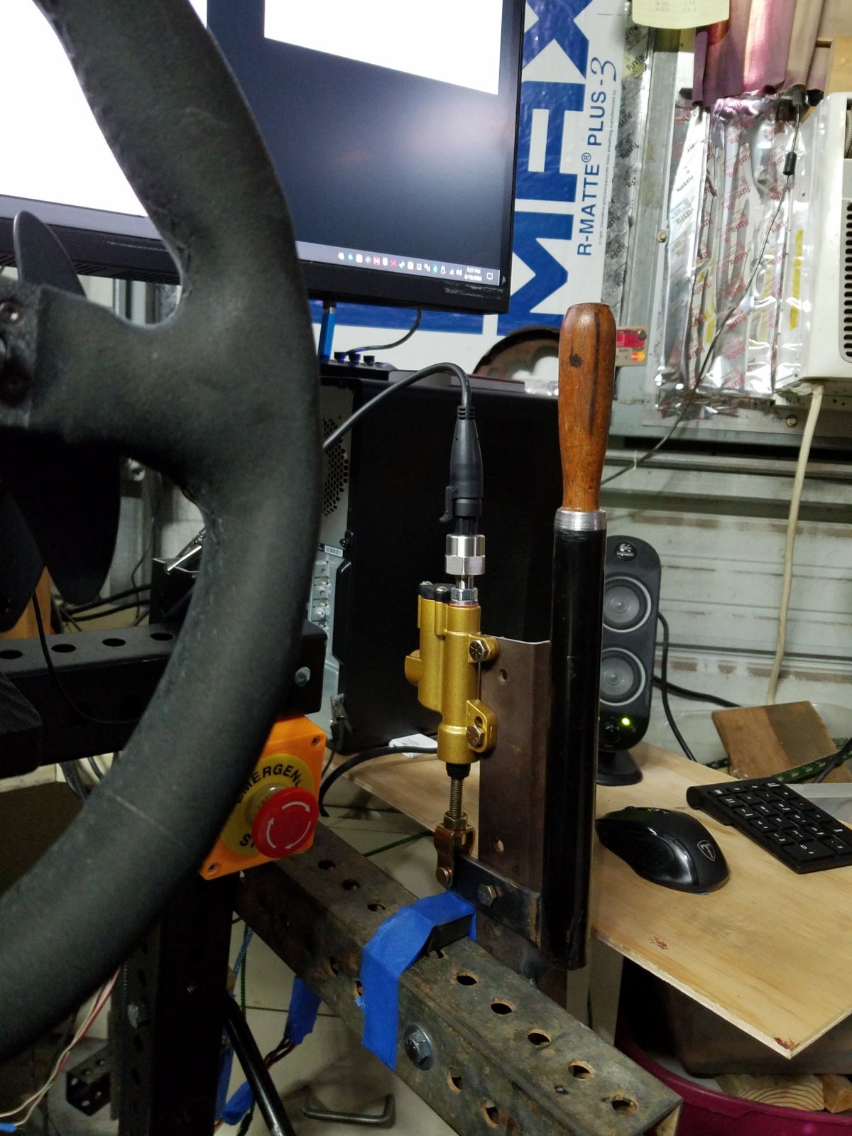

    Shaft doesn't flex a bit. Have spacers on the shaft to keep the pedals properly seperated. Should have used a different infill and pattern when printing the pedal. Oh well. Made a new one out of metal and also fabricated a handbrake for racing in DiRT 2.0

    Oh my god, I see a lot being done there !!!! I am making mine, soon I will upload photos of my pedals.

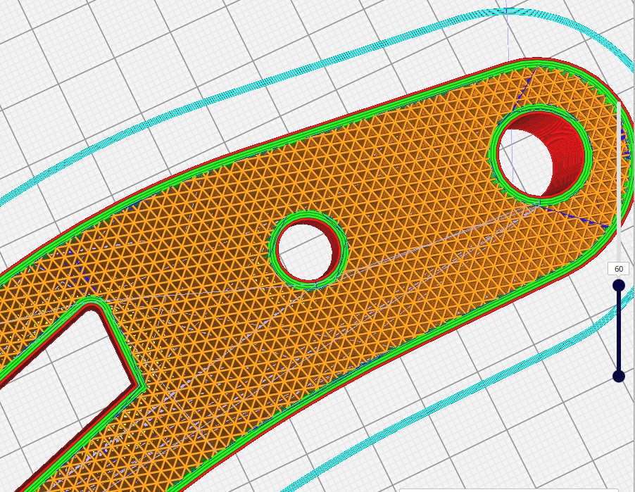

    Can you share the the infill % you used ?(and even add it under the picture) I never managed to break mine.. ^^

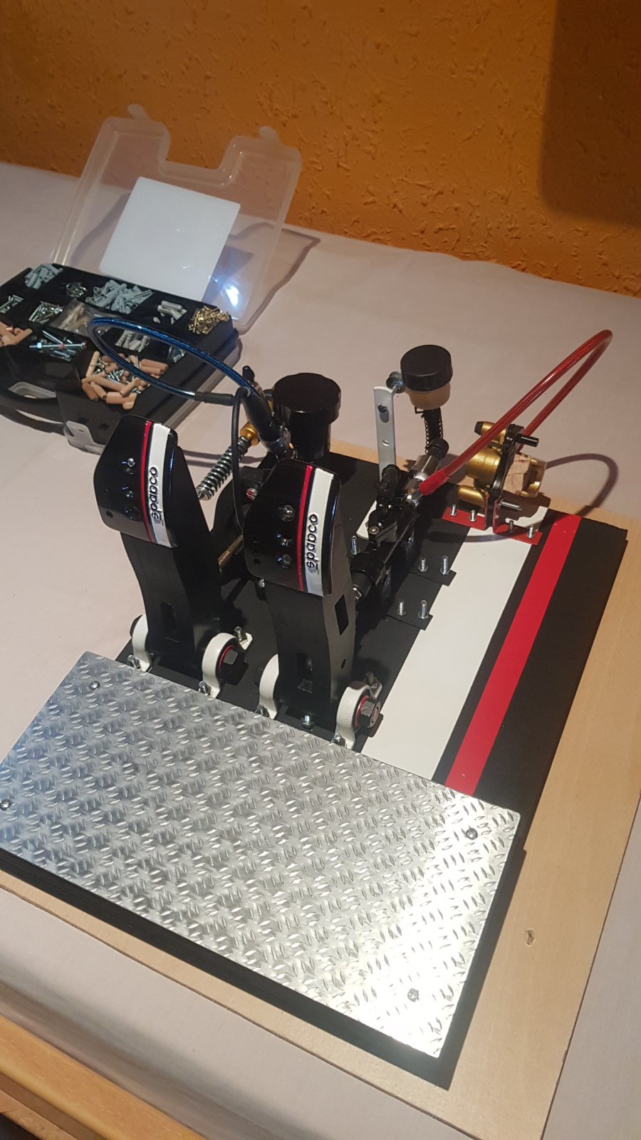

    Photos of how it looks

    I don't have the file any more but I am thinking about 75%. Here is a slice from the gcode.

    @Squarebob hm... I will try to brake my 80% infill brake lever when I will have more time.
    Which 3D printer do you use ?

    infill is probably not the answer to strength...

    I can't help much since I've never had a 3d printer and don't know its settings. But I just ordered an ender 3. The thing about the broken pedal I want to think that it is rather because of the single axis that fixes all the pedals.

    @RacingMat infill is the simplest answer, not the most efficient :)
    Infill patern or a print issue can be the cause of the breakage... By the way, the 5.3 lever is stronger around this area.

    Nuevo progress
  14. Lebois
    Dec 10, 2018
    353
    Math teacher
    2,566Coins
    +210 / 2 / -0
    Very nice looking !

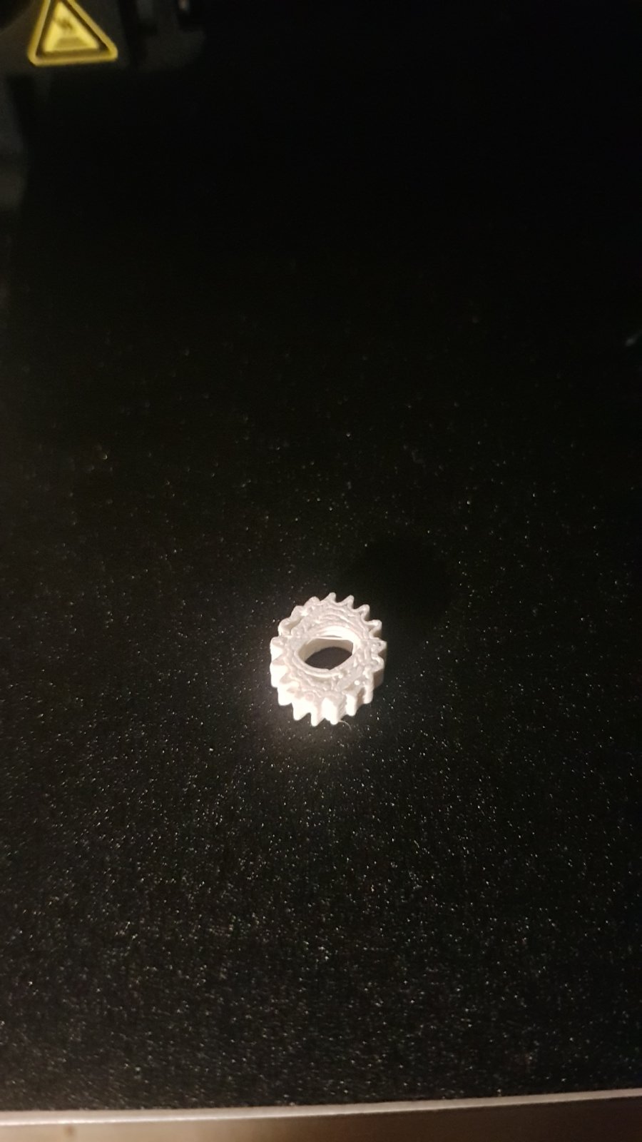

    I have printed a part in 3d on my ender 3 but it doesn't come out right. why?

    200 should be ok, 60 might be too much. Lower to bed to 55 or 50, if that does not work lower nozzle by 5.

    I have lowered the tray by 20 degrees and the tip by 5 degrees and now it has come out better.
