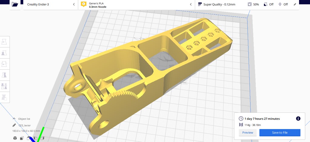

    Now the lever is in one part. It add strength and rigidity, and remove two screws.

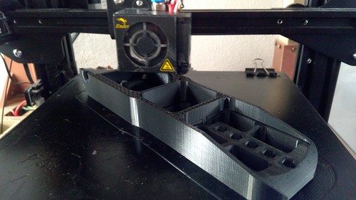

    You mean double master cylinders ? It's for front brake and rear brake.
    5.4 printing :

    Oooo that's looking good so far! Always love watching 3d print doing it's magic.
    Having a double master cylinder would that actually do anything beneficial? Seems like an excuse to increase the price.

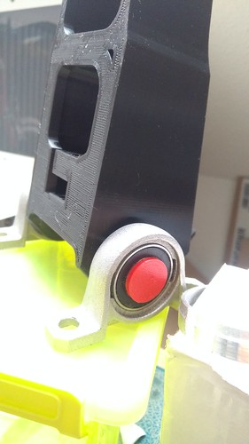

    No need for metal axis anymore ! :-D

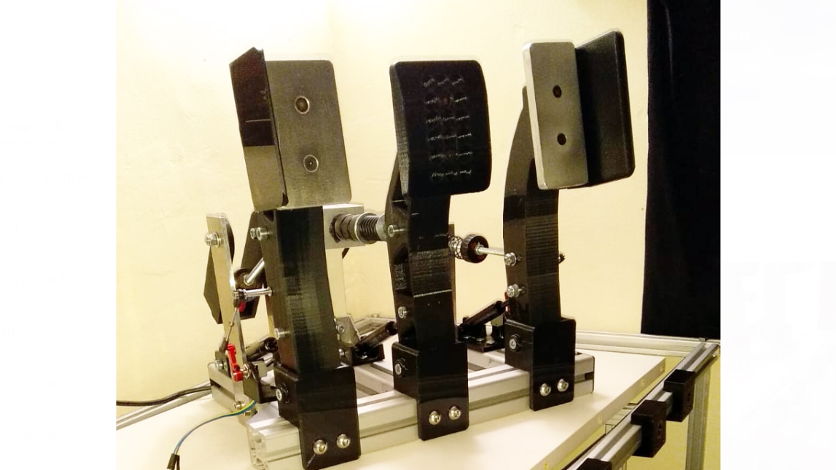

    Nice project, I also made a 3D printed pedal (in Petg Carbon fiber), I was going to market them, but the costs became too high and I decided not to do it, I really like yours, especially hydraulics, I wonder whether it is possible to adjust the pedal hardness in any way?

    Well for the moment no, you can only tune the preload.
    I could add other mounting point on the lever for the master cylinder axle so we can change the force moment. Maybe we could change the part that goes into the brake callipper too...

    There's a screw on the pedal which adjusts the position which will give it a longer or shorter stroke which will make it harder or softer. Just like a real car.
  20. Lebois
    Dec 10, 2018
    353
    Math teacher
    2,567Coins
    +210 / 3 / -0
    In fact, it just reduce the travel where there is no resistance. It doesn't change the soft or hard feeling... I should draw a graph to explain...
