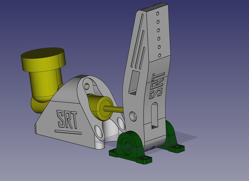

    New versions for both accelerator and brake pedal for this week-end ;-)

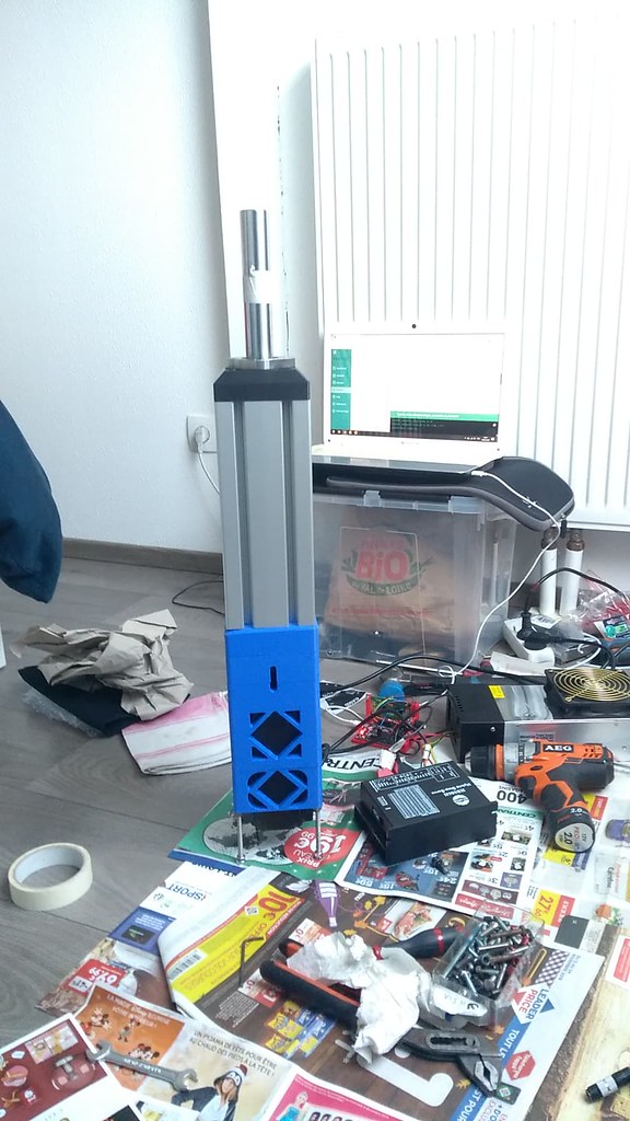

    Now, I will have more time to focus on my other projects :

    Two goals here :
    1) convert the Open sfx 100 actuators to stepper motors that are less expensive
    2) Invert the actuators so the moving part is lighter (the actuator doesn't bear the motors anymore), and the motion can be quickier (less risk of making the all rig take off)

    3D printed M8 rod end ?
  11. Lebois
    Dec 10, 2018
    352
    Math teacher
    2,559Coins
    +208 / 2 / -0
    Working on the design, what are your thoughts about it ? :)

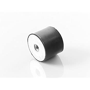

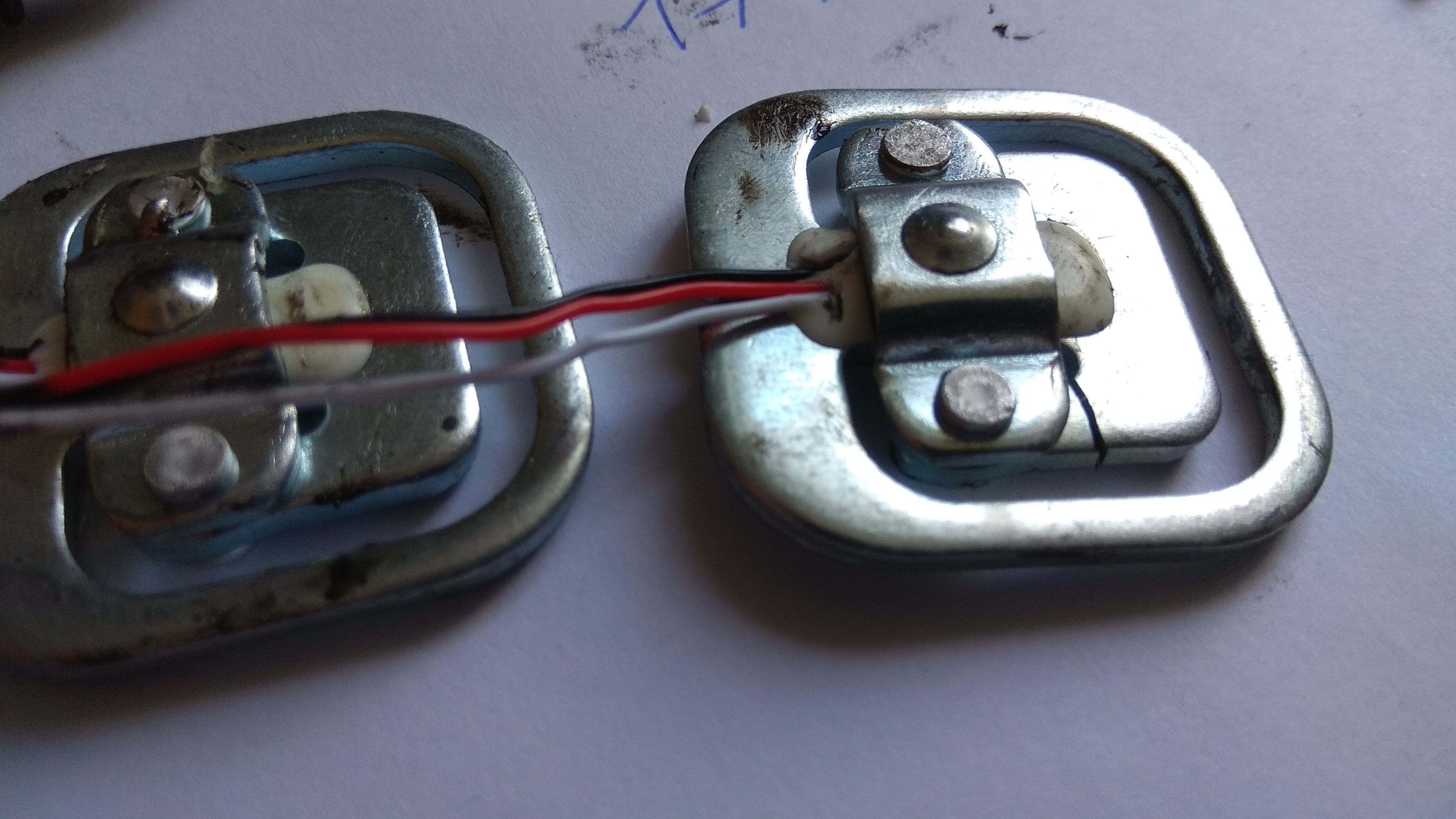

    Hello Lebois, thank you very much, for sharing your project. I`ve also done my own pedal set with hall sensors and load cells. Unfortunately after six months one of the 50kg load cells broke. Without reading your project I would have changed one of the load cells and hope the best for future, but now I have a new little project :D.
    To manage the brake hardness, I would mount a rubber buffer with thread between the brake calliper.
    Something like this
    Many variations of shore are available and had good experiene with load cell.
    My only apprehension is, that the Z-rotation of the lever could be too big and damage the main cylinder especially the gaskets. Maybe longholes in the lever or only a fixed main cylinder in X and Y cords could avoid that ?

    My fanatec pedal uses a 90KG load cell. In use, the weight I set reaches 60kg, so do you consider using a larger load cell more than 50kg and retain some redundancy to keep load cell safe?

    Hi @Balu ! the rubber buffer you show can't be used for that. You need a specific material that can't be compressed without changing as many time as you want... And that kind of parts is quite hard to find actually. You should look after fibroelast elastomer springs.
    Anyway, I already tried to put a spring in the brake calipper, and the brake pedal felt very sprongy :/

    Sorry but no vulcanized rubber is elastic until you reach the specification, after that it is viscoelatic . You have only to look into the Data sheet how much N are the maximum + your own safety factor and a construction which allow yout to distribute the pressure on the rubber. Furthermore you can put in variations of Shore.
    Here a link:
    https://www.kippwerk.de/de/de/Produ...ungselemente/Gummipuffer-Edelstahl-Typ-B.html
    Datenblatt means datasheet
    Forget about my worries it was to late today :D 2.30am in Germany.

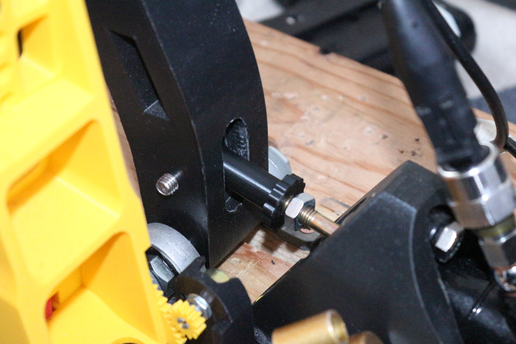

    Your cranksets are really well thought out. In karting to modify the attack on the brake pedal, you can modify the distance between the axis of rotation of the pedal and the axis of the master cylinder rod. Do you think that by adding adjustment holes at the level of your pedalboard there would be a real feeling according to the players?

    Yes you can change screw or unscrew the M8 end joint. It acts as a preload. There is many things that can be tuned on this pedal, and I believe that you could find exactly the same feeling as the one you have on your kart.
