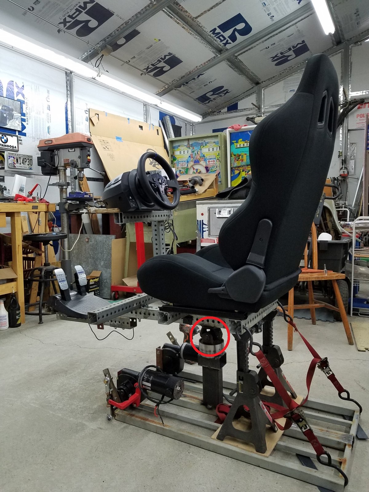

    I looked through the thread you pointed out, and user Squarebob built a completely different type of platform than the one you want to build.
    Squarebob built a typical 2DOF in which the entire weight rests on the joint (red circle in the photo I am attaching) and the motors only have to balance the partial weight when the platform tilts.
    In your case, the motors have to lift the entire weight. Take my word for it, you can't build a working platform with three 200W motors. Maybe if you use very short arms, 2-4 cm, it will work, but then the range of motion will be very small.

    That's fine with me if the range of motion is small, this is why I incorporated slots on my levers, so I am able to adjust base on what my motors are capable of. I am not an electrical engineer, so the electronics side I am struggling with. My goal is to get that side working, then upgrade where necessary. One thing I won't forfeit is I want 3DOF on this platform, Pitch/Roll/Heave, then I will add in the lower frame for traction loss.
