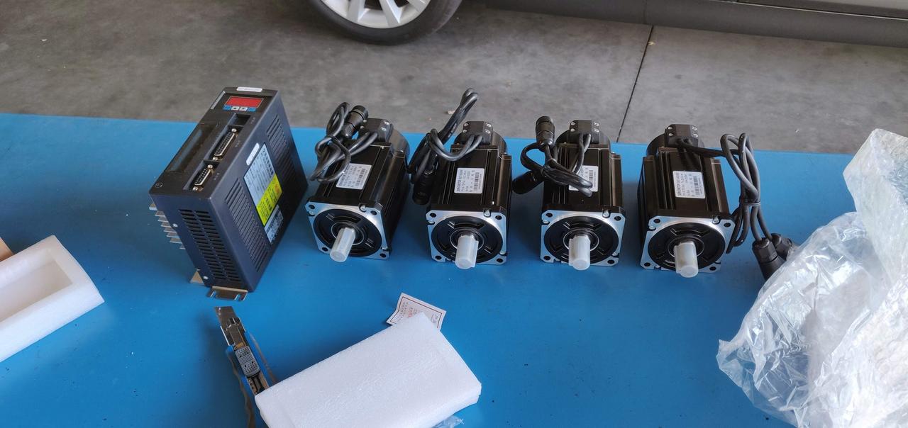

    @Nick Moxley, yes you can combine the power cables so you have just one plug. The beta tester in de 2 hour german video (Florentin) did the same.
    Got my 4 servos today
    I made a quick video on how to do the first test
