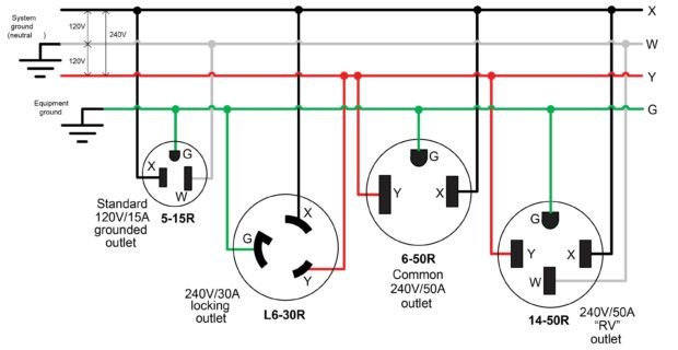

    You would need 4 220v lines correct?

    All I'm saying, is that these power converters from 110v to 220v they don't pass though the ground. Your 220v line should have 3 wires, L N and Ground, but in US its usually the 220v is 2phases combined = L1, L2 and N instead of ground.
    The N (neutral line) is not the same as ground, its not the local ground but the remote ground from the power factory that they use for reference!!! It may still have some different in impedance to the real local ground (Local distribution).
    Maybe this will help to understand it visually:

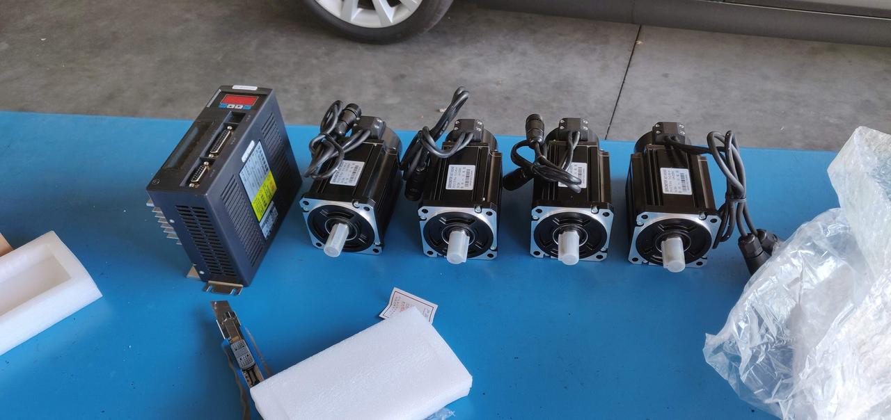

    Just a quick test of all 4 actuators running alongside simtools and simcommander
    I have not made any tweaks or adjustment yet, since i have really looked at all the available setting yet. The servos are now running at 1200rpm max, they can go up to 3000rpm max
    Initial thoughts: I can probably ditch simvibe and it's operation is super quiet

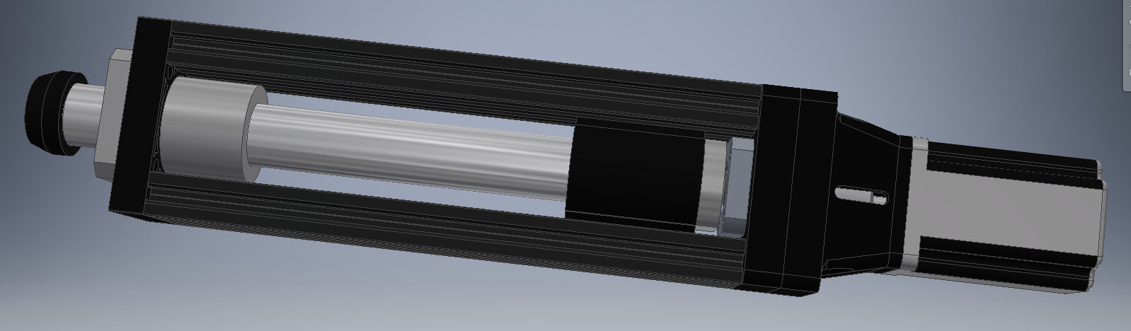

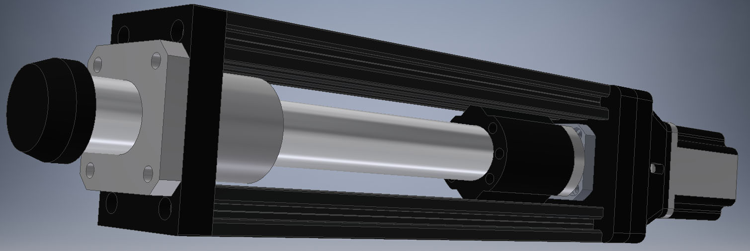

    I'm looking at taking this design and modifying it to produce a cheaper alternative for myself as 400 euro each is a bit out of my price bracket. New to linear actuators so unsure about a few things.
    Can I use a Nema23 3Nm stepper motor? Enough speed and torque paired with a 1605 ballscrew? (1610 ball screws seem had to come by and more expensive)
    100x100 Ali profile is quite hard to source, so I'm thinking of using 2060 down 2 sides instead.
    Everything else would remain as per the original shopping list.
    Total per actuator currently at £114.
    Any reasons why this isn't feasible? Are limit switches required?
    Thanks.
