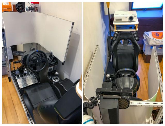

    Here’s a Showcase video of my project:
    Video of us having fun with it:
    Next steps: add the 4th DoF platform underneath the actual simulator, paintjob, and add my PSVR helmet.

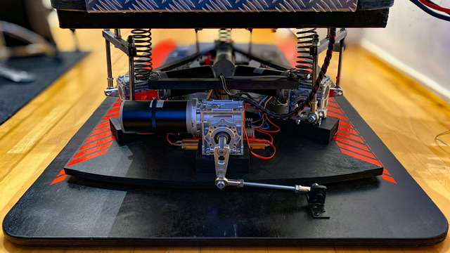

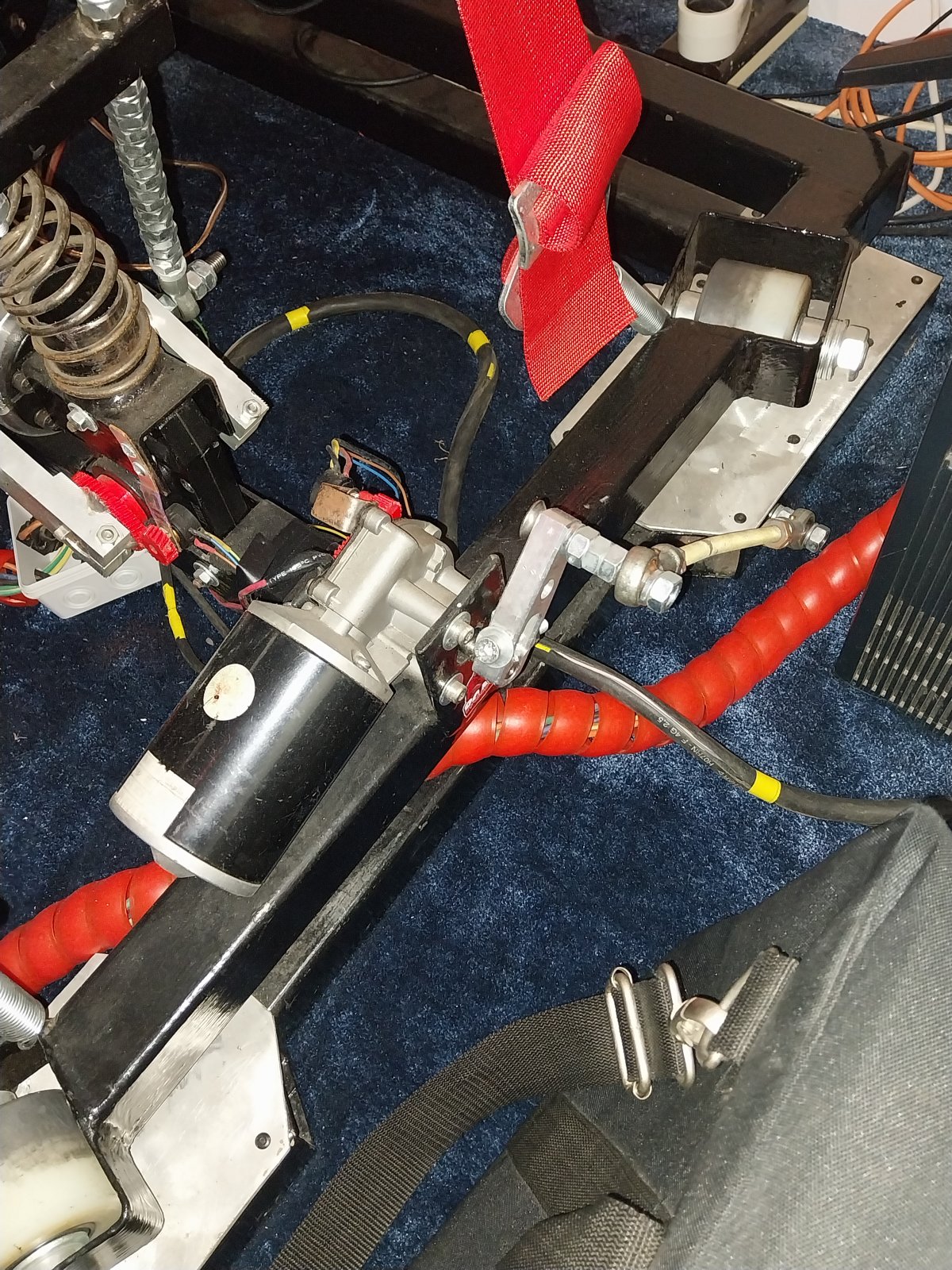

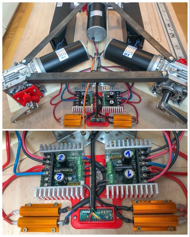

    It’s been some time since I posted here. I was on another project: 4WD electric Buggy ;).
    For the last 2 days, I’ve been working on the 4th DoF of my motion sim, for Yaw. I’m using ball bearings, and a pivot at the front. It moves very well by hand. Will connect 4th motor soon to test it, and add wheels on the top of the simulator base to maintain it well towards the black base:

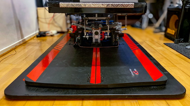

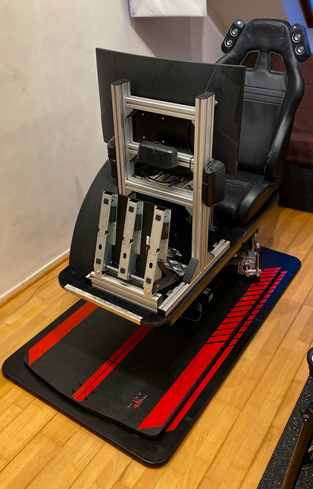

    Done some painting and decorating to give it a finished look:
    Here it is in action, with its 4th DoF:

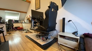

    Hi !
    VR is now installed ;).
    I use Pimax 8KX VR helmet. 4K resolution per eye, with eye tracking for DFR (Dynamic Foveated Rendering). Here I play Assetto Corsa.
    Next steps: better cable management at the rear, and wind turbine addon.

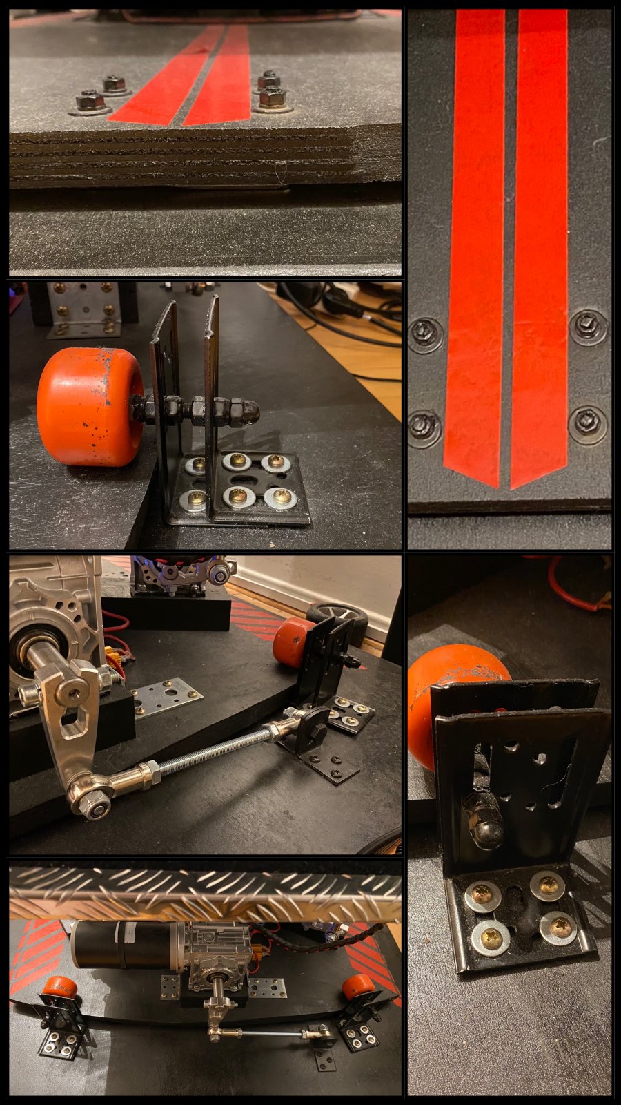

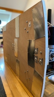

    @the2jakes , would you be able to show more pictures of your traction loss implementation? i would like to see how you created the pivot and connect all the ball bearing and wheels. if you can give a link to where you bought these parts then it will be helpful too. thank you.
  14. the2jakes
    the2jakes Member Gold Contributor
    Jul 19, 2009
    45
    131Coins
    +41 / 0 / -0
    DC motor, Arduino, 4DOF

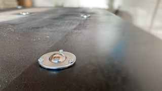

    Sure, here are a few pics.
    For the pivot I used a part similar to this one:
    https://www.manomano.fr/p/bs-rollen...ou-de-vistf-67x67mm-32366248?model_id=6215960
    You’ll have to dig holes in the 2 plank of wood to have the same distance between the 2 planks that you have with the ball bearings, to be horizontal.
    for the ball bearing I ordered them in a french company (sorry I forgotten its name…) but they are similar to these ones:
    Make sure they are steel balls and not nylon, and try to get some that can handle a good weight (CY-30b).
    Ball bearing need to be installed on the lowest plank of wood, and steel sheets on the top one, to limit dust problems.

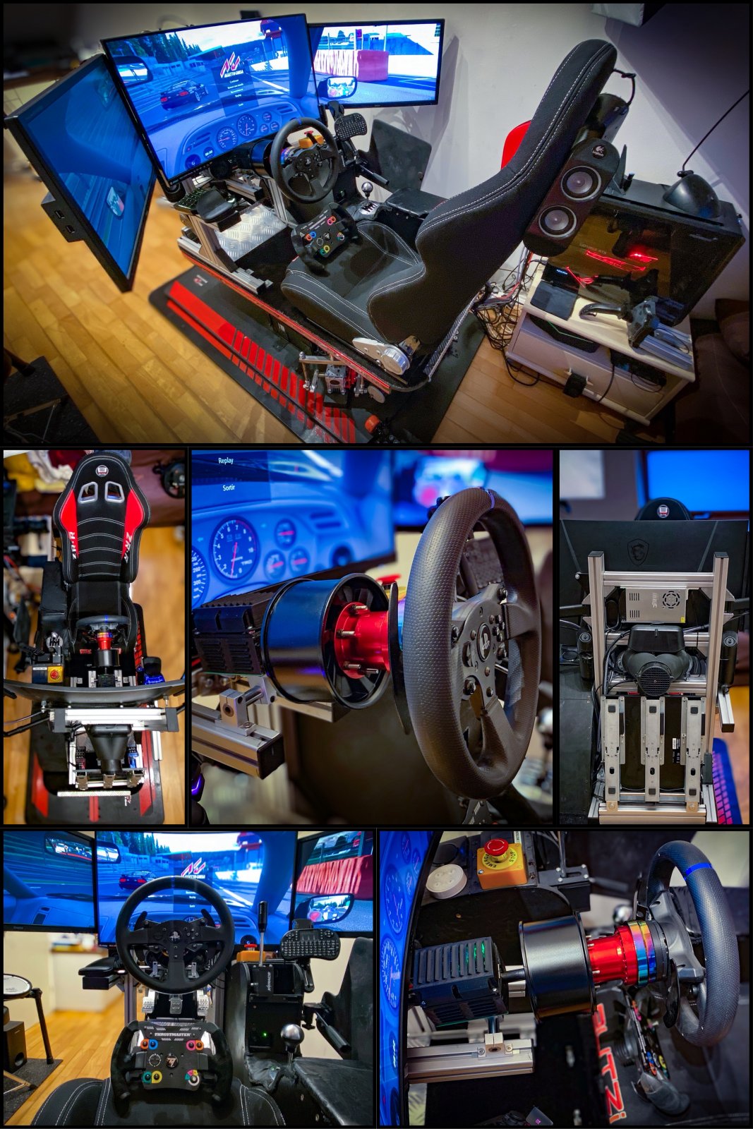

    Hi guys, a little update about the last evolution of our DIY Motion sim: we replaced our T300 RS wheel with a DIY FFBeast Direct Drive wheel. It’s a blast !
    If you’re curious, it starts here: https://ffbeast.github.io/#diy-force-feedback-wheel
    I chose to integrate all the cables inside the steering column, as I'm not a fan of cables dangling from the wheel . I also preferred to integrate the encoder into the steering column, inspired by this concept:
    https://www.printables.com/model/1326250-encoder-and-slip-ring-mount-for-ffbeast-wheel-v2?lang=fr
    I created a similar 3D model of this mount to accommodate the mini-DIN connector compatible with my Thrustmaster steering wheels, and my encoder and slipRing.
    I installed a quick-release, attached with a modified adapter like this one: https://petermakesthings.co.uk/product/thrustmaster-qr-adapter/
    so that the mini-DIN connectors of the steering wheels plug in when a wheel is installed on the steering column.
    The motor is a 5-wire Hummer type hoverboard motor (a bit more powerful than "classic" hoverboard motors, but anyway, with the power setting at 40%, I'm very happy with it).
    I know these motors well, having installed them in numerous vehicle projects: 4x4 buggy, off-road skateboard, drift kart, sled, etc. For those interested, check out my YouTube channel :
    My first impressions of using it are great!
    Now I need to look into the force feedback settings in the FFBeast configurator, as well as in the games themselves, because I'm not yet familiar with all of these settings.
