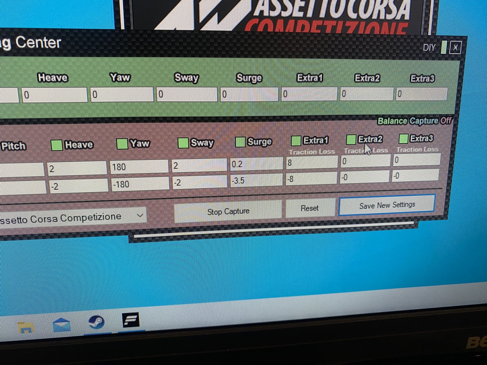

    Where can i find this option
    because the situation is it feels prettig good
    -100. 0. +100
    Full brake Full acceleration
    I want to try to only use -100 t0 0 and skip. 0 to +100. I hope this is a good explanation
    But i only can Find degree limitation but it is in both directions
    And offcourse overall intensity and axes limitation etc.

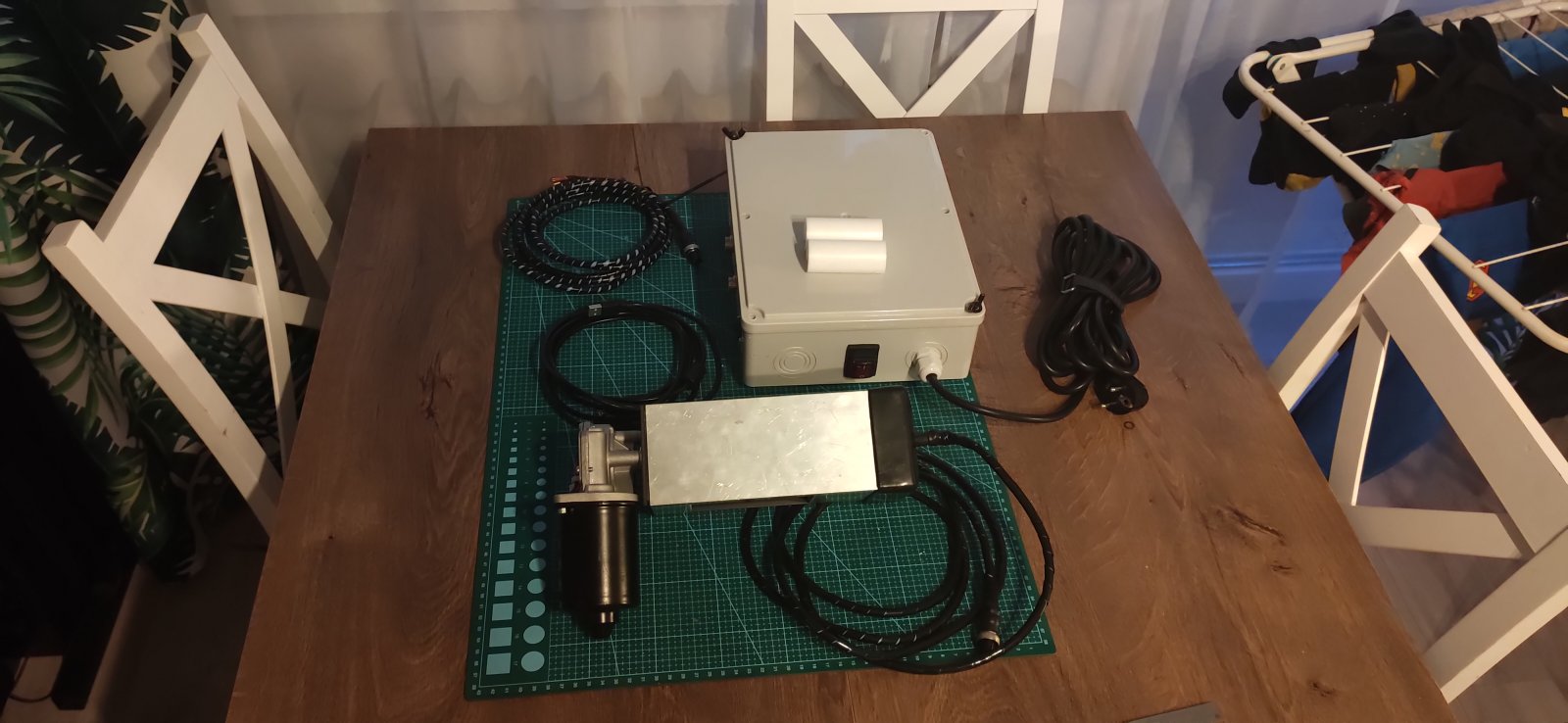

    Hi. How is your tensioner doing? Do U Have some heat problem with wiper motor?

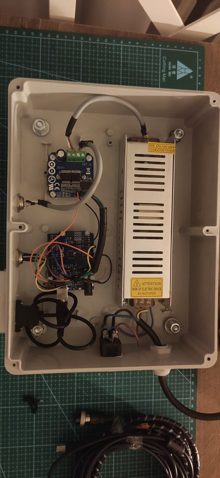

    DC motor, Arduino
    It is working oké but it stalls sometimes then i need to restart the Arduino.

  4. Krzysztof Dej
    Krzysztof Dej Active Member
    Jun 3, 2020
    315
    Poland
    1,100Coins
    +74 / 0 / -0
    From my experience :) check modified ground, try different usb port and try different electric socket if u have lots of other plugs in one. Take care
  5. psmooky2
    psmooky2 Member Gold Contributor
    Nov 3, 2022
    44
    270Coins
    +22 / 0 / -0
    DC motor, Arduino
    I tried a usb 2.0 instead of 3.0 last night i had no issues and it worked fine.
    thnx for the idea

    looks great !!! i like the 1 axis thing more then the 2 axis belt tensioner.. in my opinion a 2 axis makes no sense, because in real life the belt doesnt do it on 1 side only !!!!!
    i think about to do it like you in addition to my 6dof rig. bu i wanna fnish my build first and look how it feels without the tensioner.

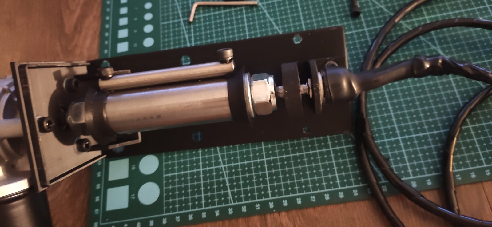

    The belttensioner is really Nice in terms of immersion.
    I started redesign it today i Will post pictures en info About it to do:
    fixing the pole to the seatslider so it moves Along with the seat.
    New motormount, shaft, Bearkats en positioning of the pot meter. (Final design maybe with covering etc now the shaft and the potmeter are not 100% alligned.
    redesign electrical circuit (final design with correct wire coloring etc)
    Fine tuning the settings of the motion.
    and i need to figure out a way when i accelerate the belt doesnt loose an only thightens on braking.
    and then the next step wil be planning for more Motion with 2 back mounted 24v dc motors dont now of it Will be only Seat moving or full frame still doing research i think in perspective of immersion it Will be Seat moving (i only do racing) so i can feel pressure on hands/steering wheel.

  16. Krzysztof Dej
    Jun 3, 2020
    315
    Poland
    1,100Coins
    +74 / 0 / -0
    What version of simtools u use? U must set max min values. I don't remember but its call tuning center :) on simtools 2.x and simply max min on sim tools 3 beta
  17. psmooky2
    Nov 3, 2022
    44
    270Coins
    +22 / 0 / -0
    DC motor, Arduino
    i found it in tuning center.
    I wanted to try it last night but my setup stopped working. It gives a bleep and stops so i Will try today with another arduino is ik post pictures wen i got it working.
  18. psmooky2
    Nov 3, 2022
    44
    270Coins
    +22 / 0 / -0
    DC motor, Arduino
    found it.
    run the tuning center and Capture min and Max then manually turn down the Max to 0 and let min on -3,5 Those are my setting now see picture om the picture Its 0.2 but Turned it down to 0.
    then save new settings (you first need to capture settings from the game before u are able to adjust manually)
  19. sci666
    sci666 Active Member Gold Contributor
    Mar 18, 2021
    200
    1,210Coins
    +72 / 0 / -0
    great !!!! and so you have surge 2 times ??? one regular for the simrig motion and an additional for the tensioner ?
  20. psmooky2
    Nov 3, 2022
    44
    270Coins
    +22 / 0 / -0
    DC motor, Arduino
    No only one time
    only have the tensioner now i im planning on building Motion but not started yet.
