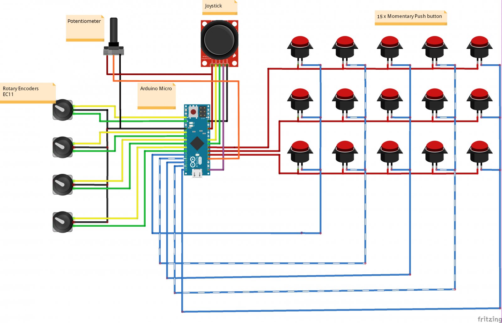

    Hello everyone. First of all thank a fellow forum member ((JonBakhol)). For all the help you have given me during my project. Thanks to him, I have learned a little more about how the Arduino world works.
    But "Jon" is also human and although we have done many tests, I still have the problem.
    I have a 32 button keypad. Here I leave the drawing.
    https://i.imgur.com/NWP6FwY.png
    And I have loaded on my pro micro board ((leonardo)). This sketch

    The buttons all work. Windows recognizes the board as a gaming device. Everything is correct, but the buttons do not work well. There are buttons that activate, its corresponding button number, but there are others that activate 2 buttons, other buttons activate 3 buttons. I have reviewed everything and it seems to be fine, the cables correspond to the drawing. There are no cables that are touching each other and make a false connection.
    That is why I ask for help, to see if someone else can help me. Greetings to all and thanks.

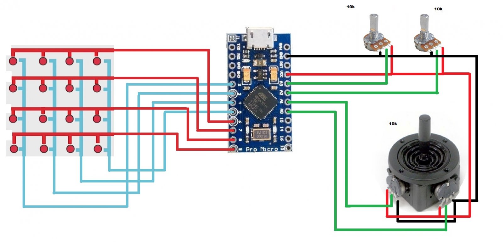

    sorry ... it is possible to insert 2 potentiometers in the project, thanks for the reply
  9. Angelo Spano
    Angelo Spano New Member
    Jan 9, 2021
    3Coins
    I would like to ask if there is anyone who is able to modify the code by adding another potentiometer, unfortunately I am new to arduino ... I have tried but I have not succeeded. thanks to those who want to help me.

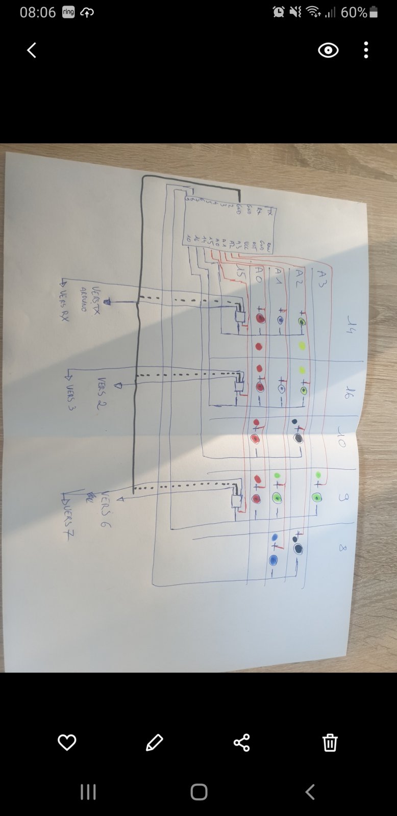

    Hi guys, here is the drawing of my button box, I wanted to know if the wiring is good and which library and other I must install on the arduino so that it works with my diagram. thank you
  14. tina540
    tina540 New Member
    Apr 6, 2022
    14
    - 44Coins
    +3 / 1 / -0
    I don't know if my photo is uploaded

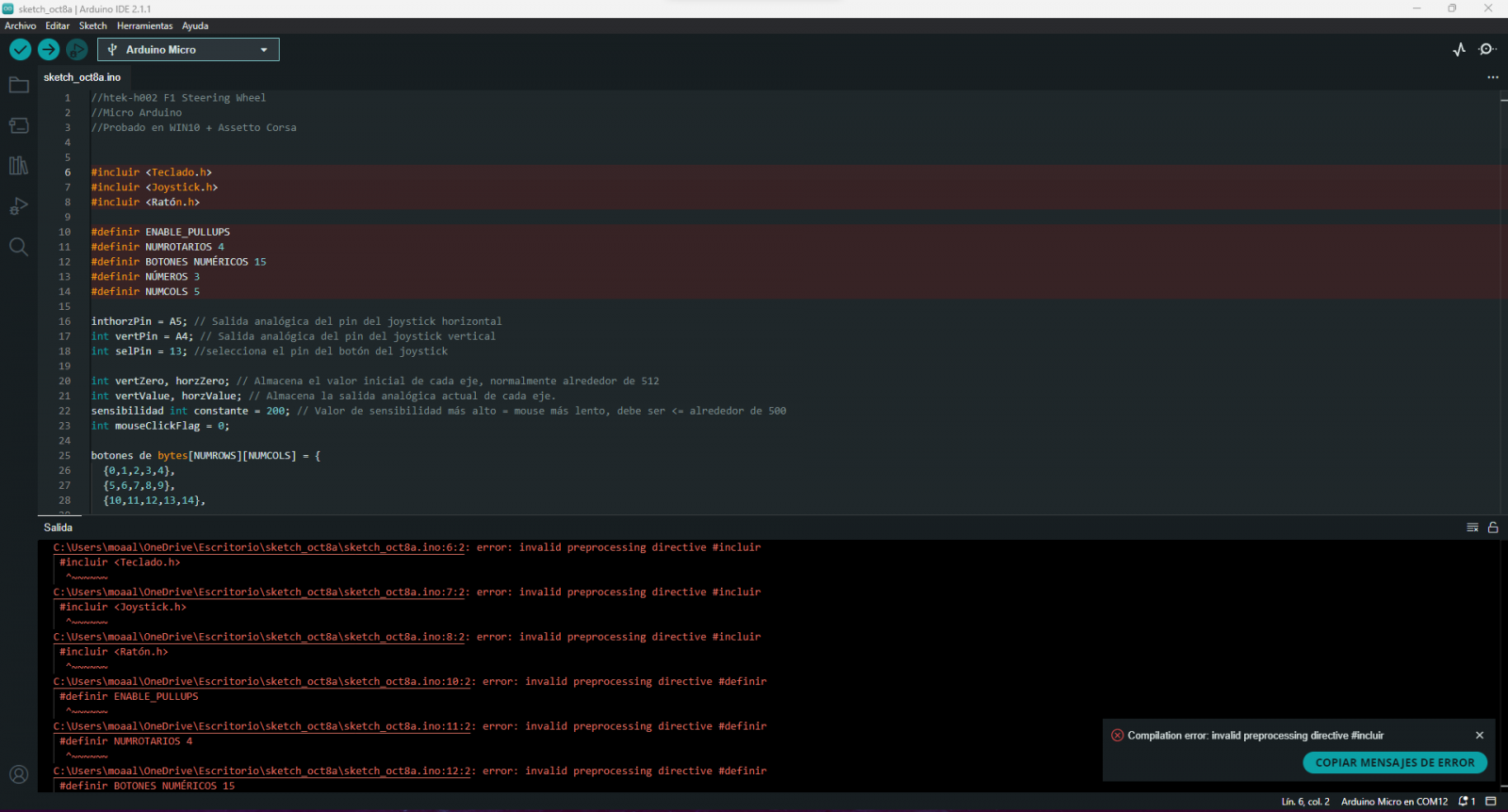

    Could someone give me a hand... I want to load this code on an Arduino micro and it gives me this error
  16. noorbeast
    22,208
    154,711Coins
    +11,211 / 57 / -2
    Try using #include instead.

    Is that code in Spanish? have you translated it? Those orders and libraries seem to be translated from English to Spanish.
  18. moaale
    moaale IAN MRTIN
    Jun 29, 2011
    170
    NN
    ARGENTINA
    96Coins
    +41 / 0 / -0
    2DOF, DC motor, SimforceGT
    They are the ones I copied from page 10 that the creator put.. I don't understand why it gives me this error

    Could you give me a hand... because I get this error like the word joystick has something wrong... I want to load the code into my arduino just as you put it in voice Captura de pantalla 2023-10-28 214605.png
  20. noorbeast
    22,208
    154,711Coins
    +11,211 / 57 / -2
    The code on page 10 is in English, the code you posted is not.
