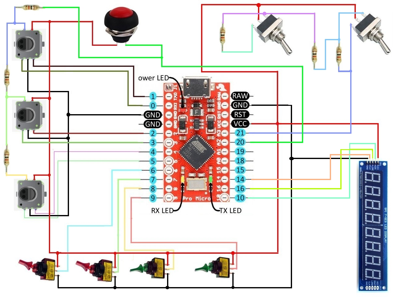

    Good morning mate!
    you could change the codgo the button v1 so I can use the folowing buttons?
    3 potentiometers used as brake, accelerator, clutch.
    2 encouder
    and buttons PUSCH
    and some keys of / on
    I wanted to let my independent pedal my steering wheel!
    It is how to do this?
    you help me?
    I do not understand the programecao but know you and master it thanks!

    Hi @Claudemir ,
    yes, its possible, but I currently dont have enough free time to build it and spare parts to test it. I'm currently pretty busy with my pcu-6d project, but next project probably will be pedal controller and its seems its what you want ;)

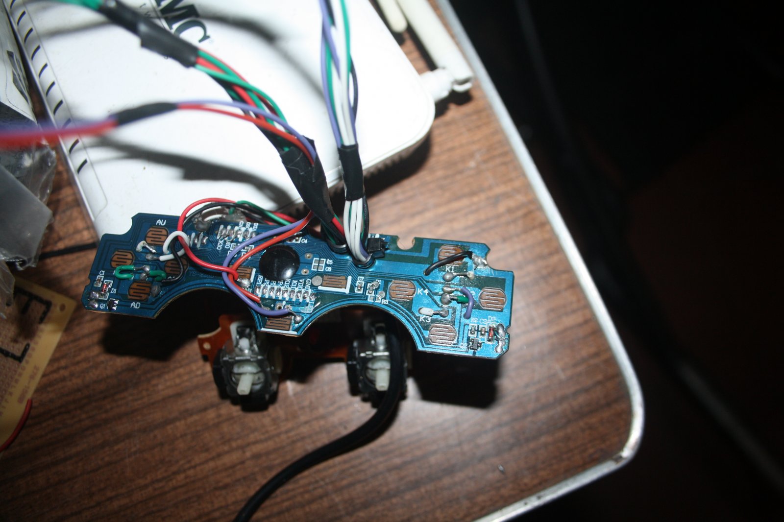

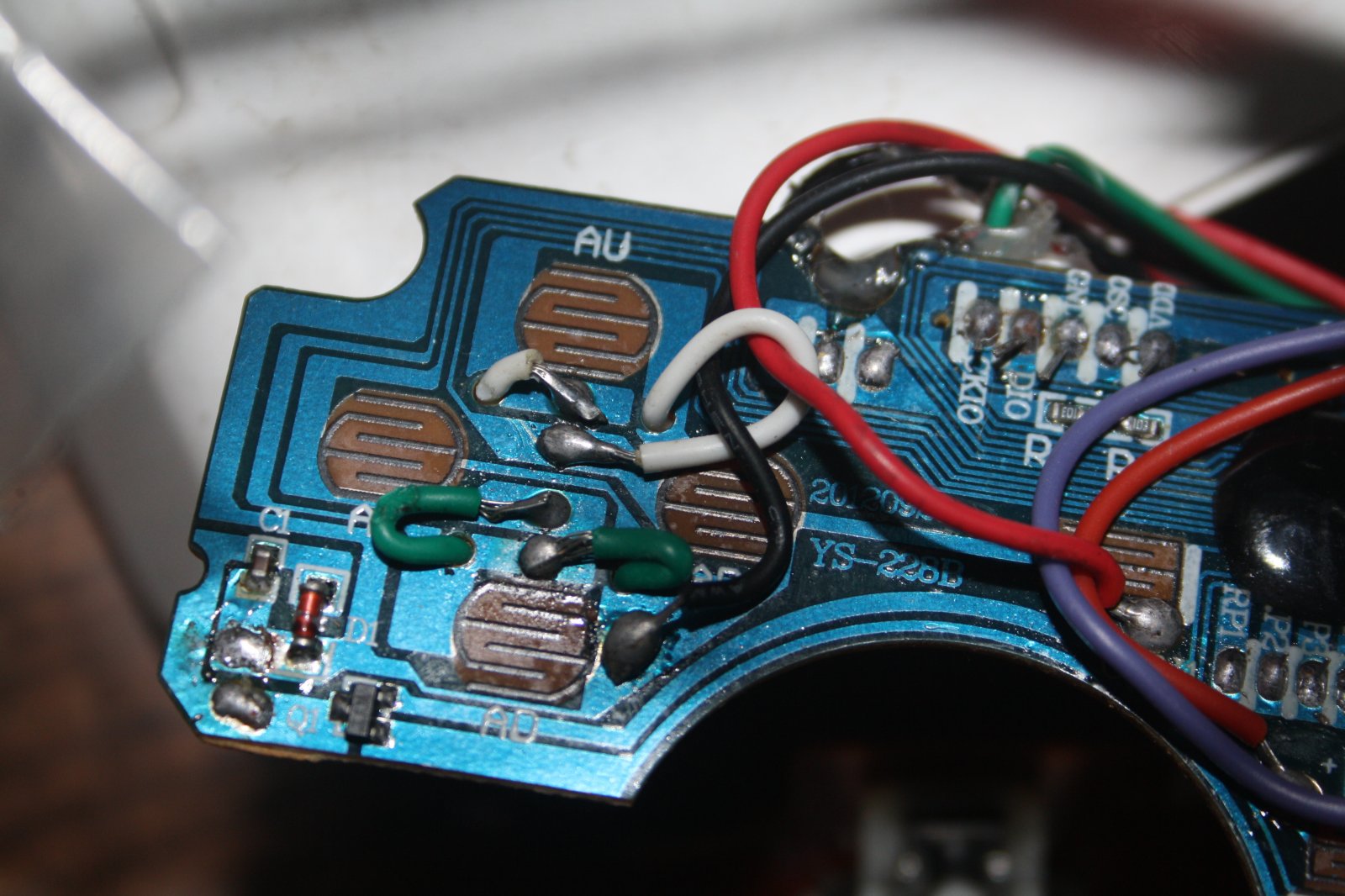

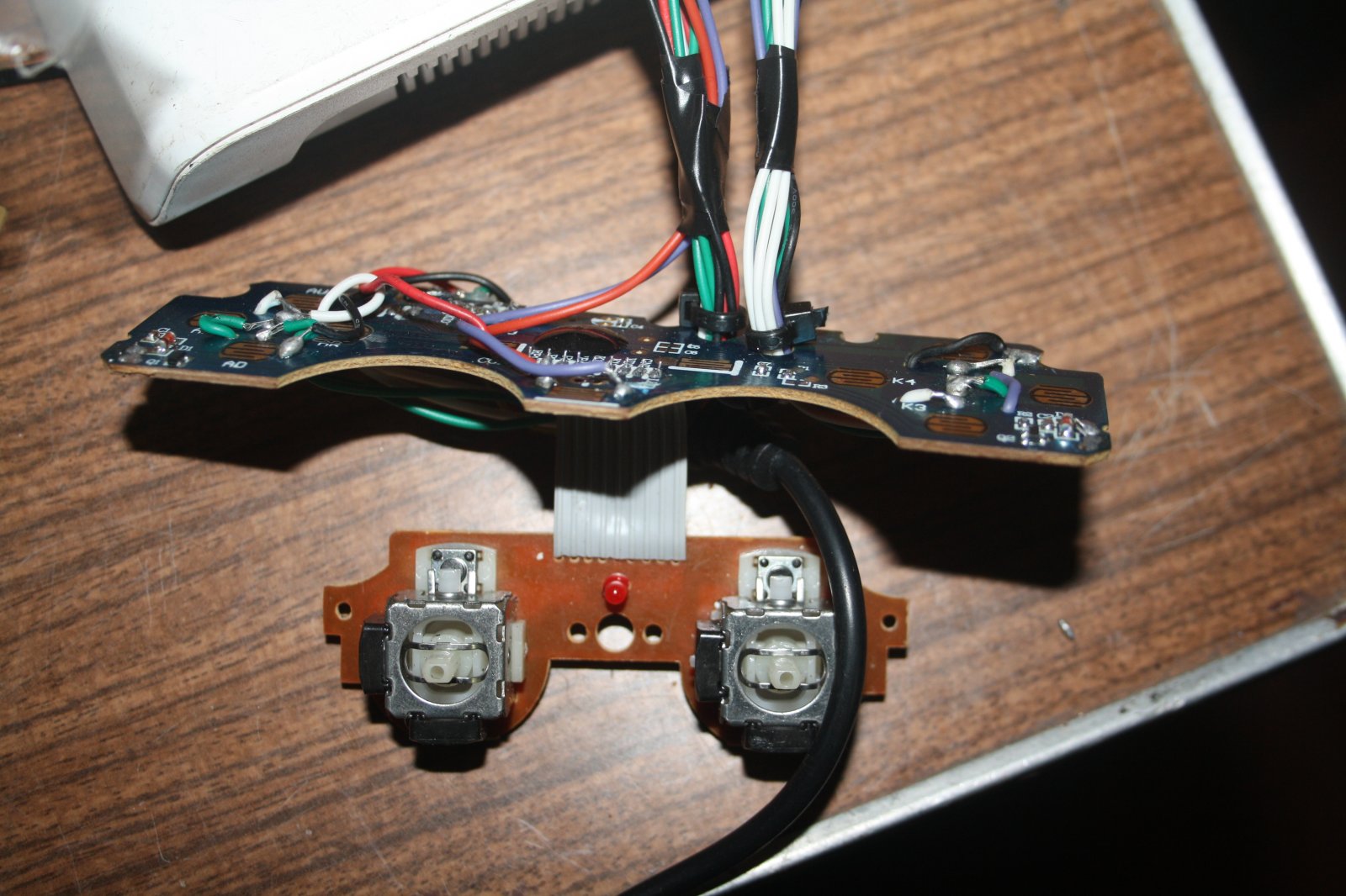

  6. mariana fino
    mariana fino

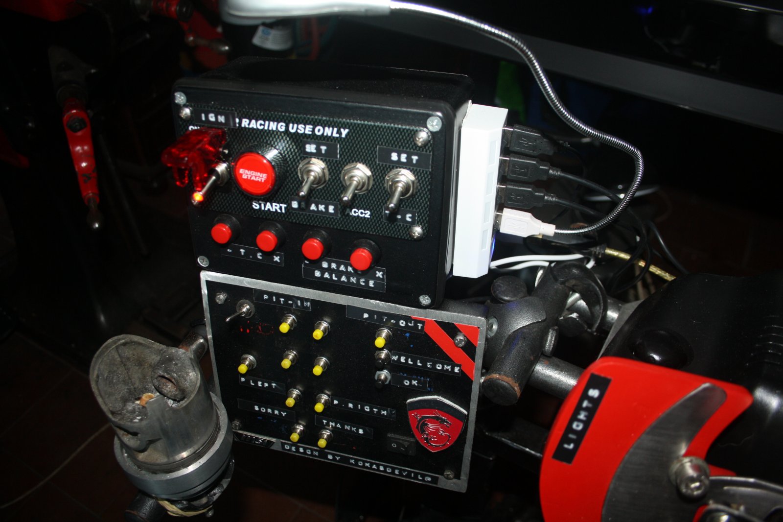

    Hello ,i just buy a usb controller ,aply on a box them weld new buttons and pots ,chep solucion and easy! for iracing i have two button box made from usb controllers!
  7. mariana fino
    mariana fino
    Hi here is my button box ,i am doing another one were i conect 4 pots to the joystic on the controller 4 axis 4 pots !hope you enjoy,no code need!kkkkk!:thumbs
    • Dislike Dislike x 1

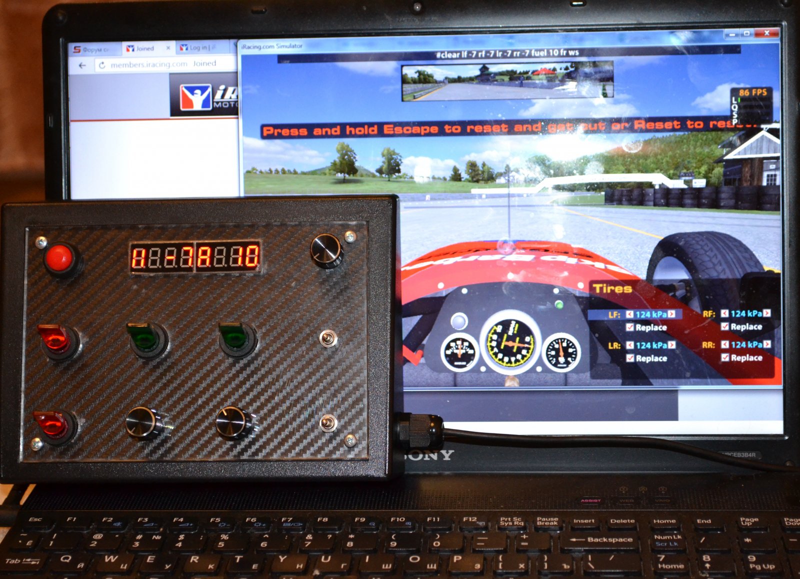

    Hi, thanks for sharing the project. A question could be added to the 8-position rotary instead of 4 ?, which should be added to the code ?. thanks
  12. TOPMO3
    TOPMO3 Active Member
    May 12, 2015
    133
    Russia
    894Coins
    +201 / 0 / -0
    Hi @Borja ,
    I'm not understand clearly what you mean. I'm using 4 (pcs) rotary encoders, not 4-way rotary switch.
    Do you want using rotary switches instead of encoders? Can you please post link to specs of rotary you would like to use?
    When I developed the buttonbox, I found its not very useful to implement support of rotary switches, because most of operations can be make using encoders.
    For example, imagine you made Brake Balance regulator using 8 - position rotary switch, i.e. very left position BB=1, then BB=2, etc, and most right position BB=8.
    Everything works, you are able to change BB while driving and all are fine. Until a moment when you forced to change BB by game ui control, or load qualy setup with different BB setting, or decided to drive a car with 12 (for example) BB regulator positions, etc etc. Since that moment yours BB regulator is not synced with in-game BB-position, so before jump to car you need to always check in-game setting, then correct yours BB control and so on. Briefly, rotary switch is not so flexible and problemless.
    Compare it with rotary encoder, its simple and dumb: CW rotation - increment setting, CCW rotation - decrement setting, not matter how many settings of BB a car has, nor what previous BB setting was, so I prefer to use encoders

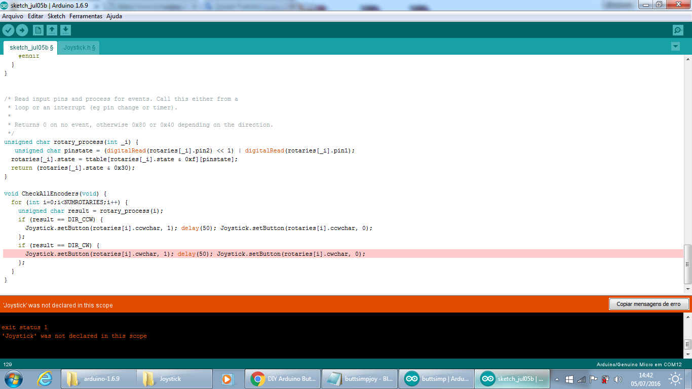

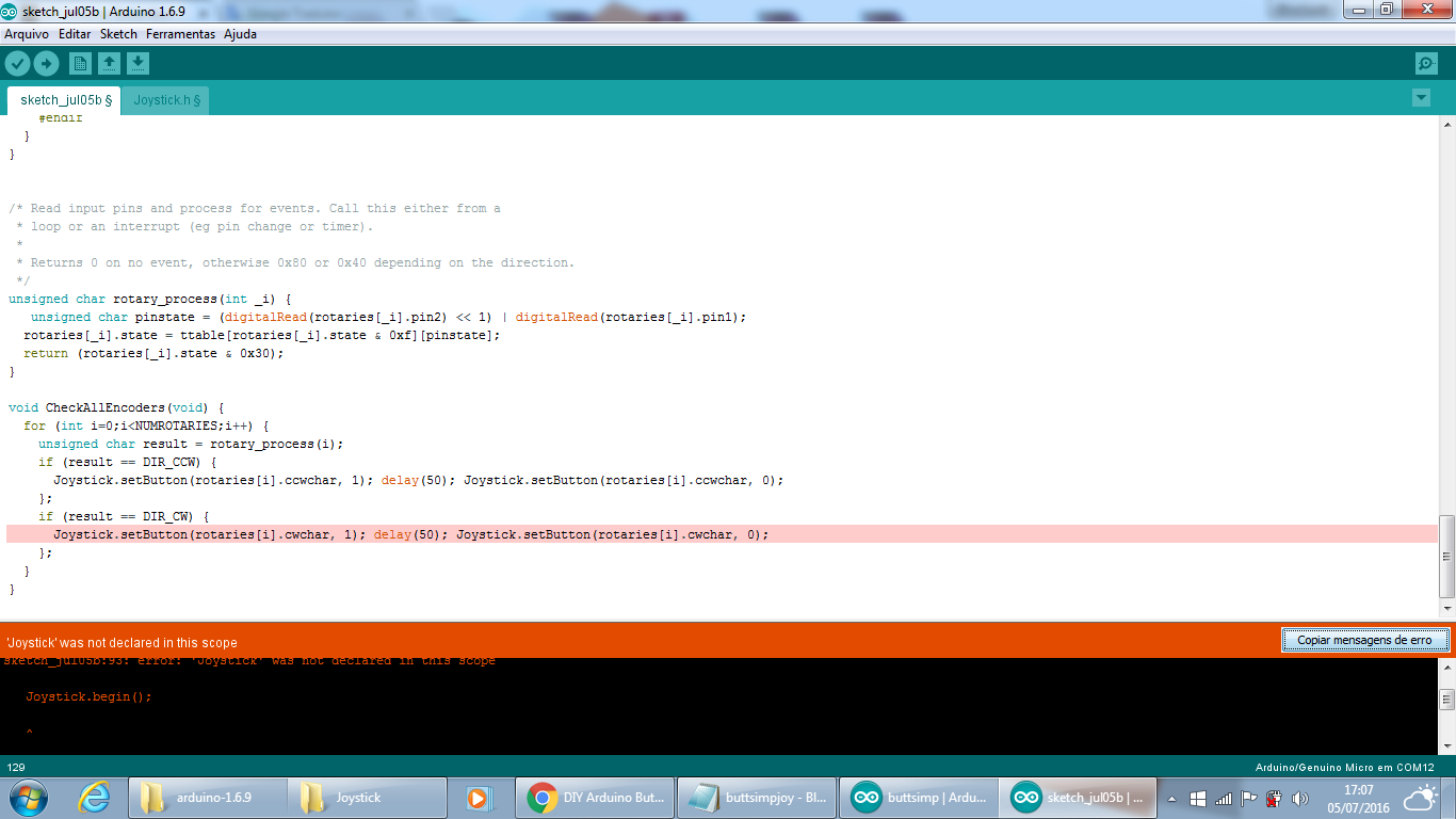

    Arduino: 1.6.9 (Windows 7), Placa:"Arduino/Genuino Micro"
    C:\Users\Usuario\AppData\Local\Temp\arduino_modified_sketch_295951\sketch_jul05b.ino: In function 'void setup()':
    sketch_jul05b:93: error: 'Joystick' was not declared in this scope
    Joystick.begin();
    C:\Users\Usuario\AppData\Local\Temp\arduino_modified_sketch_295951\sketch_jul05b.ino: In function 'void CheckAllButtons()':
    sketch_jul05b:111: error: 'Joystick' was not declared in this scope
    Joystick.setButton(key, 1); delay(50); Joystick.setButton(key, 0);
    C:\Users\Usuario\AppData\Local\Temp\arduino_modified_sketch_295951\sketch_jul05b.ino: In function 'void CheckAllEncoders()':
    sketch_jul05b:144: error: 'Joystick' was not declared in this scope
    Joystick.setButton(rotaries.ccwchar, 1); delay(50); Joystick.setButton(rotaries.ccwchar, 0);
    sketch_jul05b:147: error: 'Joystick' was not declared in this scope
    Joystick.setButton(rotaries.cwchar, 1); delay(50); Joystick.setButton(rotaries.cwchar, 0);
    exit status 1
    Este relatório teria mais informações com
    "Mostrar a saida detalhada durante a compilação"
    opção pode ser ativada em "Arquivo -> Preferências"

  19. Claudemir
    Oct 22, 2012
    168
    32Coins
    +33 / 1 / -0
    @TOPMO3 I found my mistake!:cheers
    I was putting the wrong library file!
    when you dawloand the link above, contained two types of archive joystik Version2.
    this is not compatible file!
    thank you for your work.hug:
