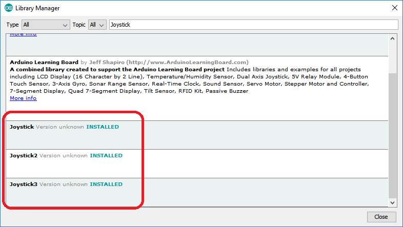

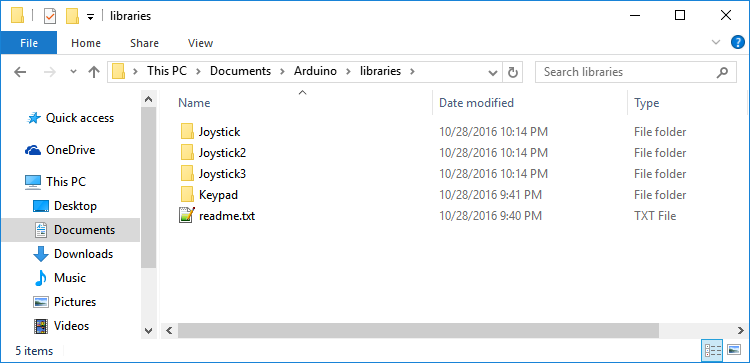

    Just download Joystick library and unzip it into your Documents\Arduino\libraries folder.
    It should looks like this:
    Restart IDE and libraries shuold be listed in Library Manager:
    If you cant see joystick libraries in the Library Manager, try to install it through IDE's menu Sketch->Include Library->Add .zip Library

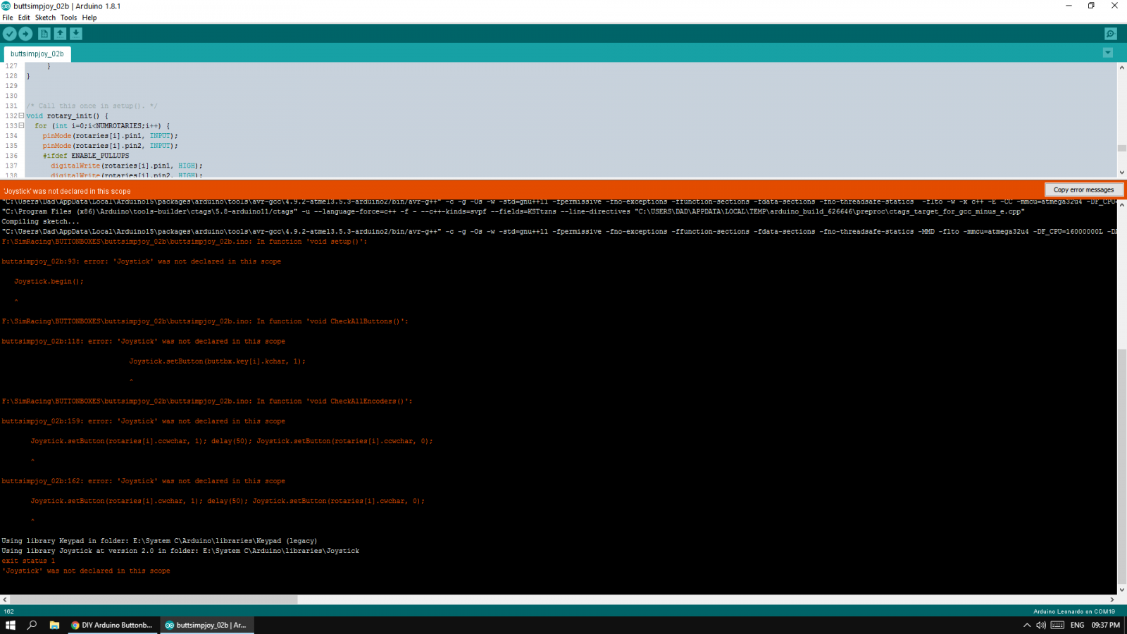

    hi. i got it working now but have the following error coming up.
  11. TOPMO3
    TOPMO3 Active Member
    May 12, 2015
    133
    Russia
    894Coins
    +201 / 0 / -0
    Ok, it seems Matthew changed his joystick library.
    best option should be to modify my sketch according to the newer library version, but I haven't arduino board to test it right now.
    So can you please try to replace the library by older version?

    Thank you. that worked perfectly. now to reassemble the button box. much appreciated.

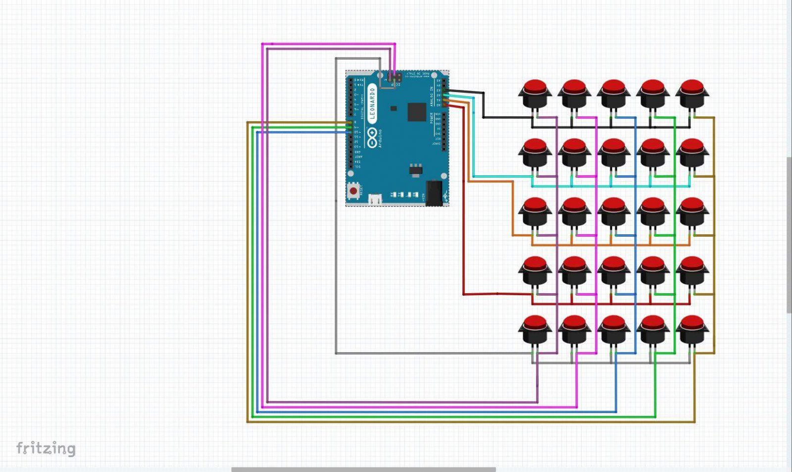

    Feb 28, 2017
    196Coins
