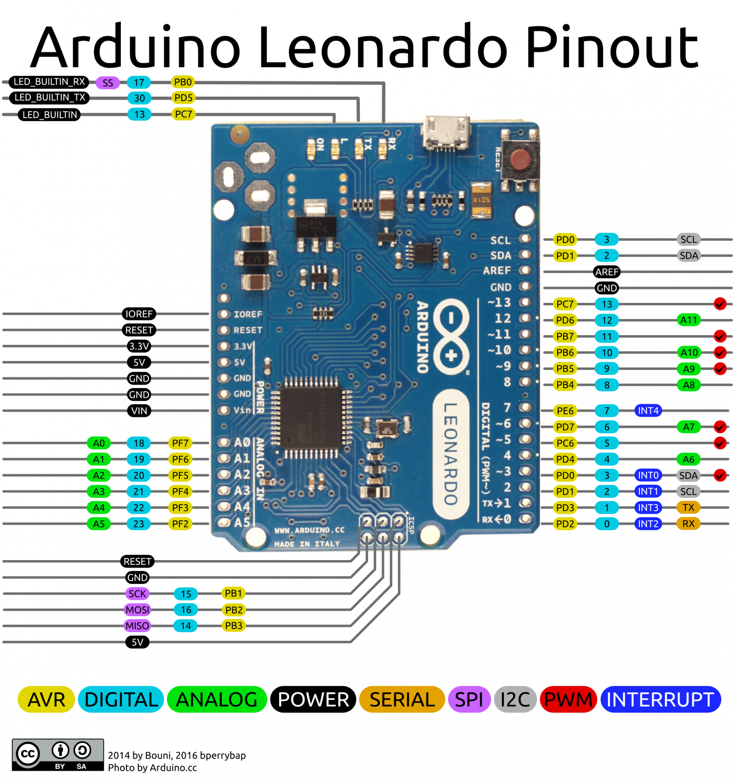

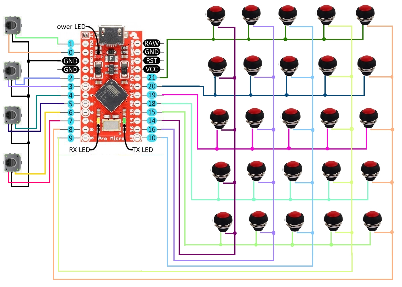

    Hi @Lightman
    I can't see you wiring, but I think you can use exactly the same pins as for Micro - 10, 16, 14, 8, 9 for matrix columns and 15, 18, 19,20, 21 for rows.
    If any of columns or rows will not work - let me know Im sure we'll fix it :)

    I have to the blue numbers held.

    yes, use blue (digital) numbers

    Hello I have got the board and now everything connected 25 buttons.
    If I now want to compile the butten simpjoy_02c I get an error.
    Can you help me

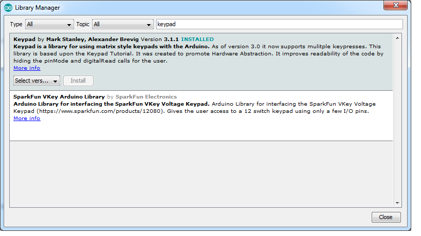

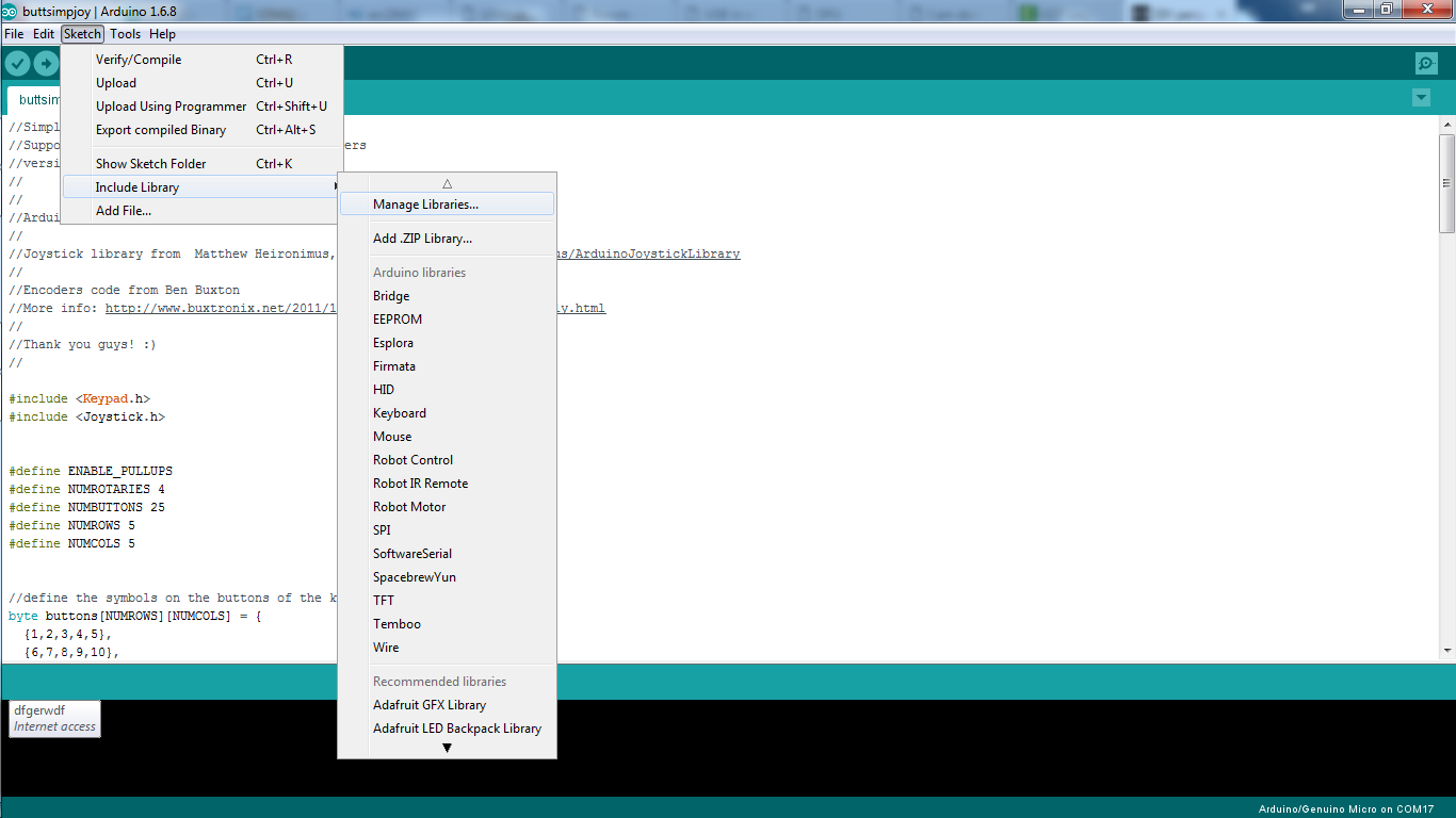

    Do you install keypad library?
    go to Sketch -> Include Library -> Manage Libraries
    then type keypad in search and then choose "Keypad by Mark Stanley, Alexander Brevig" and then click Install

    Ok thank you really so a simple mistake it now works Perfect all 25 buttons
    Topmo you're the best I thank you.
