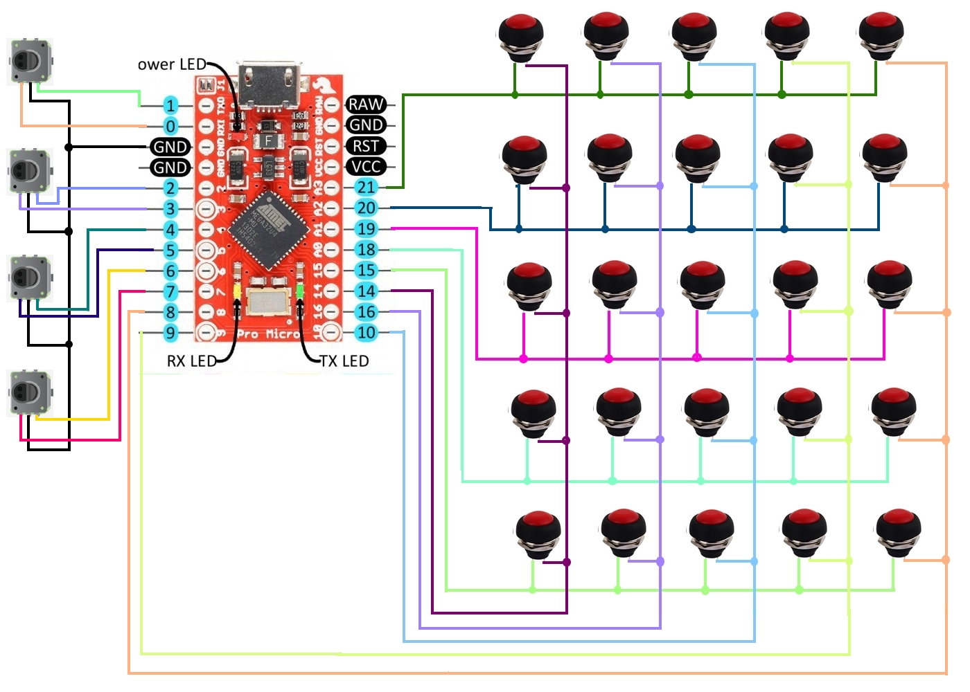

    I have a problem. I have a Buttonbox connected according to the schematic, but only 3 encoders work from 4. How can I solve this problem?
    Thank you.

    Thank you very much for your work and I would like to ask you how I could wire EC11 Rotary Encoder
    to use the encoder button.
    I mean when I press the whole encoder to make it as other button.
    Best regards
    Lukas
  7. TOPMO3
    TOPMO3 Active Member
    May 12, 2015
    133
    Russia
    896Coins
    +201 / 0 / -0
    Hi Lukas
    An encoder with button has 5 legs - 3 legs for encoder and 2 leg (on the opposite side) for a button. So just wire those 2 legs like a normal button
    Cheers!

    Hi, thanks for that great project. I´m trying to make one. But, where can I download the layouts for make pcb?.What is OP?? Sorry for my poor english and thanks in advance
    Best Regards
    Dualin
  11. TOPMO3
    May 12, 2015
    133
    Russia
    896Coins
    +201 / 0 / -0
    Hi @dualin
    there is sample schematic in the my first post which you can use as a reference. It shows how to wire and connect buttons and encoders to arduino board. In general, you don't need PCB, only if you want to have more comfy connectors and so on..

    Ah! ok, I asked because i have made a button box with the connections like your schematics and doesn't work fine. I use 16 buttons, 4x4, the buttons work, but all the buttons in a row show the same button in Windows joystick panel, then i have only 4 buttons instead of 16....
    I have tried all the things that i can, but doesn't work. I dont know what happen.
    Thanks and best regards
    Dualin
  13. TOPMO3
    May 12, 2015
    133
    Russia
    896Coins
    +201 / 0 / -0
    Hi @dualin
    It seems something wrong in your wiring or soldering, can it be you mistakenly wire all buttons in a row also in one column? Hard to say exactly what is wrong without physical access to your device. May be you can show a picture of your wiring?

    Hello all guys,
    i have use 02c version but i have a problem...everything works fine but i can't find where is button No1....can you help please?
  17. TOPMO3
    May 12, 2015
    133
    Russia
    896Coins
    +201 / 0 / -0
    Hi @f1simgames
    there are 2 lines in the sketch:
    byte rowPins[NUMROWS] = {21,20,19,18,15}; //connect to the row pinouts of the keypad
    byte colPins[NUMCOLS] = {14,16,10,9,8}; //connect to the column pinouts of the keypad
    1st line containts pins used for rows and 2nd line - for columns.
    So very 1st button will be that which is connected to 21 & 14 pins
    And please use 2d version because its better :)

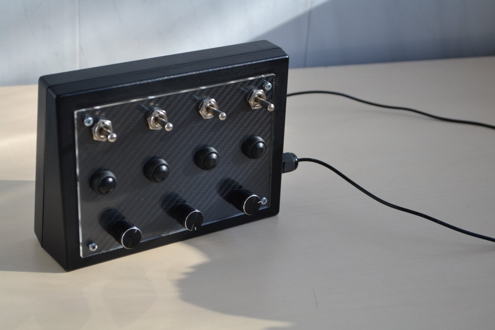

    used this to make my buttonplate.. seems to work well !! Also included the switch function of the encoders, giving me a total of 12 pusbuttons and 3 encoder functions. Thanks !
