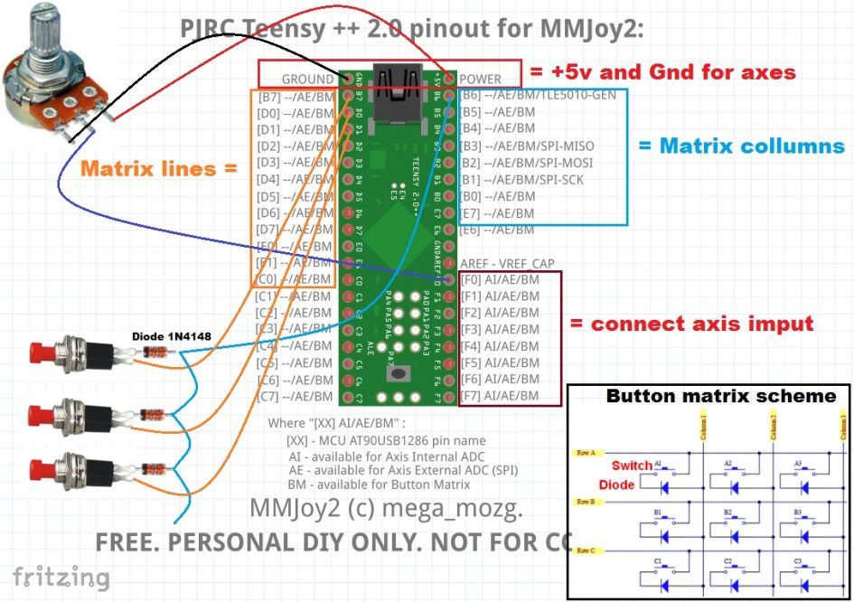

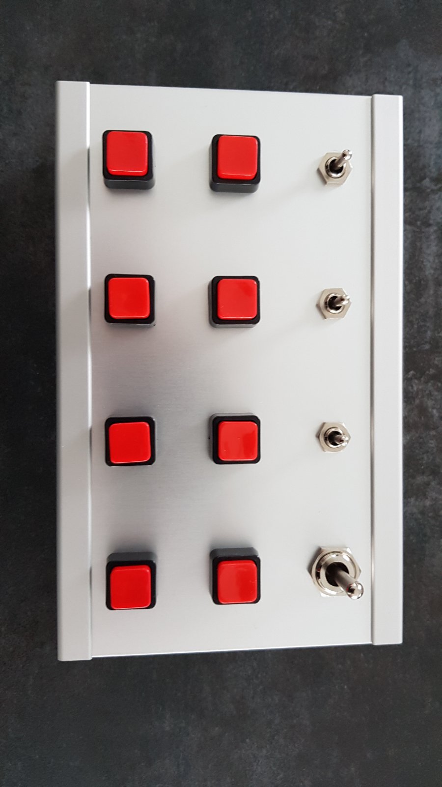

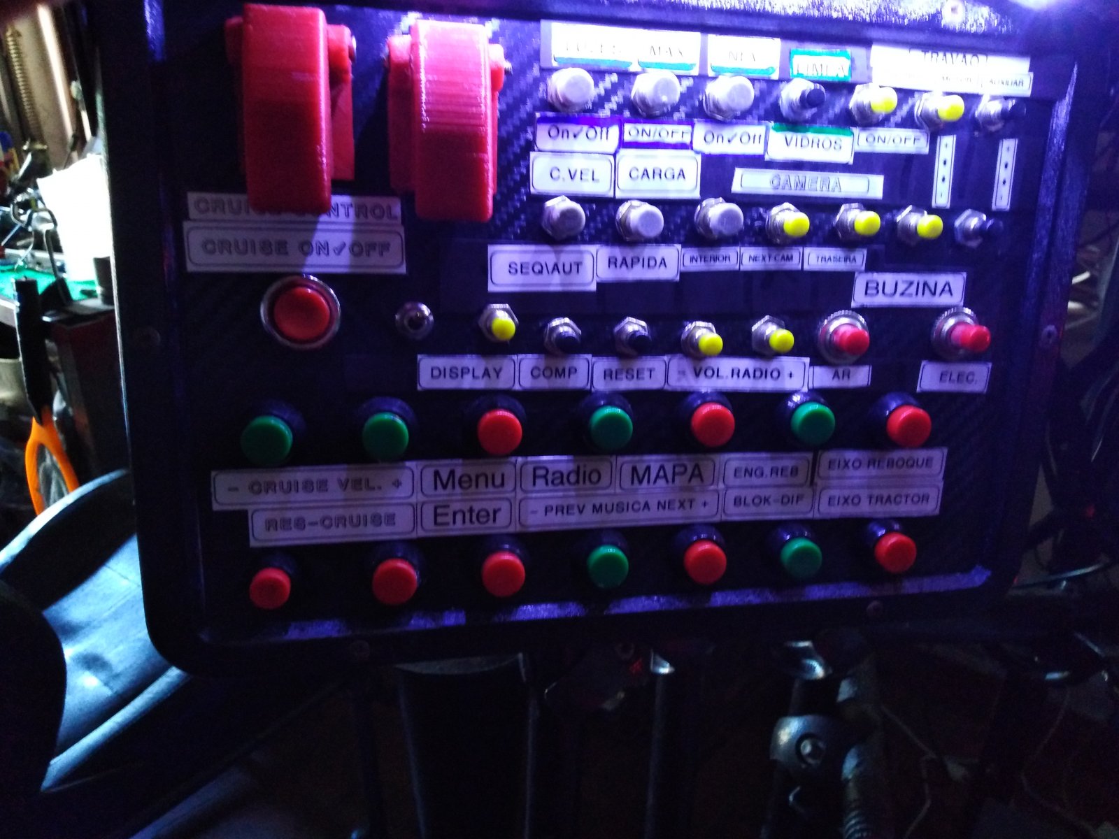

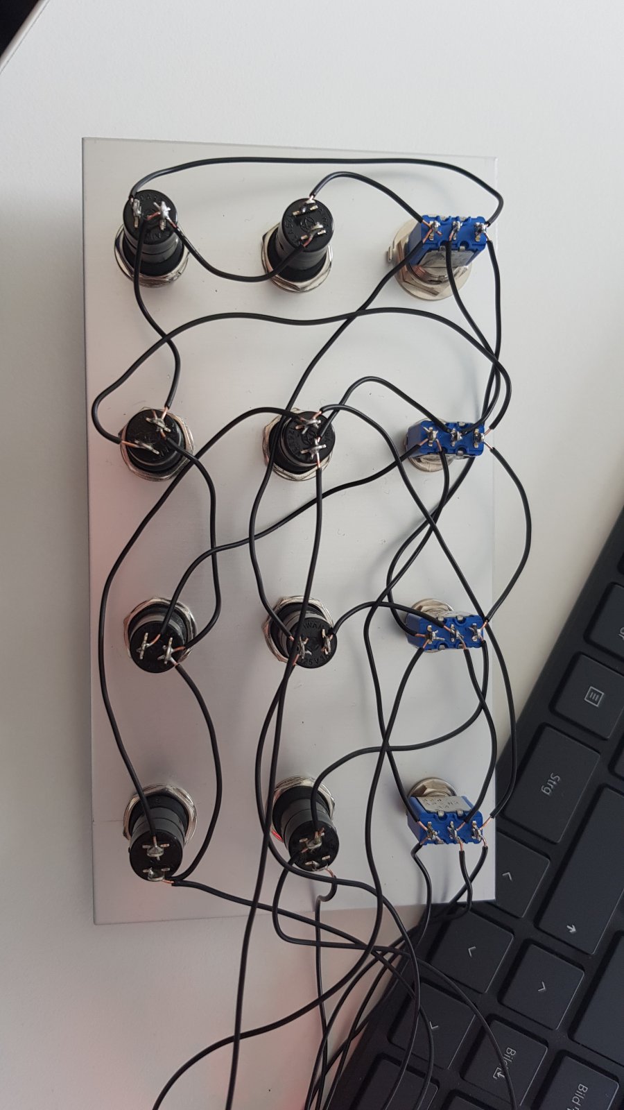

    Hi all,i have done also a button box,a just give a touch ,just use some magnetic stripes to do the layout for the games !a sample in the photo! IMG_20180921_094356.jpg IMG_20180921_094740.jpg IMG_20180921_094804.jpg IMG_20180921_094525.jpg

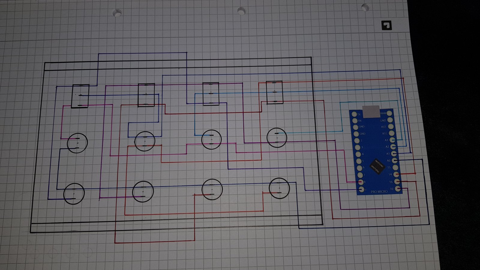

    for 8 encoder and 20 buttons I would need two arduino? Can I put a USB hub to use a single cable? No choice?

    EVOLACO just check if this work for your projet with 8 encoders! 7921781a6113e0d6fd96f465037ce1c4.jpg

    How many buttons and encoder can you use in total? Is there more information and the sketch?

    i think you can put 96 butons and 8 encoderes( butons =coluns x lines)12x8=96 for more info check mmjoy2 software(it works plug and play)if you need more than 8 encoders you can connect also encoders to the matrix keyboard (colunsxlines=matrix)

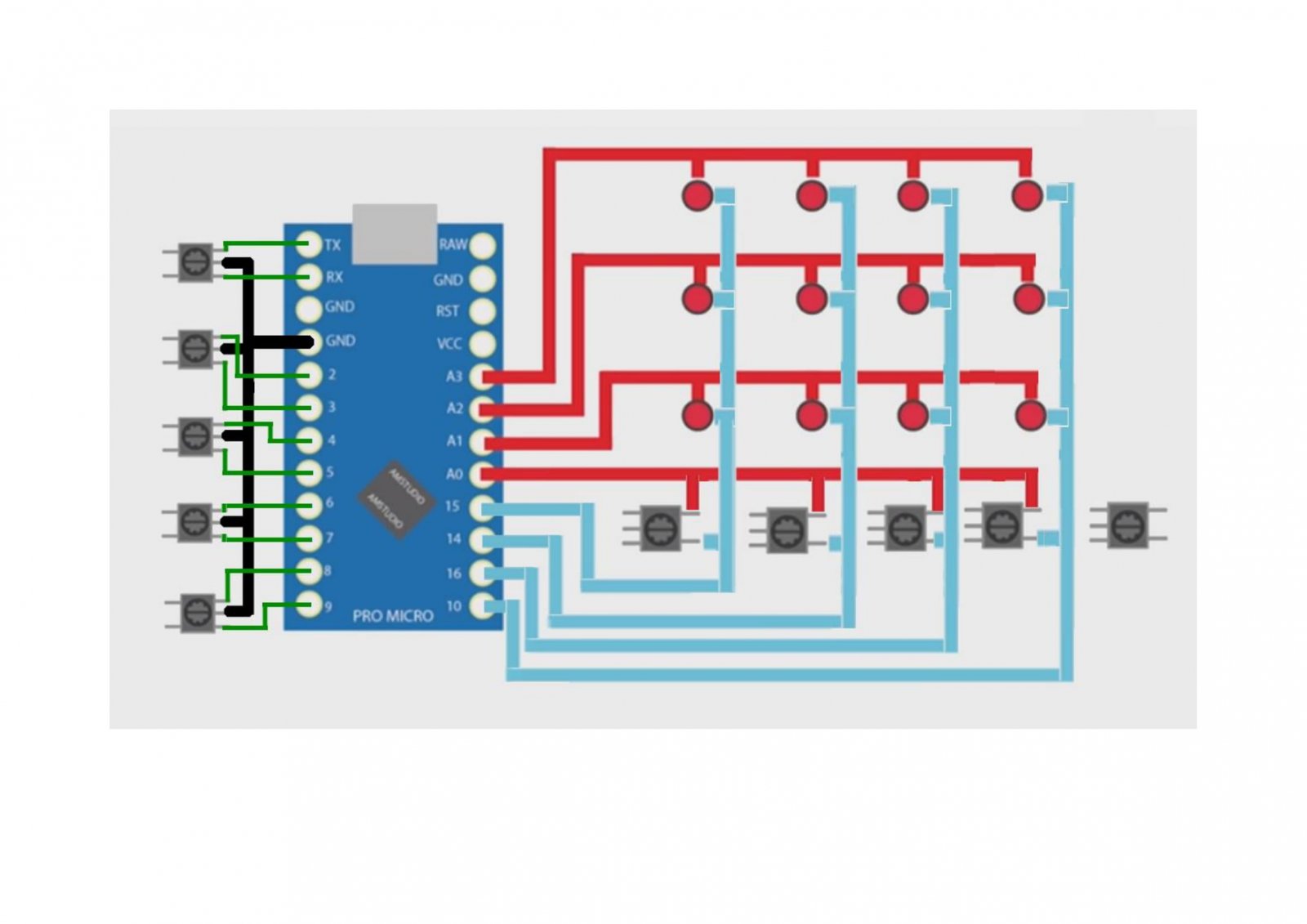

    Hi Jon!
    I am very sorry for the late reply (i did not get an update mail, must have mest it up some how)
    I have connected the rotaries the same way as you, but i am using this code in the beginning.
    I hope this will help you, if you haven't solved it already.
    If you haven't and this wont help i will keep looking and compering code.
    rotariesdef rotaries[NUMROTARIES] {
    {0,1,26,27,0},
    {2,3,28,29,0},
    {4,5,30,31,0},
    {6,7,22,23,0},
    {8,9,24,25,0},

    Hi @Henrik ,
    Just want to let you know that the encoders and all buttons are working fine.
    Thanks for your reply.
    Grts Jon

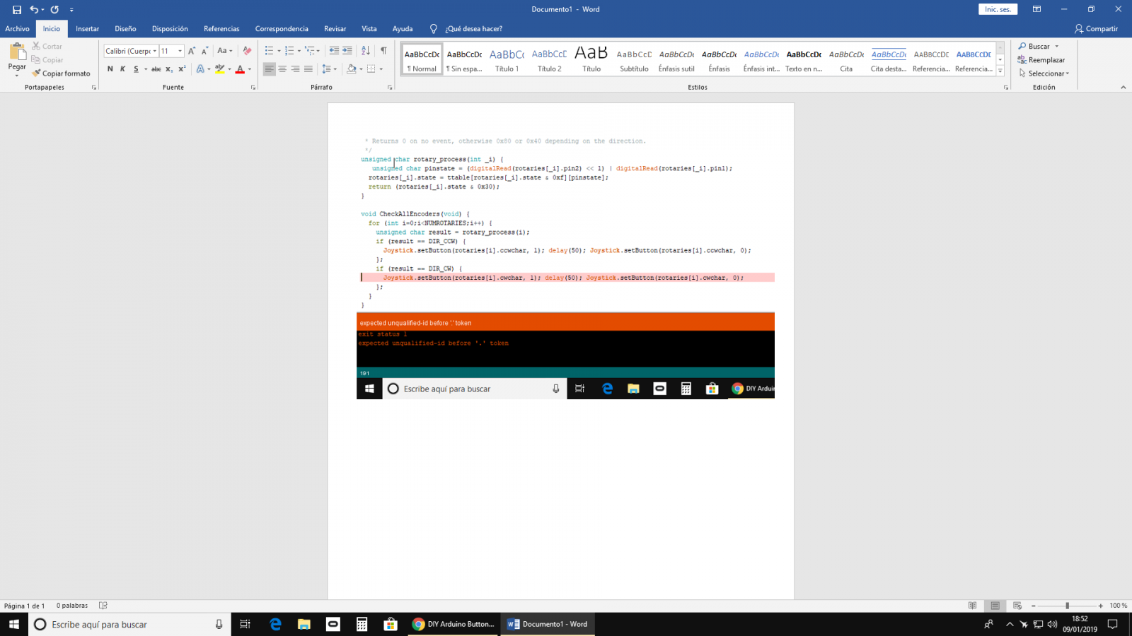

  11. KARTUXO
    KARTUXO New Member
    Jan 9, 2019
    167Coins

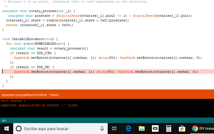

    Hello everyone, do not program arduino, but thanks to these posts I have started an online course.
    I appreciate the work and the contribution of all, of which I have learned a lot
    but I find an error when compiling ... can someone tell me how to solve it ?? ... thanks to everyone.
    using google translator sorry!

    KARTUXO New Member
    Jan 9, 2019
    167Coins
    sorry !! ... here the error capture

    Hello
    I am testing the code for five rotary and I have a problem. Compiling correctly, I upload the program without failures, and testing the two arrays that have been published, the fifth rotary only manages to activate the button 25 in one direction. The other four rotary if they work correctly. I leave the code here in case someone could help me, thank you.

    Hello and thank you topmo3 for making open source files! I have KY-040 rotary encoders(built in 10k resistors) and am using butsimjoy02d file. Simple momentary buttons work and 3 of 4 rotary encoders read cw/ccw. However I have two problems.
    1. The rotary encoders push buttons show a series of button pushes instead of one when using win 10 game controller settings. Ex 22,23,24,25,26 will highlight red instead of just one number when pressing the rotary button.
    2. The Pins 6 and 7 on the promicro do not work on my rotary encoder? I have tried the other buttsimjoy files and have the same problem.
    Thank you for any help in fixing these issues.
  17. Luis.Uet
    Luis.Uet New Member
    Apr 27, 2019
    25Coins
    Hello guys,
    I built my own ButtonBox yesterday...
    I have got 4 toggle-switches with two way activation (on) and a springreturn to the middle (off).
    And 8 normal push-buttons.
    All this is connected to an normal Arduino Pro Micro...
    Now I want to know if I even wired it up correct?
    And which Arduino sketch I have to use?
    Because I didn't get it running on my own.:sos
    If I use the first sketch, I can upload it without any problems but the buttons won't work. (Some of them work sometimes?!)
    If I use the newer ones I will have different errors. (expected unqualified-id before '.' token or 'xyz' does not name a type)
    I have downloadet many librarys. (keypad, keyboard, joystick...)
    What do I have to do now?
    Cheers
    Luis
  18. Luis.Uet
    Luis.Uet New Member
    Apr 27, 2019
    25Coins
    Hey Guys,
    I got it all sortet now...:thumbs
    But how do I set up the sketch for 8 buttons and 4 toggle switches?:think
    (They got 2 ways and return to off.)
    Cheers,
    Luis
