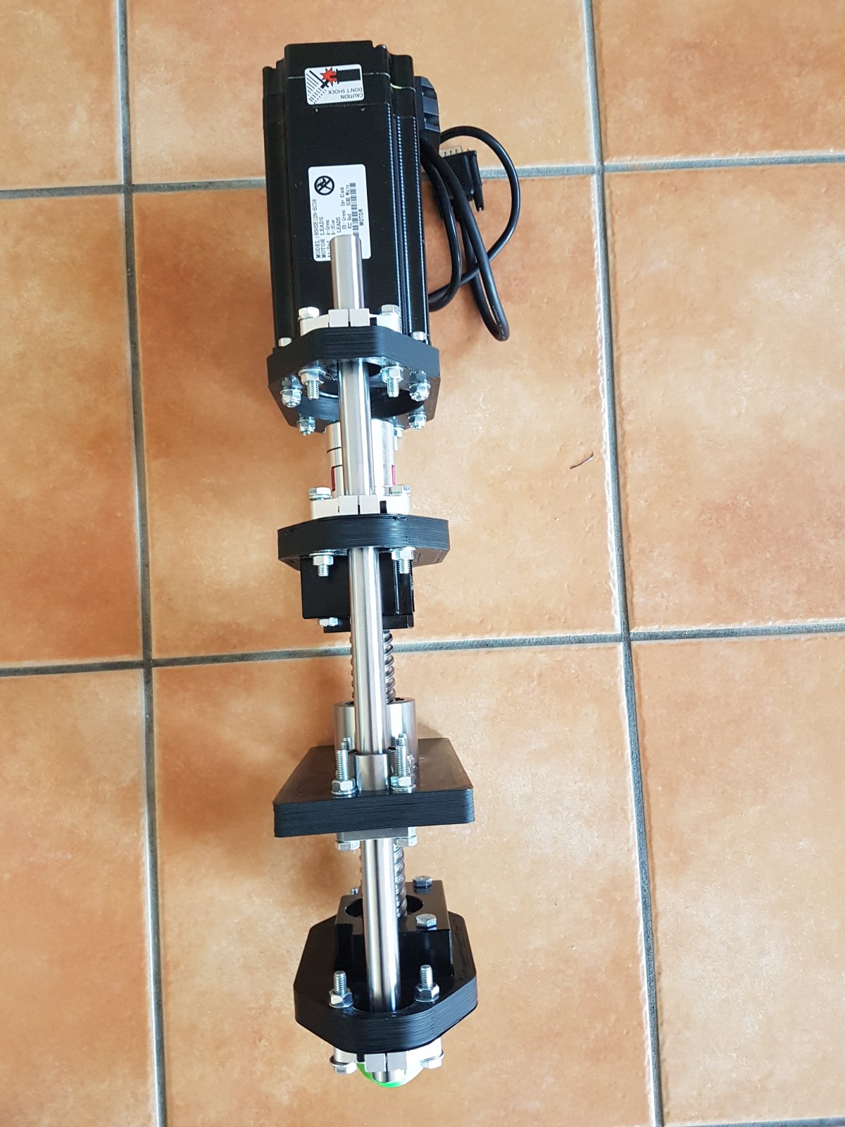

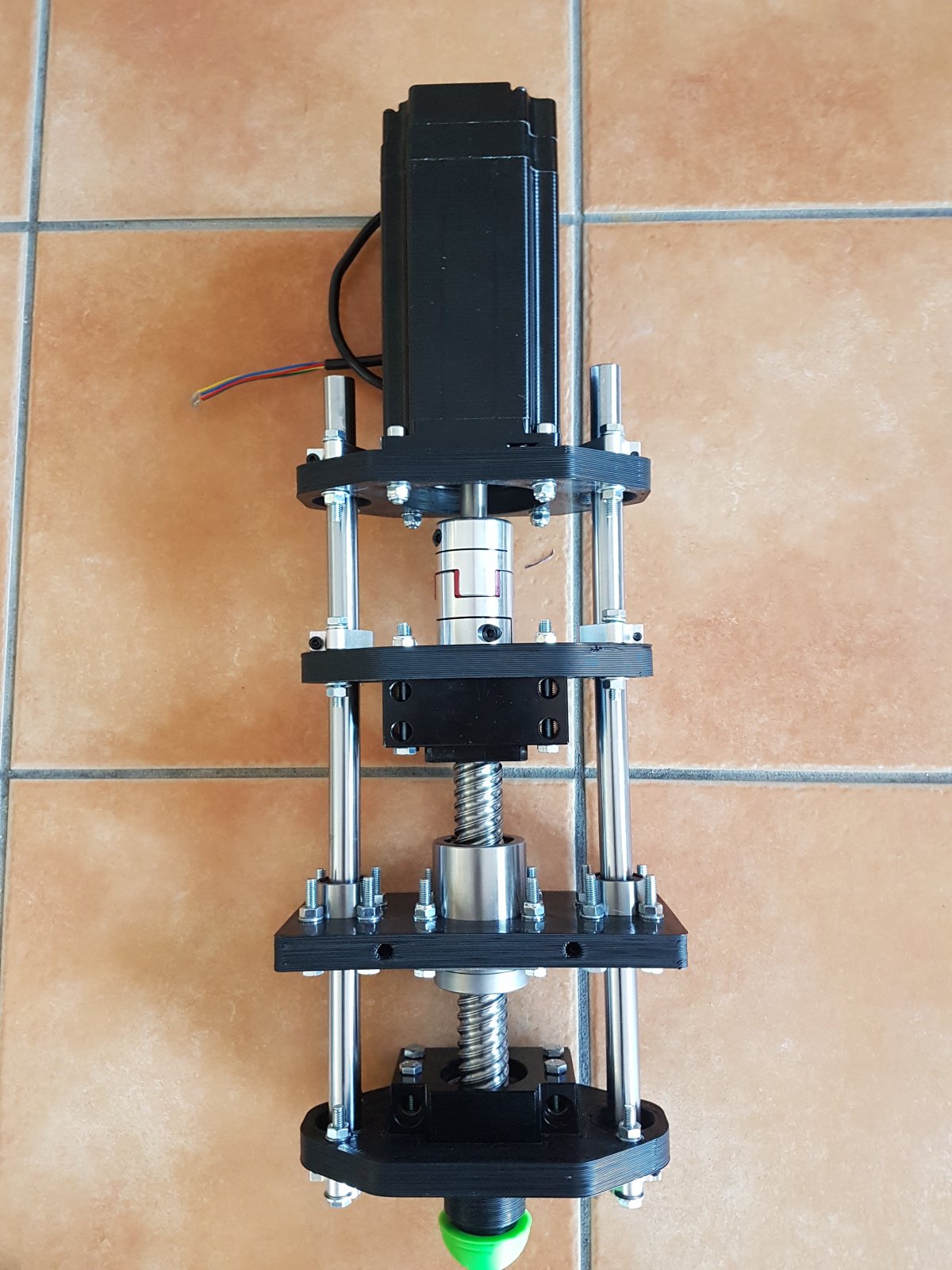

    It has been a while with updates.. This was due to the fact that the Chinese mail and the Spanish mail aren't the fastest in the world.. :)
    But anyhow I managed to get all the hardware parts needed to do my redesign of the actuators I am going to use..
    Printed the parts needed for the construction out of PETG with a 0.8 nozzle and 0.6mm layer height. These parts are strong enough for the initial testing and probably will last.. but I've made the parts as easy as possible. Although some parts are recessed, it would be possible to make it without recession.
    I haven't tested it yet but just build one of the actuators for test fitting and I think it looks quite promising.. No adjustments needed in the designed parts.. it are just long prints.
    the frame will clamp itself with a U-profile on the 2nd stage. This way I loose the weight of the actuator in the full lifting weight. 1 actuator weighs 11.5Kg.. so an easy win of 45 kg..
    Based around a 2025 Ballscrew leaving me with 8 cm of travel.. But as I have a F1 style rig this should be enough and I keep the actuator as close together as possible in a square box.. so not 2 all the way at the fron and 2 all the way back but based on the center of gravity of the rig I will square it.. so the throw of 'just' 8cm would be more then enough in a VR setup..
    Next up is printing, printing and some more printing.. I will print all parts first, also I need to find me a metalworker here in Spain that can deliver what I want..

    that is where the 2025 comes in.. I need just 3.5 rotations for the full range.. so it will be less noisy than the 1610 or 1605.. well that is my expectation!!

    Hi Michael
    I see youre using a 2025 screw,
    They lurned me on school that a screw where the pitch is bigger than shaft size you can only use them horizontaal
    I hope it works
    regards Ad

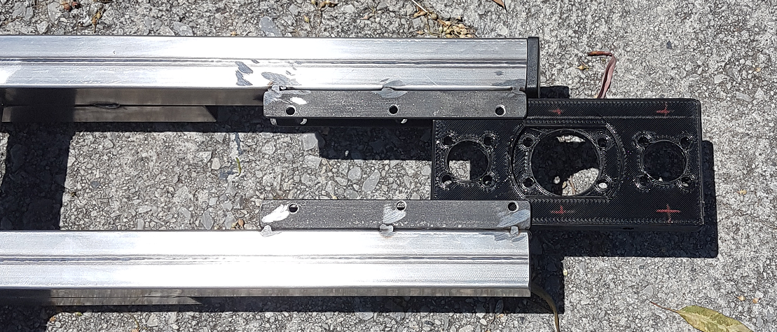

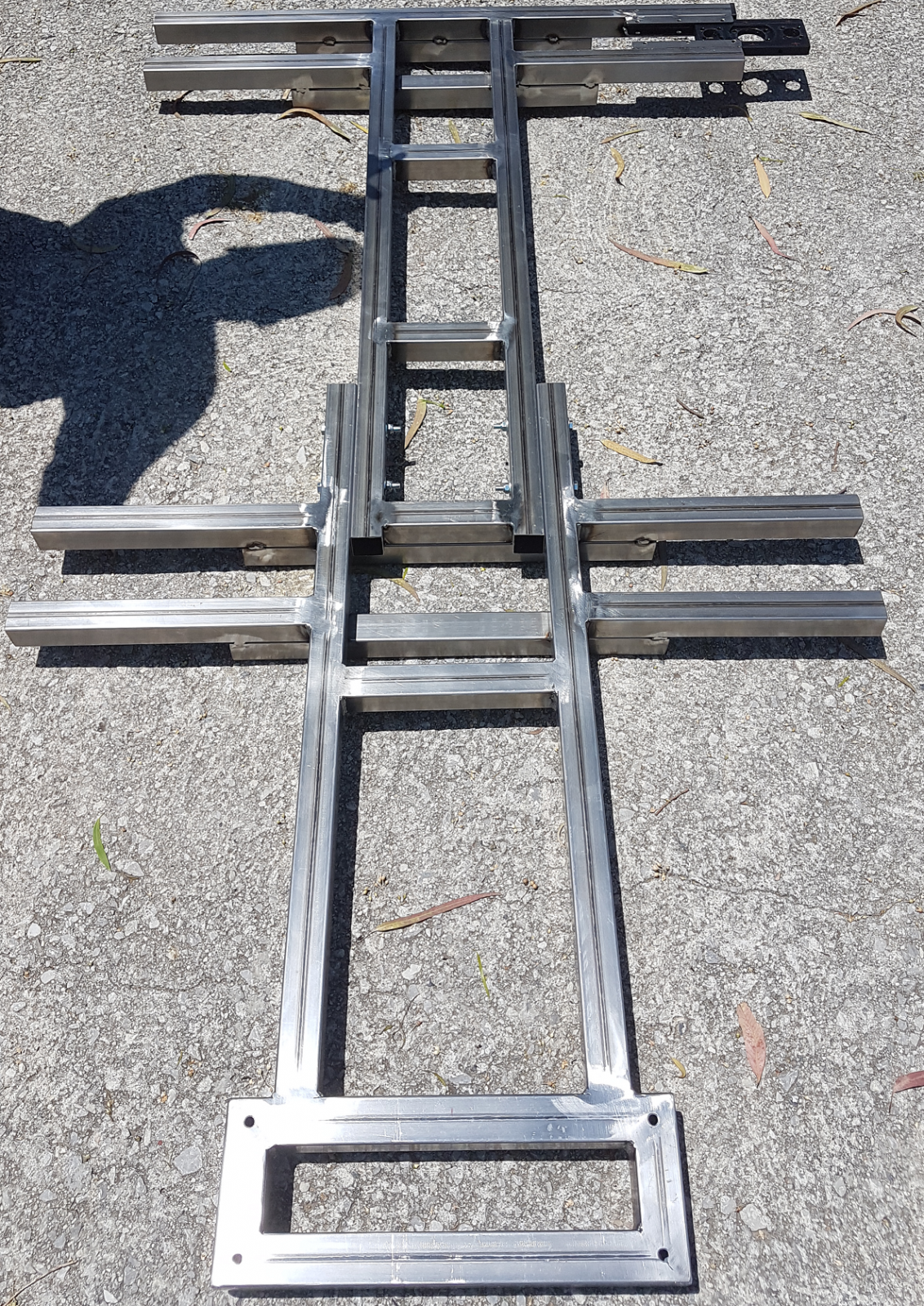

    First review of the frame that will be underneath the RSeat F1 frame..
    Looks good and a tight fight for the actuator plate...
    I just made the drawing.. no welding from my part so not really DIY :)
    Testfit of the axtuator base plate
    The frame itself..
    Will be all painted black after all is welded up..
