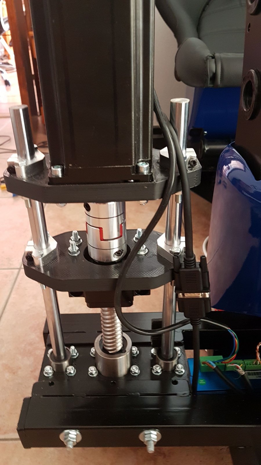

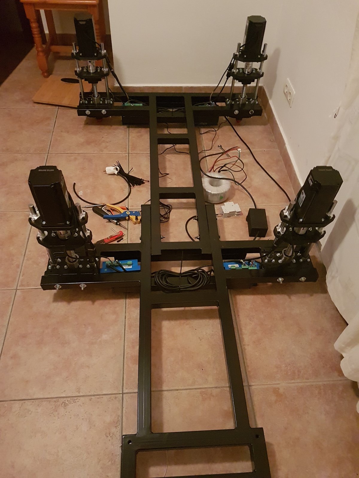

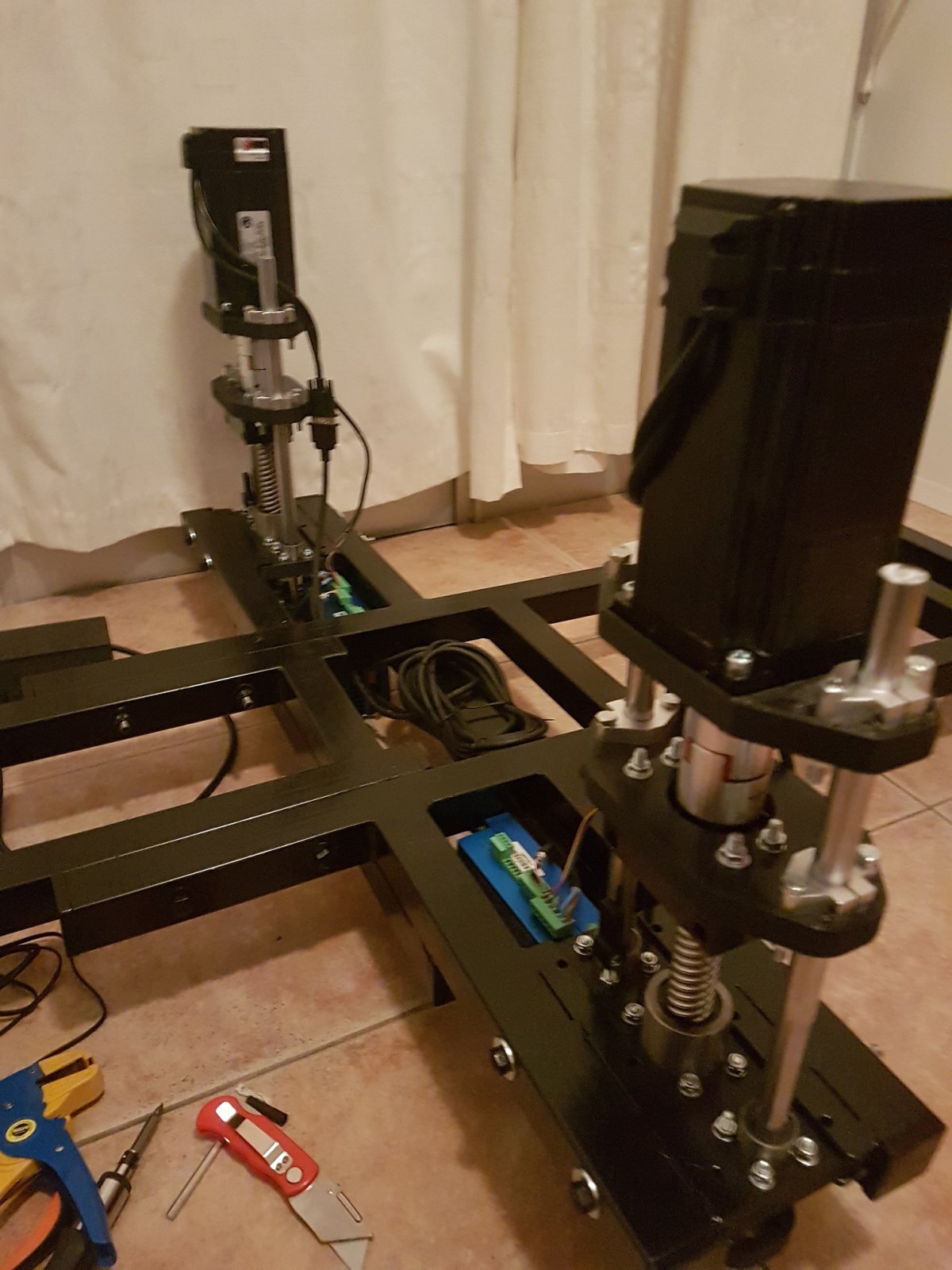

    And a small step in the right direction..
    Bottom frame is ready and motors are attached.. All is a snug fit and the platform is stable..
    Next up is more wiring.. Need to wire a couple of endstops and then unloaded tests. after that gradually add weight to see if it can hold me.. So fingers crossed :)
    Small detail view.. bolted through the fram and the base plate.. 20180604_230109.jpg

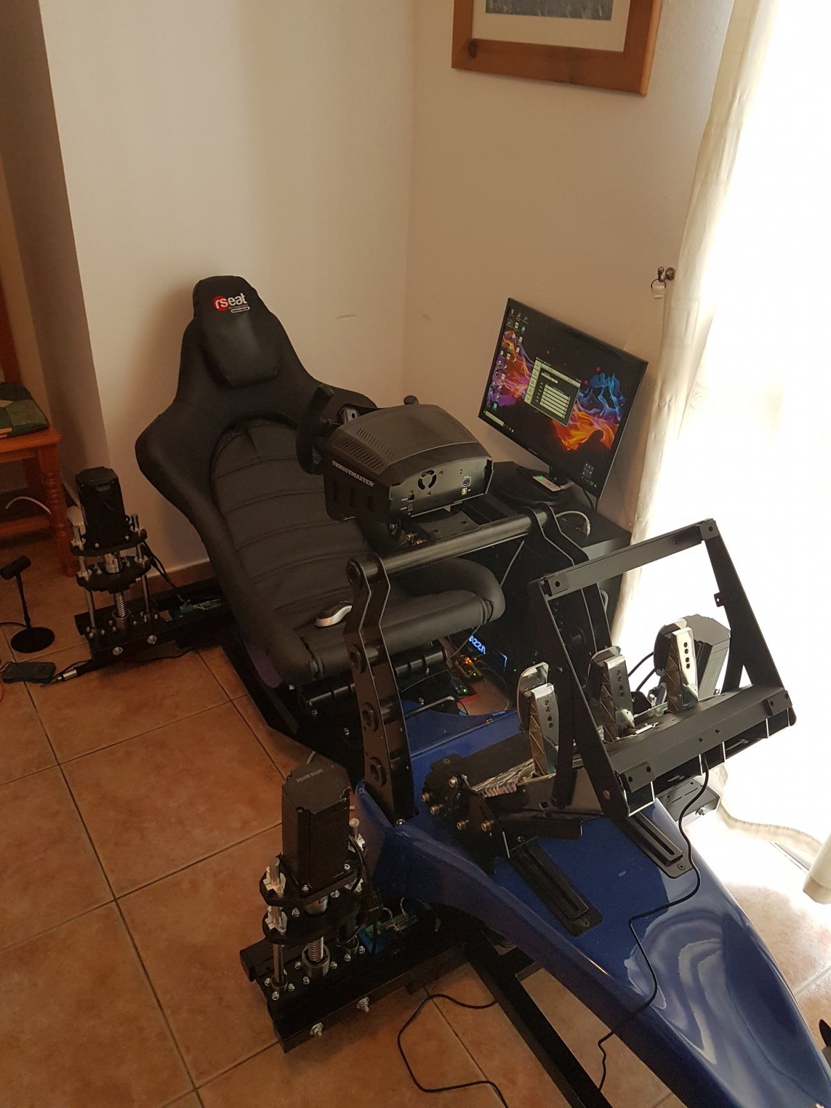

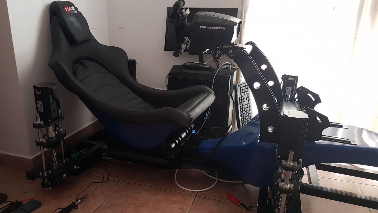

    Things are really coming together.. The 2 frames are connected and all is still working and lifting me up without a problem..
    Still everything under 16 amps while the max of a single motor is 9 amps I have it all connected to a single 70V AC toroidal spool ..
    But a relieve to see it all finally coming together.. really happy with the first result although not really happy with the accelstepper library.. so if there is anybody willing to share their Arduino code for a stepper driver (dir/step pin only) with some form of acceleration.. this is needed otherwise it gives an overvoltage error..
    For now running on 2 Arduino Mega's 1 for the back and 1 for the front.. All looks good and no difference in motion except the moving speed looks a bit higher then with 4 actuators on 1 arduin0.. as said not really happy about the accelstepper library but have nothing else right now.
    But anyway as said happy with how it all came together and also the looks of it, I like the open view of the actuators :)
    Test fitting all
    Fitted and bolted the 2 frames together..
    Nice industrial look :)
    next up .. testing.. testing.. testing.. and having fun..
