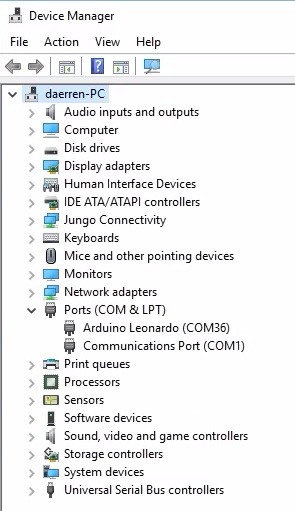

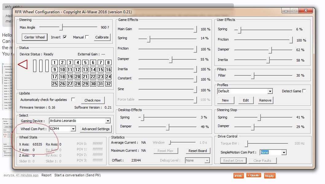

    i have got the board and have programmed the leonardo using the xloader program
    when i open the wheelconfig program the com port for the leonardo can not be displayed - so i can not program the number of pulses :(
    has anyone else had this problem

    1- Connect to USB
    2- Open WheelConfig
    3 - Remove the jumper from the pin6 (leave a finger next to pin 6 to give the noise Vcc or make a jumper pin6 to Vcc 5v).
    4- Move the handwheel / encoder and the program should acknowledge.
    5- Put the pin6 jumper for Gnd
    Now just setup and have fun!
    You need to do this every time.
    You can use a button, Gnd and a resistor for Vcc (pull up)
    To test if your card is working, you do not need an encoder, using the step-by-step above and bringing your fingers closer to pin0 and pin1 (making noise).
    If you are using a 3-channel, you may need a pull-up resistor in Z-index, but need to see the datasheet.

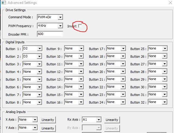

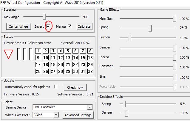

    Hello auryza, I now encounter the problem is connected to the power, the motor will have been turning, do not know why, you can help me? Thank you!

    Can be three places where is problem, you need to invert pwm signal or wheel direction, and possible you need to swap power leads of the motor.
    You need to find correct combination.

    Thank you auryza, now the motor will not have been rotating, but the steering wheel to the right to a strong feedback, turn left no, is where I set up a problem?

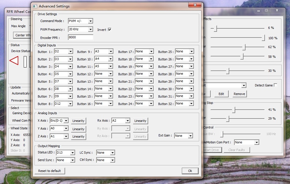

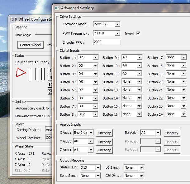

    Your encoder 2000 ppr = cpr 8000 . I think here is problem , if you have encoder 2000 you should and write 2000 not 8000. PPR means pulse per rotation, CPR count per rotation. Pulse has 4 times count.

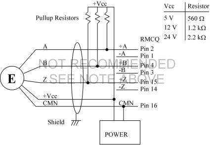

    And one more tip how to connect encoder to arduino board, you need to use pull up resistor. From positive to each channel. Look at the picture.

    Hello auryza, My encoder is the Omron E6B2-CWZ6C-2000P / R rotary encoder ABZ three received Arduino Leonardo A, B, plus the resistance, into 2000 or turn the direction of the wheel without feedback ..

    And check A and B channels of the encoder maybe you need swap the contacts.
  12. Gadget999
    2,025
    12,347Coins
    +497 / 11 / -0

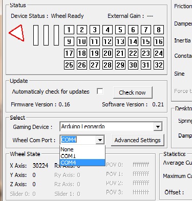

    thank you for the advice - yes i am using a 2 channel encoder
    but the problem is not the encoder and pin 6
    the wheelconfig program can see i have a Leonardo
    but it can not see the com port number the leonardo is on - the option is 'None' :(
    any suggestions what is wrong - do i need a different version of software / firmware ?

    i seem to have got it working :)
    i changed the com port number to 1 in device manager and now it appears - was driving me nuts !

    Gadget999:
    Is there a com port on your computer?
    If not, that is, Leonardo driver is not installed, re-install windows driver
    If the drive is installed, sometimes Leonardo's port is not here, then you need to re-connect usb cable and restart the computer

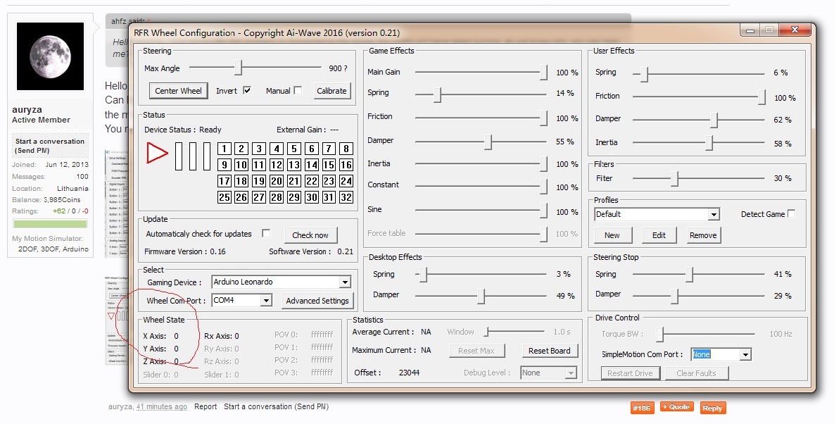

    Every time when you using wheel config tool, you should short pin 6 to ground. Then software should recognize leonardo.

    I afraid that is possible motor driver is half dead. One of the chip's not working, i had the same, you need proper cooling for this motor driver. They burn out really fast...
    But first of all you need to be sure. Just try to invert in software and check if FFB changing direction, if only to one side is hard to turn, then motor driver need to be replaced.
