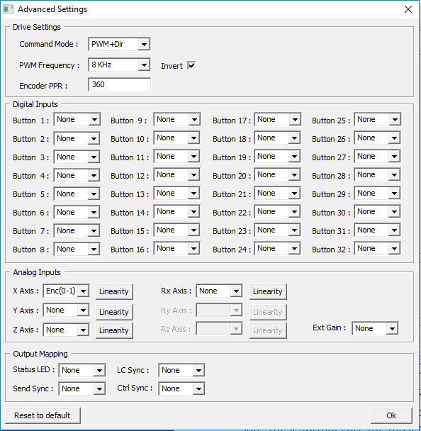

    the settings in Wheelconfig advanced are
    what is going wrong ??

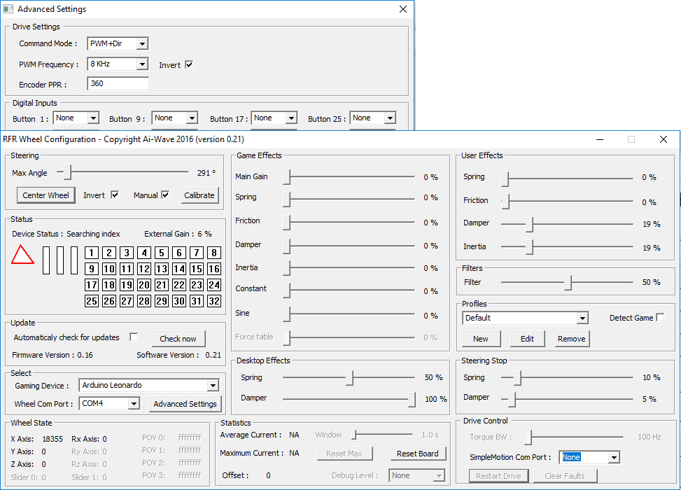

  11. Gadget999
    2,026
    12,353Coins
    +498 / 11 / -0
    Hi @Fernando Igor
    I have made some progress with a different computer
    I installed your version of wheelconfig and was able to get the laptop to recognise the Leonardo and the com port
    I was able to program the board using the wheelconfig program
    the board has pin6 connected to gnd
    by removing the pin 6 / gnd I am able to get the board to count using my finger on pin 0-1
    attached are the images of the screens

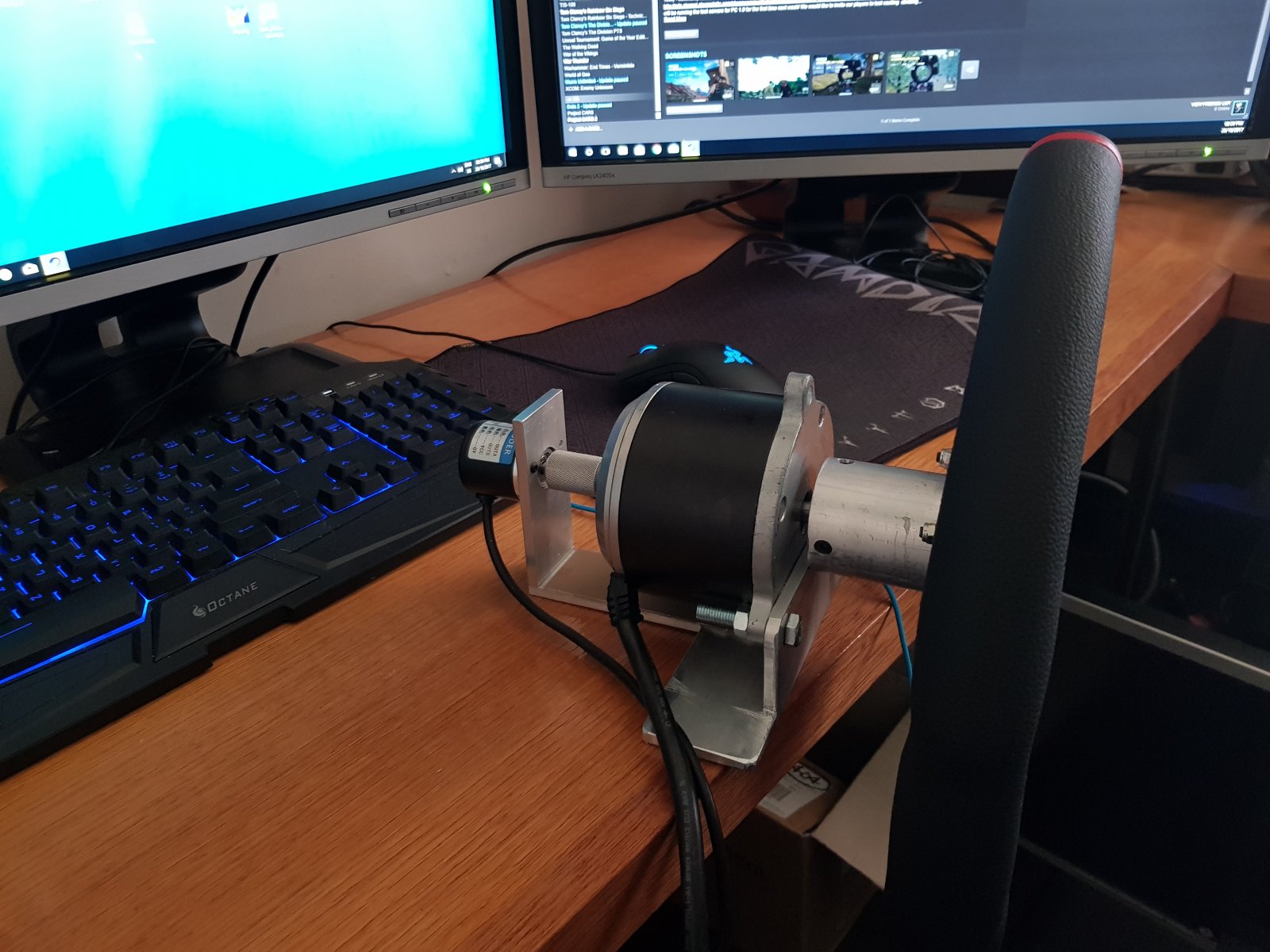

    Incoming new build!
    Some more work needed and I'll be able to start testing.

    That looks similar to my build :)
    How many volts/watts is your motor ?
    What type of encoder are you using ?
    What type of motor driver are you using ?
  18. Alexey
    Alexey Well-Known Member
    Sep 23, 2014
    452
    Electronics Technician
    Adelaide, Australia
    8,066Coins
    +624 / 2 / -0
    Motor is 24V 450W XYD 6B
    Encoder is HN3806-AB-600W (600ppr/2400 cpr)
    Motor driver is IBT-2, Technically the IBT-2 should have sufficient current but I don't know how much current this motor will need under stall.
    I will be using the MMOS to control the wheel.

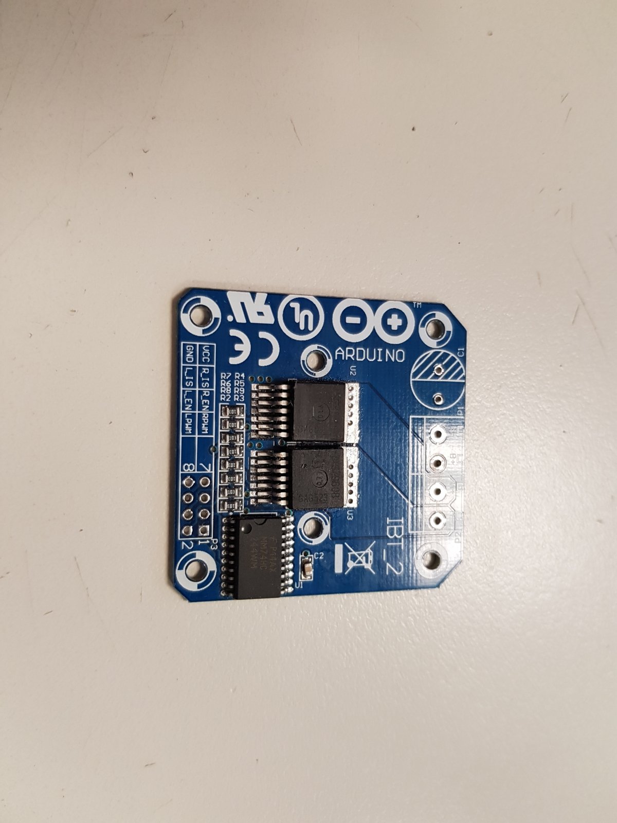

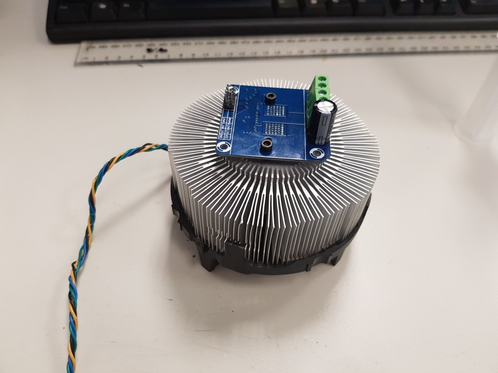

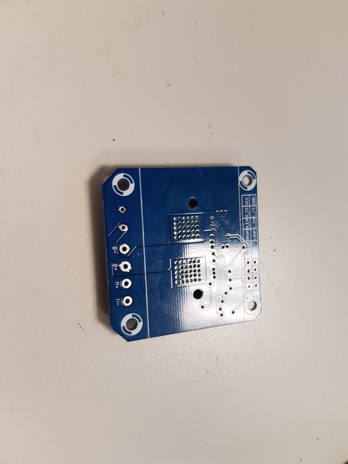

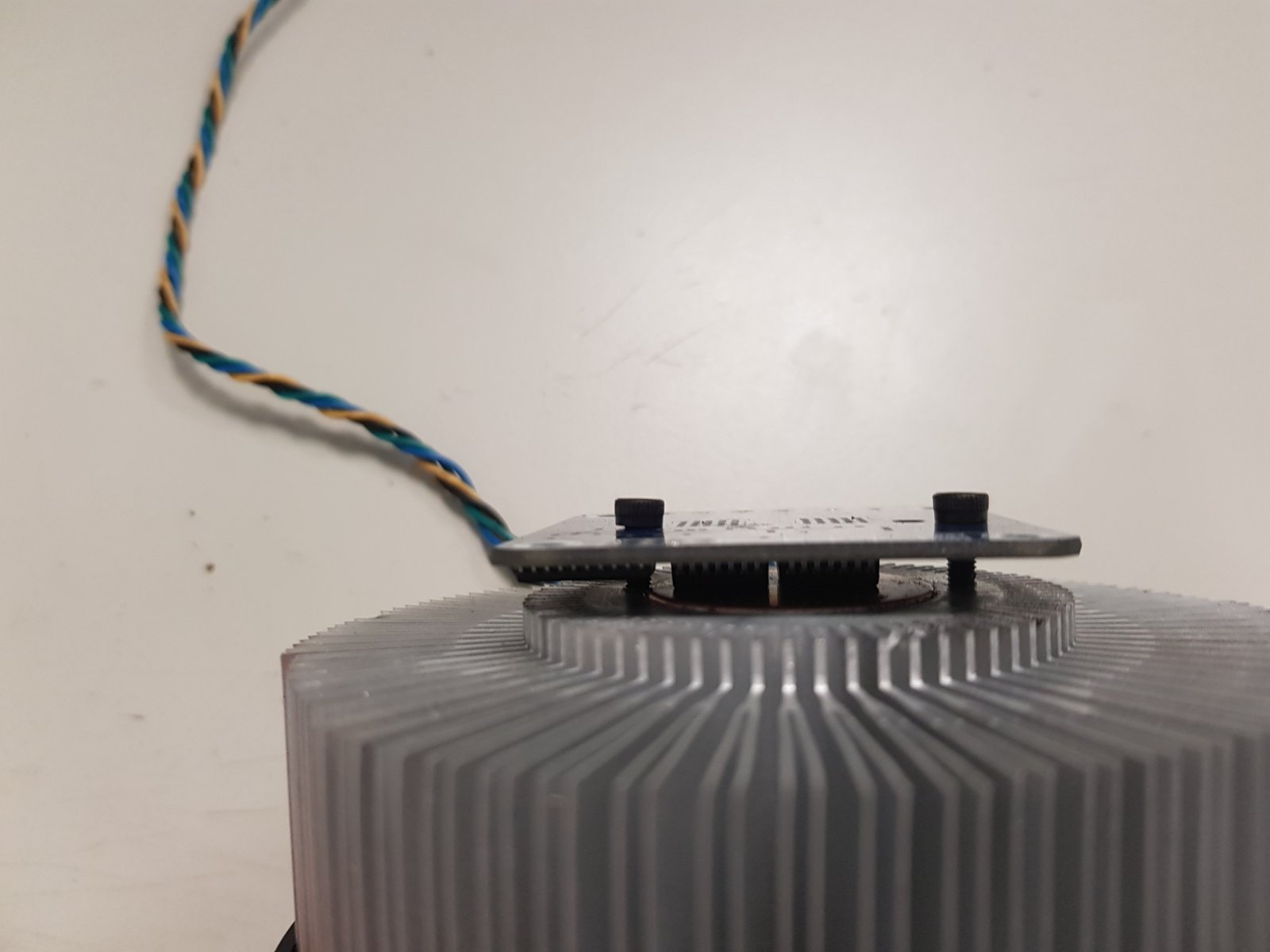

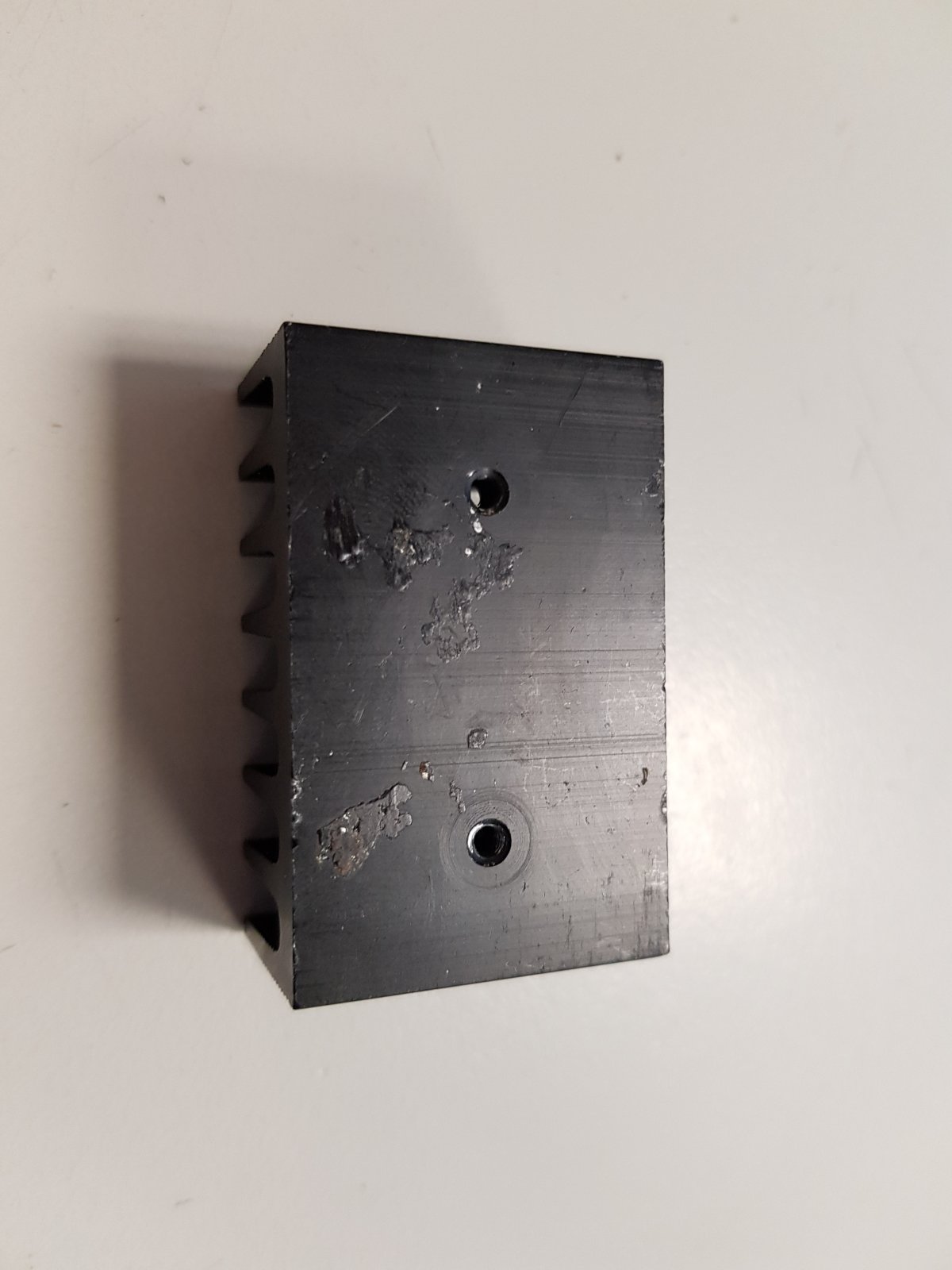

    After inspecting my IBT-2 I have found some issues with the original design. Specifically the heat sink.
    If I am to dissipate a good amount of heat I would need to actively cool the heat sink. Originally I wanted to just blow air over the standard cooler and keep it cooler that way. From the design I assumed that there would bee a big heat pad under the PCB to transfer the heat. I noticed that the heat sink was pretty firm on the PCB and so thought to inspect the heat paste applied. Not surprisingly there was no heat paste at all and the heat transfer through the PCB would be poor.
    So I decided to provide some active cooling using a CPU heatsink and attach it from the other side, directly on the mosfet.
    Here I've taken off the connectors and capacitor to free some space for the heat sink.
    The original heat sink with flux stains from original solder.
    New heat sink.
    Connectors and capacitors soldered on reverse side of PCB.
    Having the heat sink on the soldered tabs would be ideal but because those pads are actually the motor driver outputs it would be a headache to isolate everything properly.
