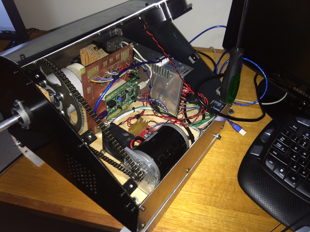

    use only one ibt2 for that engine? what amps does the blockage have? do you notice the gear of the magnets?
  3. Alexey
    Alexey Well-Known Member
    Sep 23, 2014
    452
    Electronics Technician
    Adelaide, Australia
    8,066Coins
    +623 / 2 / -0

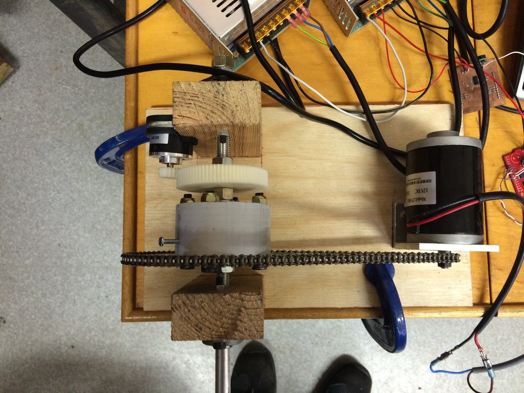

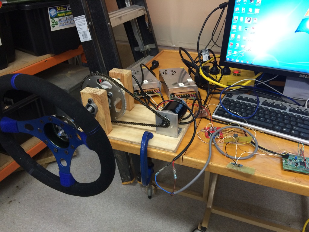

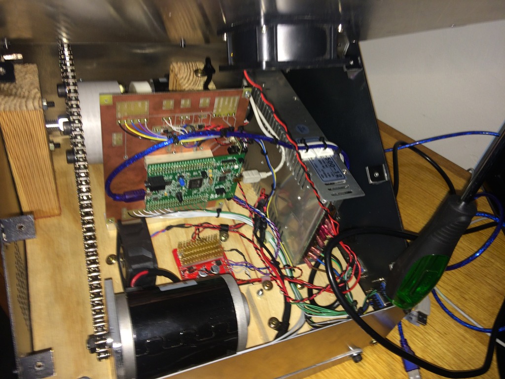

    Only one Monster Motor driver is needed as you can set it up to handle 30A.
    The motor only draws about 16A peak.
    No cogging of the motor is felt because of the gearing, however chain drive is not so forgiving if you do not line up the drivetrain 100%.
    I have however scrapped this idea due to not feeling enough fidelity in the wheels response and due to it being a bulky behemoth.

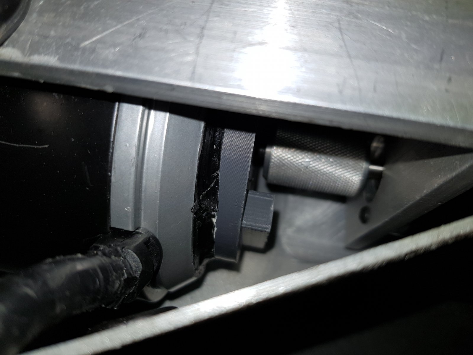

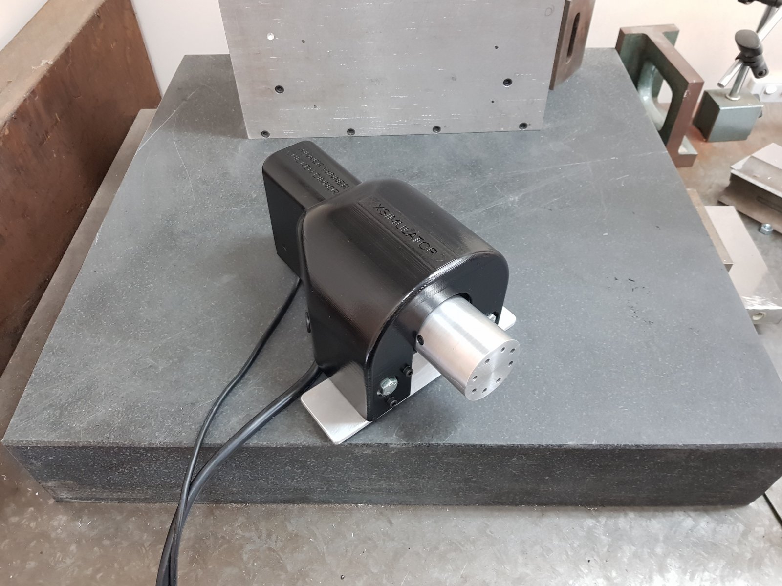

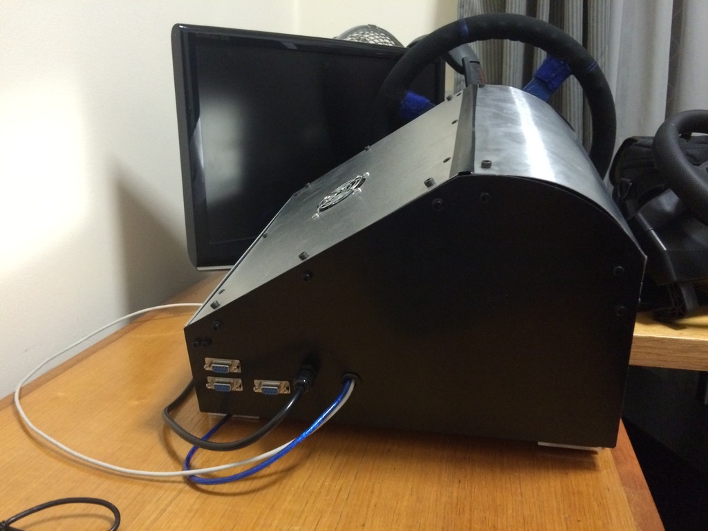

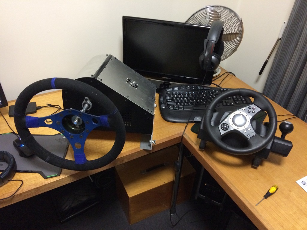

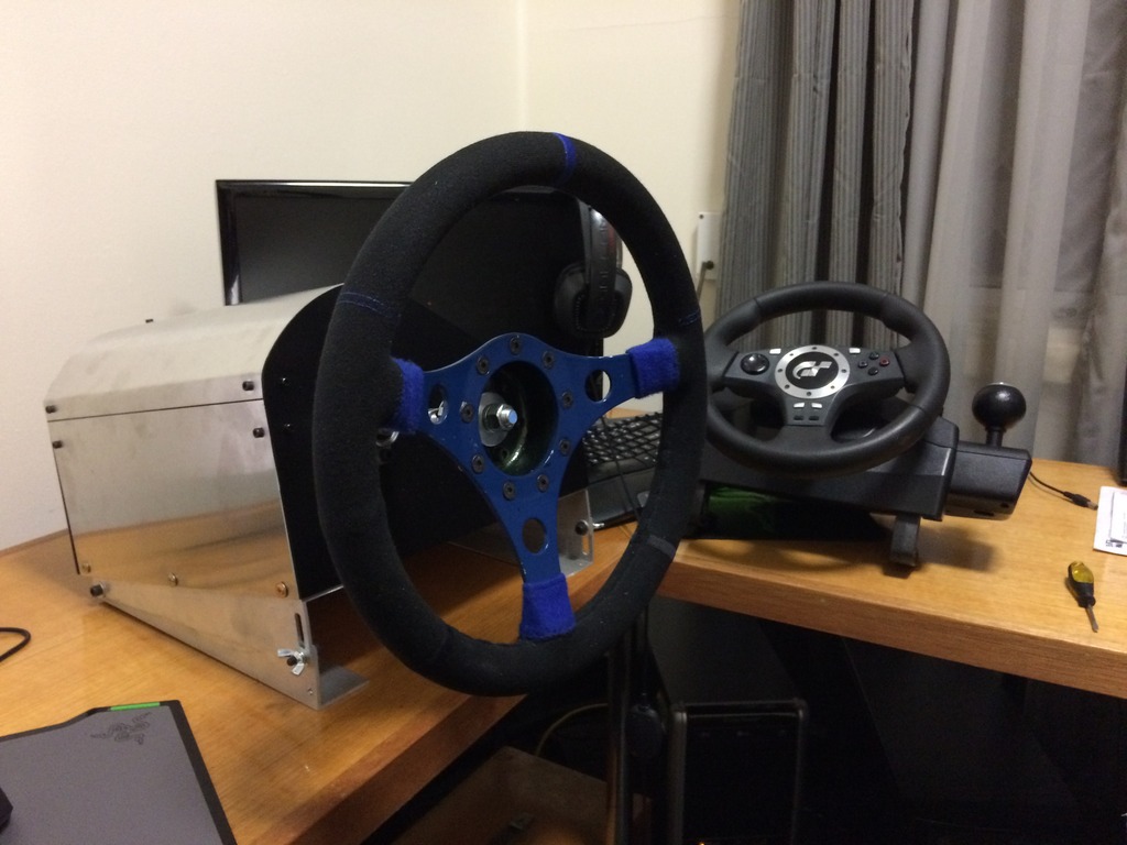

    I have decided to build a direct drive wheel with a 450W motor.
    Here is my current progress:

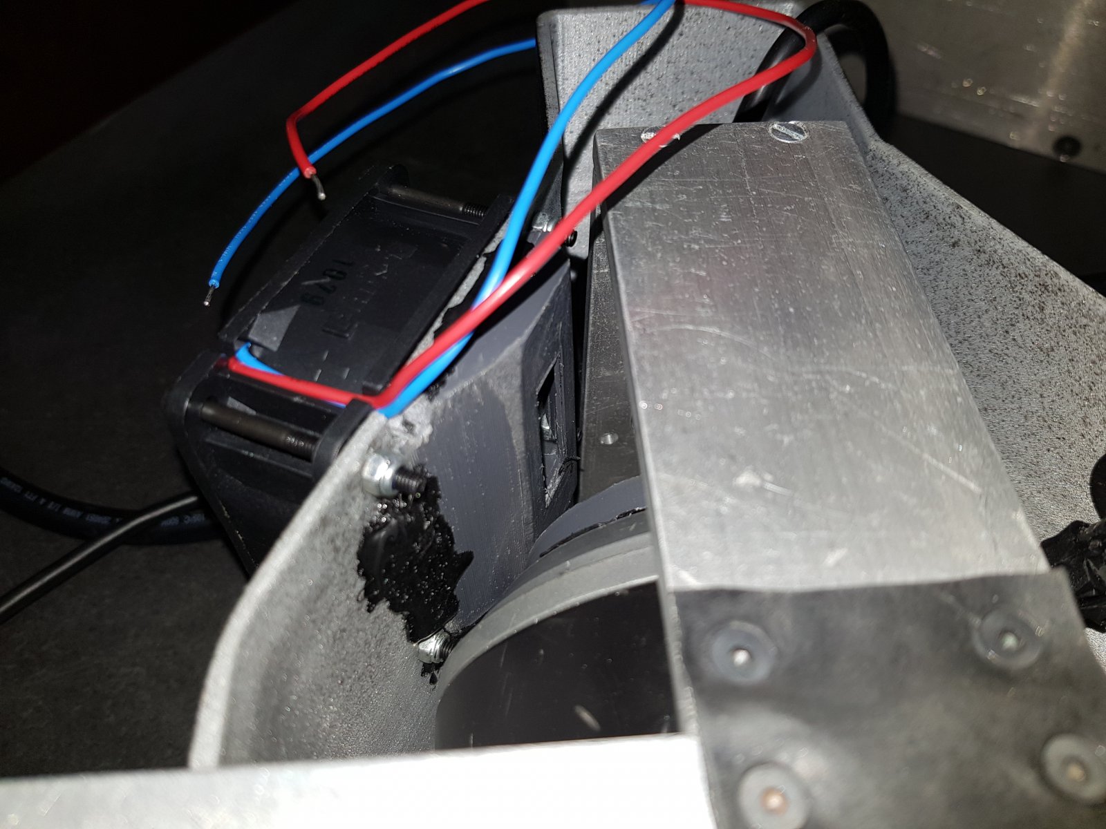

    Motor and encoder encapsulated in a much smaller package.

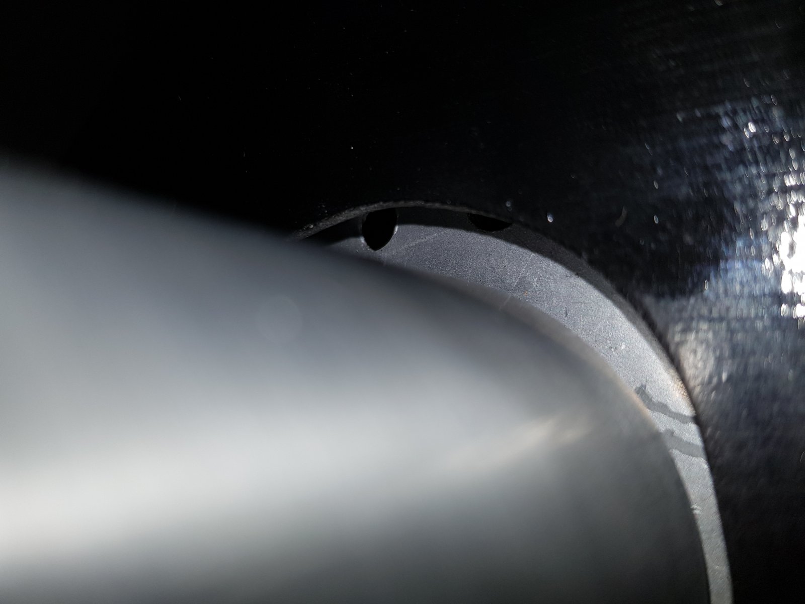

    Cooling of the motor is done via multiple holes in the front and rear plates of the motor. The rear plate has a case + ducting to direct airflow trough the motor far more efficiently.
    Here you can see the rear plate case with a duct outlet. This is set up to have a fan pull air out through the motor. The duct is sized to match the surface area of the drilled holes in the front plate to increase air velocity.
    Here is a pic of one of the holes in the front face plate. 20180424_165846.jpg
    This is the extraction duct + fan
    Plenty of work to be done yet and free time is limited at the moment so progress is slow.

    Why did not I notice fidelity with gear? Have you tried a strap or only with a chain?
    the new engine that nm can get to the block?
    I came to the head to use a motor of 350w direct and two of 150 by pulley and run 6: 1, is it possible or just crazy?

    With a belt/chain some of the finer details are absorbed by the elasticity/play in linkages. A gear driven system can feel a bit rough aswell.
    Yes two motors will work just fine.

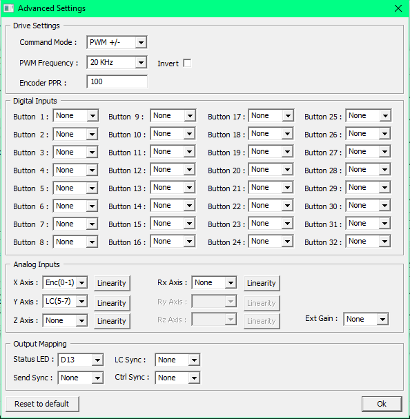

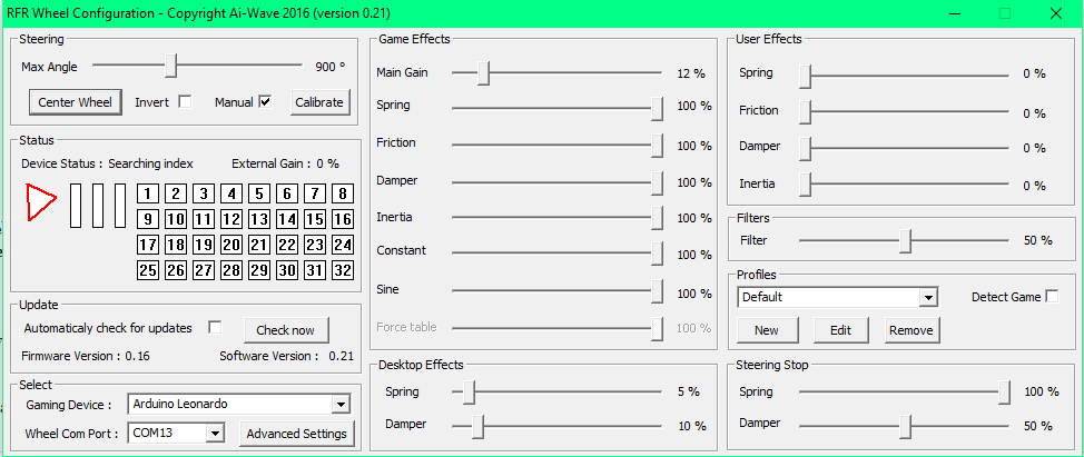

    If somebody interesting, here is the code of Arduino Leonardo, actually you can use and other Arduino, but only Leonardo has feedback option.
    Less words, more pictures.
    43914
    43915
    43916
    43917
    43918
    And one more option for Monster Moto Shield, only what you need is NPN bc547 Transistorand couple resistors 5Kom, i have tried with other NPN transistor and is works well.
    And you need to choose PWM+ DIR mode on wheelconfig advance settings.
    43919
    And Here is files Necessary for set up your wheel.
    Have a fun ;)[/QUOTE]
    Hi, i've done this project but im not able to calibrate the wheel, i'm using a rotary encoder, the dbs36e-s3ek00100. one.PNG
