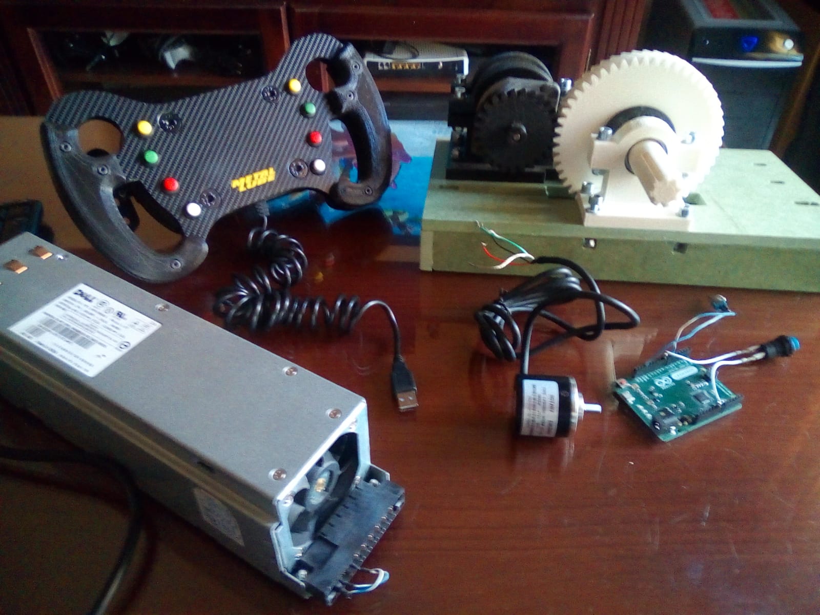

    Well, after being a season following this thread, I decided to start my own project. I have gathered some material from previous projects and started to design a prototype in 3d to do the mechanics.
    My idea is to modify two wiper motors and print helical tooth crowns to move the FFB. For the electronics I will use an Arduino and two IBT-2 that I had for other projects.
    Upload some photos as you have progress.
    Let's see what comes out, greetings.

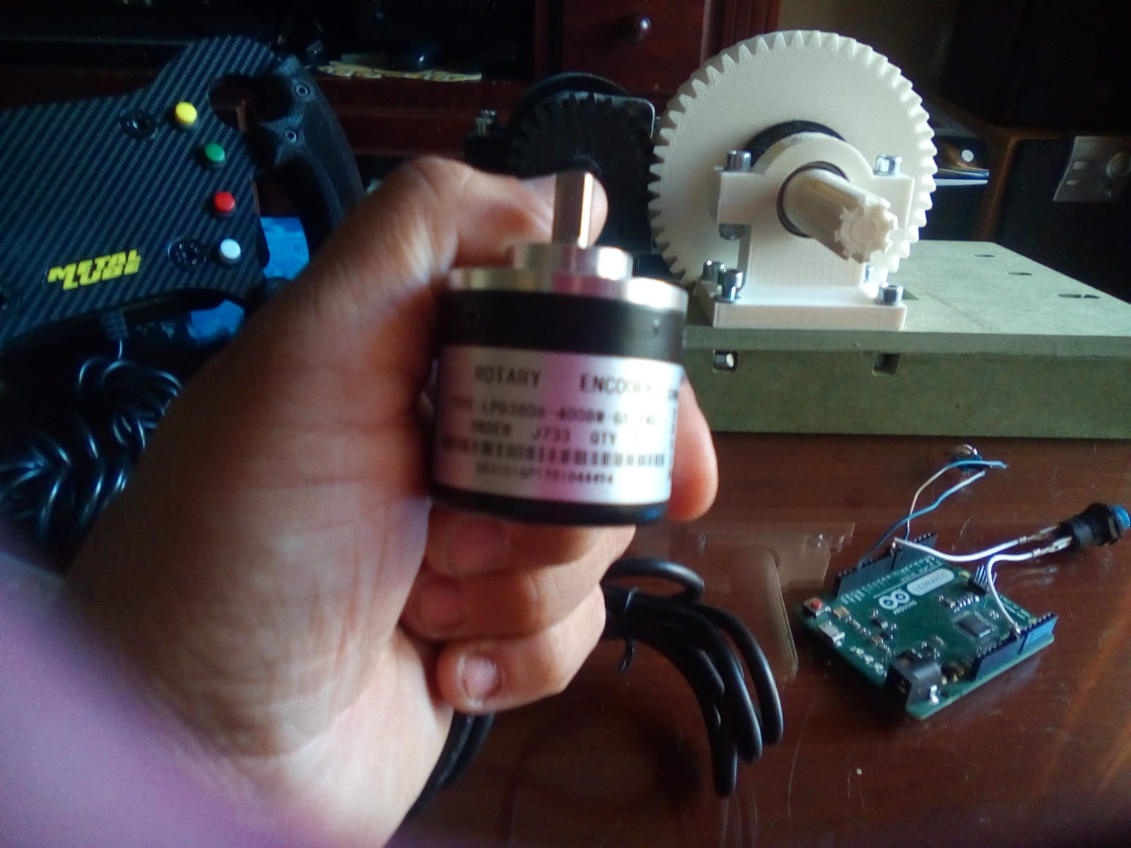

    Hello everyone.
    I have quite advanced my DIY FFB, but I have been stuck and I would need some help please.
    My problem is the following.
    I have already my Arduino leonardo running and the PC recognizes me as a game pad I have even used it in rFactor using the buttons, it works perfectly. I have the problem when I connect the encoder, I can not get the wheel config to recognize the encoder and it works. The encoder, is a Chinese one bought in aliexpress model "LPD3806-400BM-g5-24C".
    I have read in some post that it is necessary to use some resistors in some of these Chinese encoders, but it is not very clear to me which ones to use and where to connect them. I would appreciate any help porfabor.
    Here I leave some photos of what I have thanks and greetings.
  3. Enry58
    Enry58 New Member
    Apr 11, 2018
    Italia
    134Coins
    How much Channels has your encoder? By Seeing the Photo i think 3 cause if you have 3 Channel (normaly a b and z) you have to Connect:
    A to pin 0
    B to pin 1 and
    Z to pin 6.
  4. vicente34
    vicente34 New Member
    Oct 31, 2013
    25
    39Coins
    +15 / 0 / -0
    It does not have Z. It has Red and Black for the 5v supply and then a white one and a green one to connect them to 0 and 1. Pin 6 is connected to the GND through a switch. I've tried several ways to configure it according to some YouTube videos but I have not gotten it to work, that's why I thought it might be because of the resistances but I'm not clear about it because everything else works correctly. The only thing that I have noticed differently is that when I open Wheel config, the "Firmware version" always comes out version 0.16 directly and never the version 0.0 as it appears in the videos, I do not know if that will have something to do with it.
    Thanks for the help.

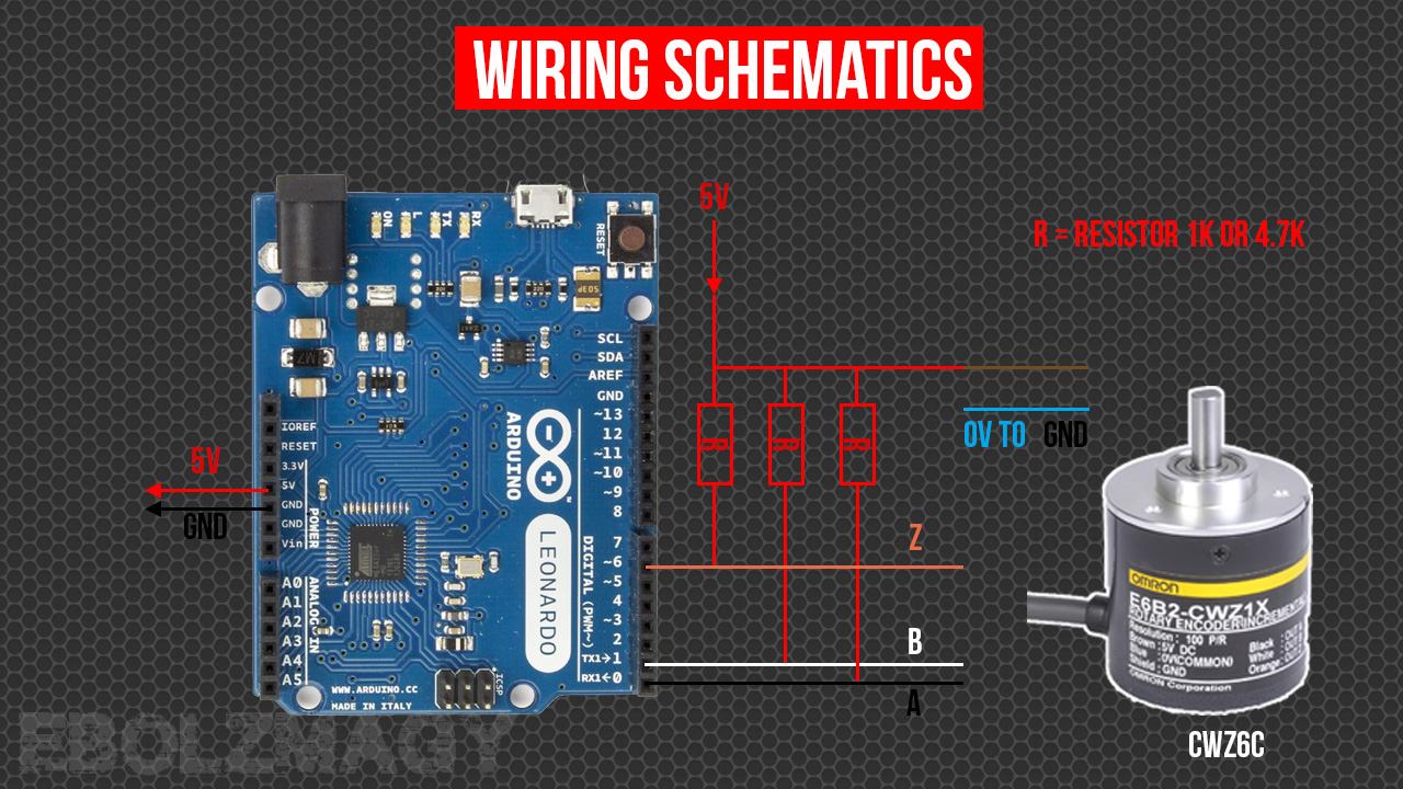

    have you tried using pullup or pulldown resistor on channels?

    With 5v it did not work and I tried 12v just to check .. I read some posts that talk about placing resistances but it is not clear to me as to where or where to place.

    46997
    If using button, ignore channel Z.

    Yes, that photo had seen her.
    This Monday, I will buy the resistance and try to see what it is.
    I guess it will serve me anywhere between 1k and 4.7k.
    Thank you
  16. vicente34
    Oct 31, 2013
    25
    39Coins
    +15 / 0 / -0
    Well, I have put two resistances of 4.7k following the scheme of the photo and it works and it has been a great relief to see the little triangle turn. I tried it with rfactor 1 on the laptop and it works but it gives me some jumps the address, I hope it's just a configuration problem or some nonsense.
    I'm going to try the 1k resistors as well and set it all up to test the FFB.
    I will tell how everything goes when everything is assembled.
    A million thanks for the help and greetings.

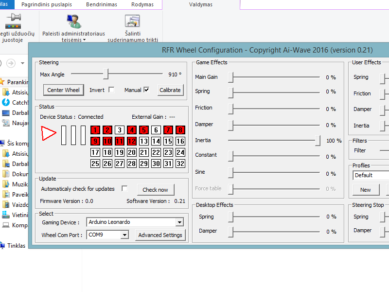

  19. Martynas
    Martynas New Member
    Oct 23, 2018
    78Coins
    Hello, my encoder not working but after i download RFR hex his working, but why i can't open Advanced Settings? ant why reds buttons? Thanks :)
  20. Fernando Igor
    Fernando Igor Member
    Jul 24, 2017
    53
    Programmer
    Fortaleza, Brazil
    913Coins
    +19 / 0 / -0
    DC motor, Arduino
    You need encoder 3 channel (A, B and Z) or use the Z channel with a button (or wire).
    1- Connect pin6 to GND
    2 - Open the program
    3- Remove the pin6 on GND
    4- Turn the encoder and see if the firmware version
    5- Plug pin6 into gnd again and you're done
    if the version doesnt change, you need to pullup (or pulldown) resistor.
    I posted a link with image of the scheme, 3 posts ago.
