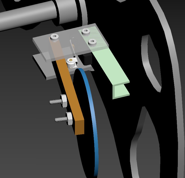

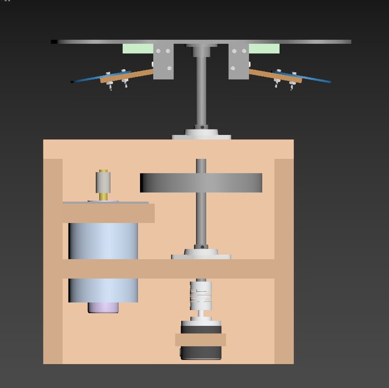

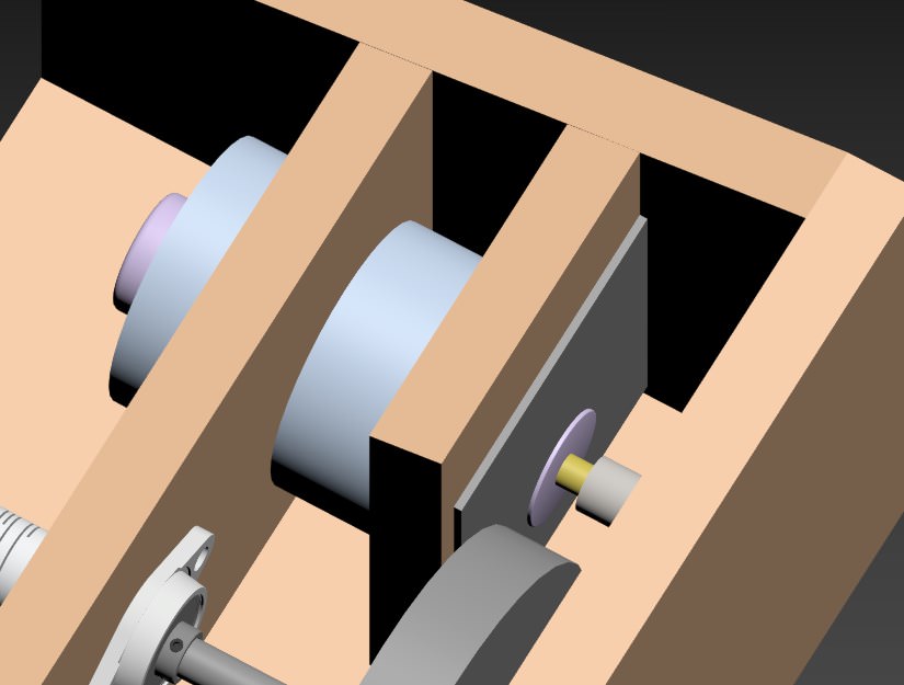

    Currently hoping to have this built by the end of the year and at the moment I'm working on the design in CAD. Didn't want to make a whole thread since I havent made much progress beyond design.
    I plan to have all the electronics in an external box to make it easier to make future mechanical mods.
    I want to use 1 24v 150w MY6812 motor with a 1:7 3m pitch timing pulley ratio. Should give around 4Nm at 350ish RPM. (if the motor performs as expected)
    Here are some more pics and I'd love any suggestions for improvement.
    The paddle shifter, I may add a magnet if I dont like the feel.
    Metal plate in front of motor for extra reinforcement.
