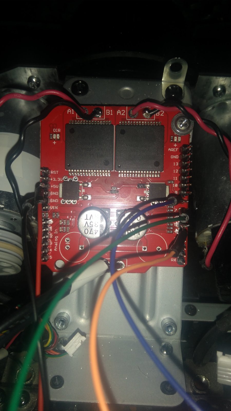

    Hi !
    I am trying to do the same setup with the two dc motors of my G27. The game (pcars2) detects the position of the wheel (although 1° in reality translates in 5° in the game). I checked a couple of time your schematic (and others), but I don't get any feedback. To make things easier, I am trying to powering just one motor for the moment.
    I think the problem could come from the mmos settings, could you say me if they are good ?
    And do we need to connect A0 to VCC to enable the motor or something ?
    Thanks in advance.

    First, test by the wheelcheck program (cycle effect).
    the outputs.
    https://www.dropbox.com/s/3zxf5yd1bvujyi5/WheelCheck_1_72.zip?dl=0
    This h-bridge needs 5vcc and gnd power,
    and the input enable A, enable B, and PWM. (connecting according to the image you reply)
    If it doesnt work, check with a multimeter (or LEDs) to understand the behavior of the outputs (PE09, PE10, PE11) to determine problem, if is configuration or h-bridge.

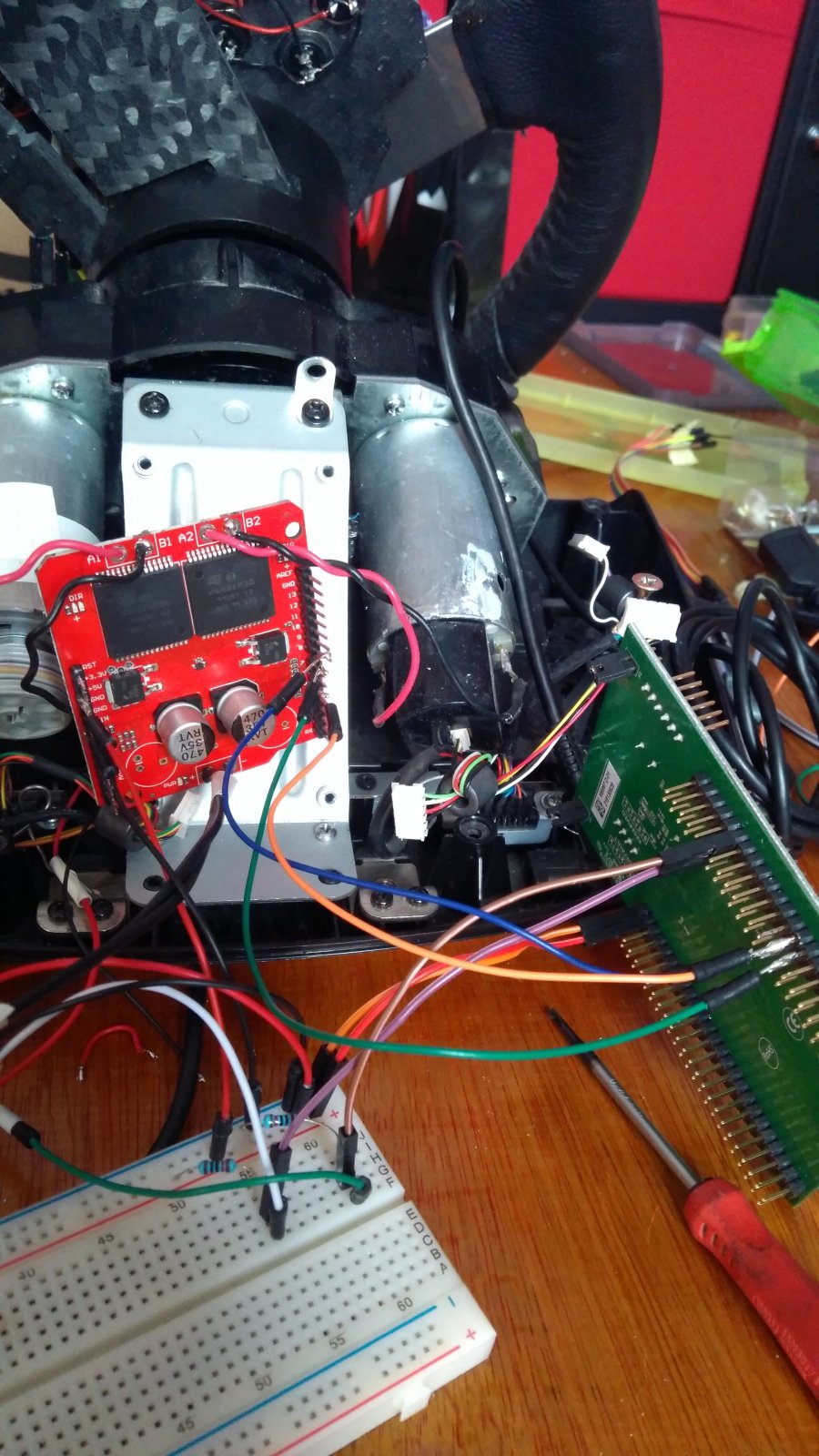

    I tested wheelcheck, it gets everything (wheel position...) but when I test outputs, nothing happens...
    I found that one cable (direction) had one bad soldering. Now when i turn the wheel, I got a little vibration (the wheel is shaken, but don't move at all). The dir led blanks very quickly.

    Ok the problem came from the tension divider bridge...
    I use the logitech G27 PSU that is 24v/1,75A, so I used a divider bridge and it looks like there is a problem with it because if I plug the 24V directly it works...
    Now I need to rebuild everything and try again.
    I guess we can't use the 24 V psu with the moto monster ? Maximum is 16V right ?

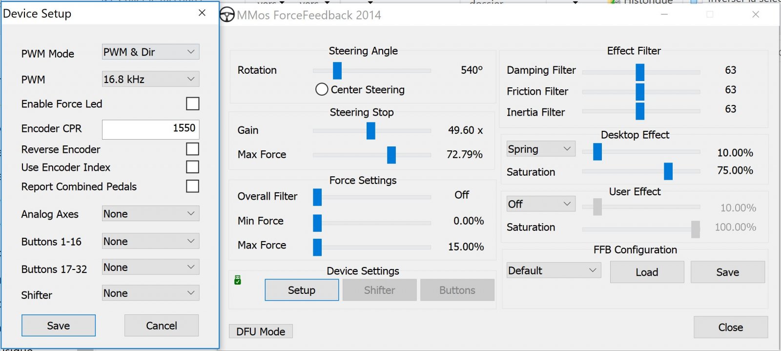

    I've found a way to stop the non accurate friction:grin Force-feeback has improved massively. It means the H-bridge never lands on the ground loop configuration caused by having R_EN and L_EN always at 5v.
    Mmos needs to be set to 'PWM & dir', 16.8khz. Put pin 9 to L_EN and R_EN. Pin 11 to RPWM and pin 10 LPWM (depending on the polarity of your motor, you may need to reverse pin 10/11)
    In this configuration 50%pwm=0motor power; i'm not sure why this is yet - but it is true, at least for me. The work around is to set the in game force feedback minimum gain to 50% - I will find a more permanent work around using hardware but for now it works just fine. In addition to the in game FFB minimum, use the mmos config's minumum gain setting for fine tuning (around 1% up to 5% normally). Tested for over 40 mins and the motor was no hotter than it was in the old configuration, might even be running cooler.

    My build doesn't work :-(
    Pin 11 10 act as dir pins, they alternatively light a LED.
    Pin 9 acts as pwm pin, it makes the led brighter as I put a stronger force.
    But when I plug it to the moto monster, nothing happens. If I put pwm and dir pin to +5v, the motor turns, so power suply line is ok. I don't know where is the problem :/
    Later I will try to plug dir and pwm pins to an arduino, and then the arduino will send the signals to the moto monster, I hope it will works better...

    Could you do perhaps do some pictures of your wiring setup and screenshots of your software setup - It's not possible to figure out your problem without more information.
  14. Lebois
    Dec 10, 2018
    353
    Math teacher
    2,567Coins
    +210 / 3 / -0
    I put pictures of the setup and wirings a few posts upper.

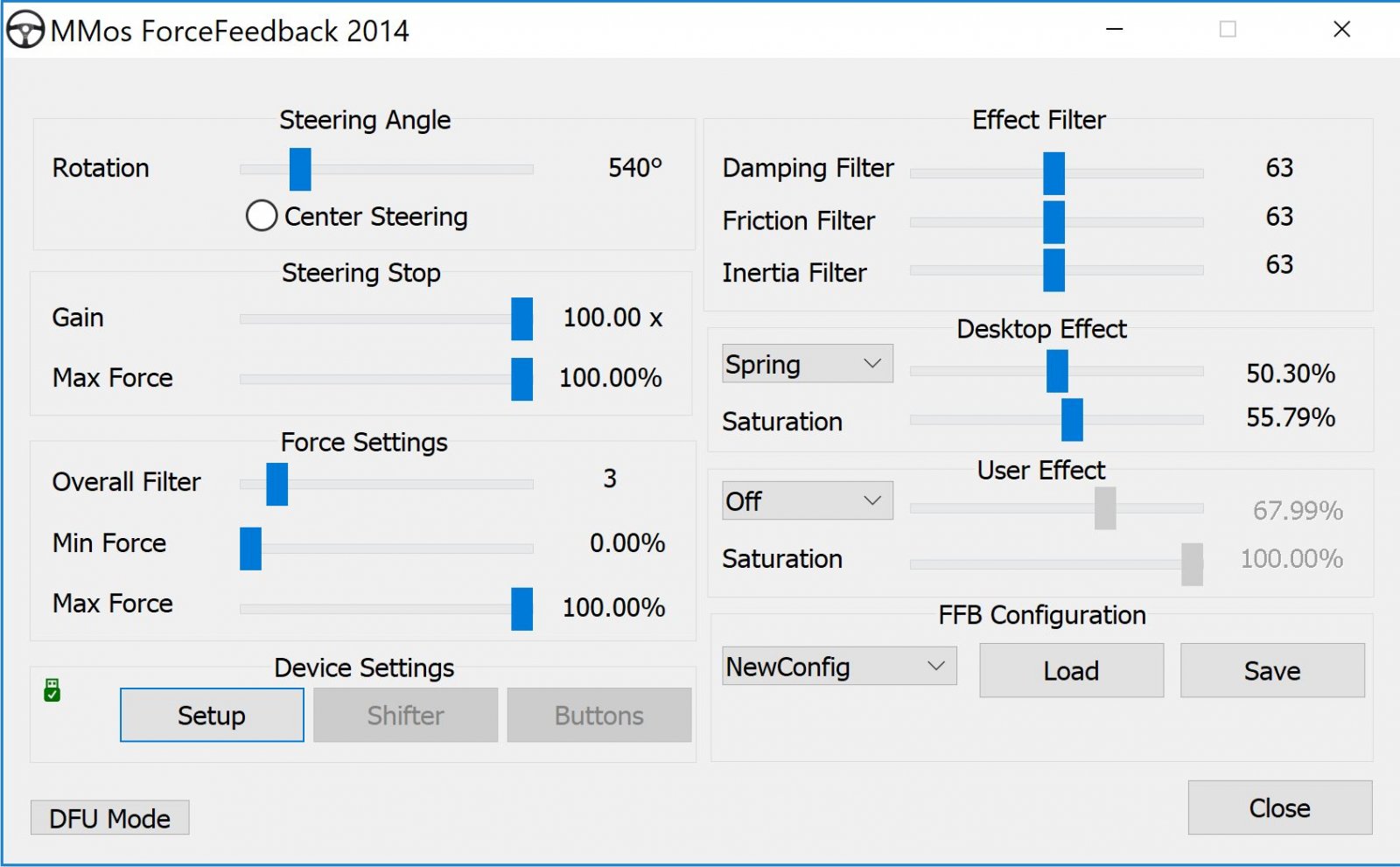

    Ahh sorry I didn't see that. You need to turn up motor max force in Mmos settings to about 100%. And put spring to 50% (when you're in game, turn spring completely off)
  16. Lebois
    Dec 10, 2018
    353
    Math teacher
    2,567Coins
    +210 / 3 / -0
    Like this ? (thanks for taking care !)
