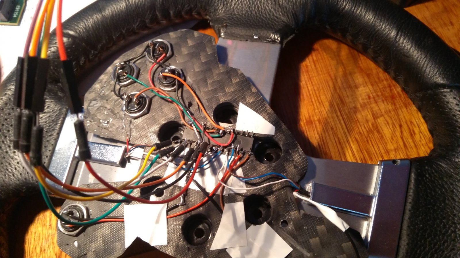

    purple sh/lh
    Wheel Buttons (I think, I had noted, but I'm not sure if it's on this circuit, please check.)
    GREEN PL (sh/lh)
    ORANGE CLK
    BLACK GND Gnd
    ROXO DATA 6
    RED VCC

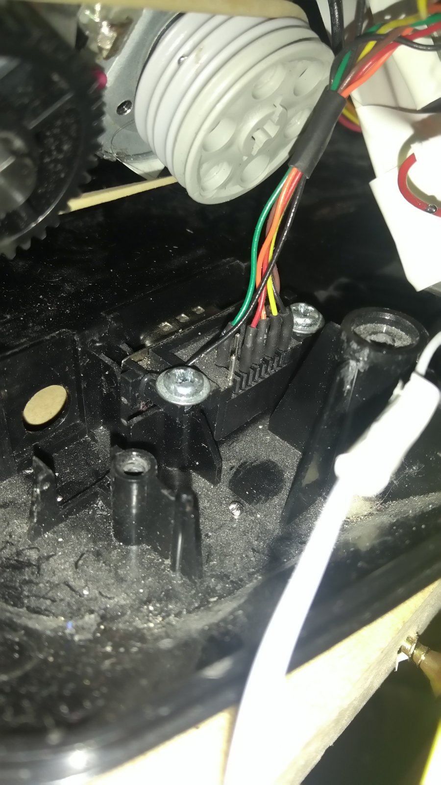

    I started to wire the shifter following that schema :
    SCK Disco PA5 G27 DB9 Pin 1 (Grey wire) (Pin 7 on G25)
    MISO Disco PA6 G27 DB9 Pin 2 (orange wire)
    CS Disco PA4 G27 DB9 Pin 3 (Purple wire)
    PotX Disco PC2 G27 DB9 Pin 4 (blue wire)
    GND Disco GND G27 DB9 Pin 6 (black wire)
    Vcc Disco 5V G27 DB9 Pin 7 (red wire) (Pin 1 on G25)
    PotY Disco PC1 G27 DB9 Pin 8 (yellow wire)
    But it looks like there is some missing wire compared to your informations...
    Also, can someone explain why there is often two vcc wires ? I think that in most case, one would be enough ?

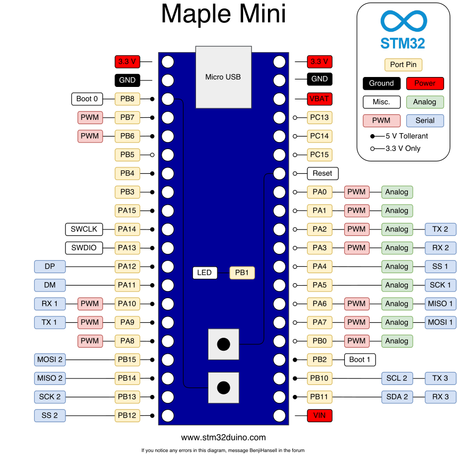

    Hello everyone, i have a question i can use the stm32f103rcbt6 maple mini with the firmware MMos ? this board have a Cortex M3 with 72mhz and 128kb of flash

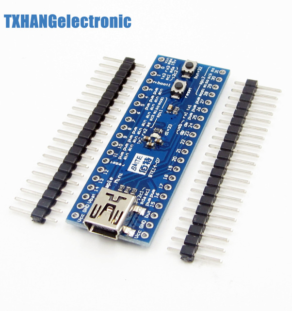

    why you dont buy cheap STM board for MMOS like this:
    these prices only $7

  11. Matheus Henrique
    Matheus Henrique New Member
    Jan 25, 2019
    84Coins
    Thanks for reply
    The project is very good, I'm inspiring it in some aspects (everything practically), but unfortunately the STM32F4 is very expensive in my country (Brazil) and on Ebay it costs about $ 11 and with the exchange rate is very expensive . Arduino Leonardo would be an alternative, but it is limited.

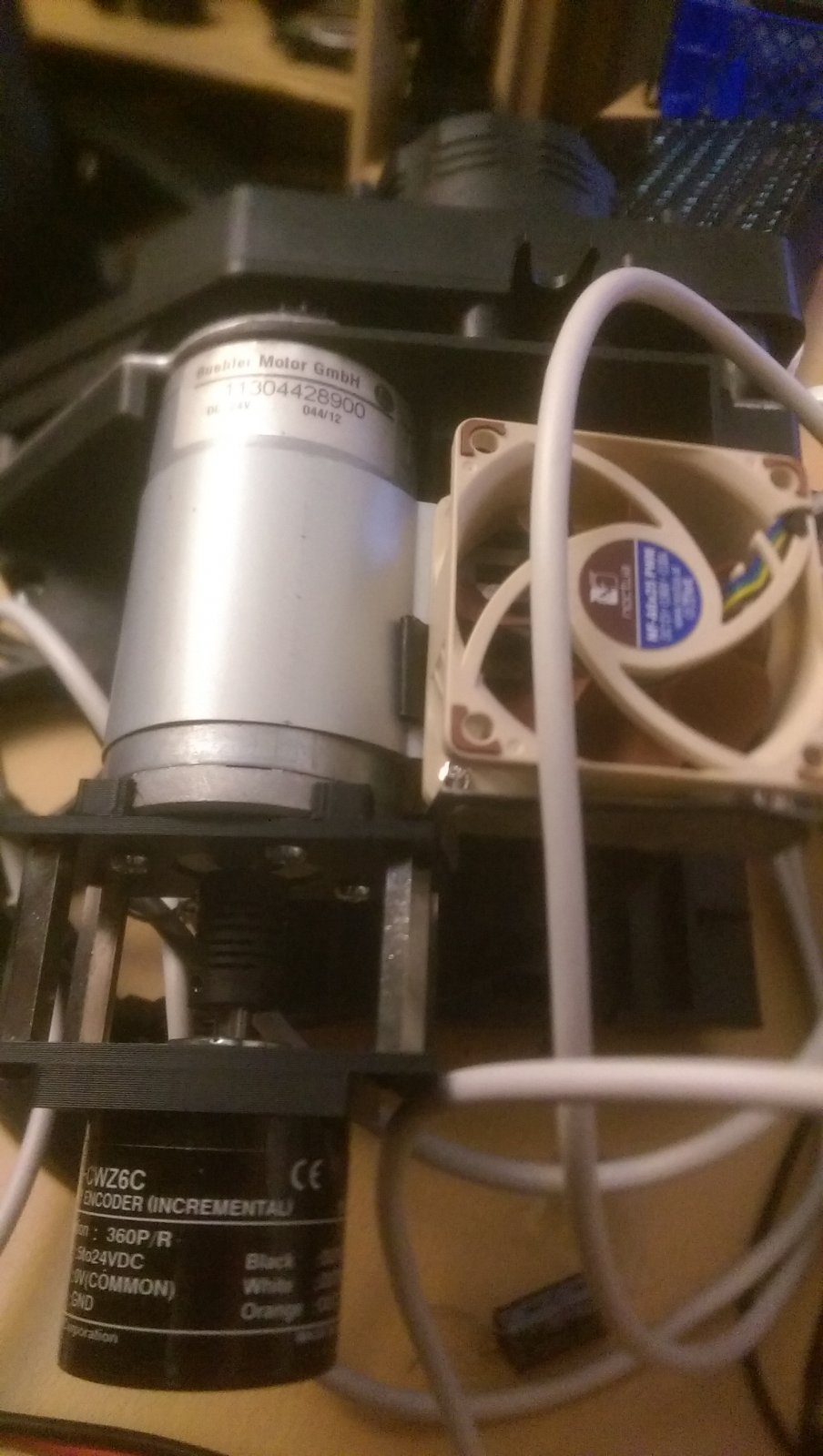

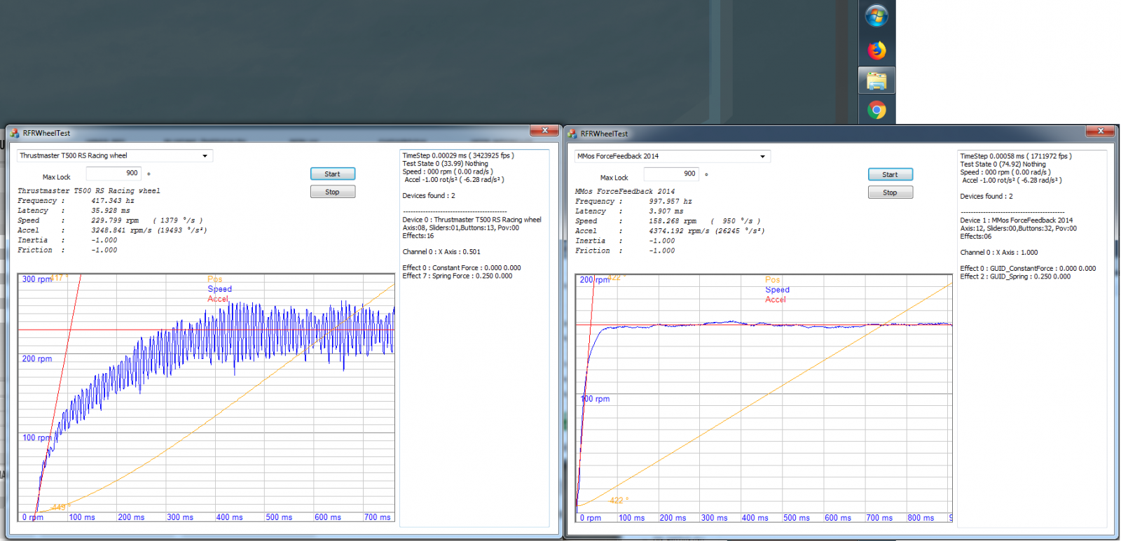

    Here's a comparison between a normal T500 and my retrofitted mmos 14.4v version. Mine still uses the same 24v motor and pulley system as the stock T500. I have also added a big heatsink and fan to the motor and taken out the 1080degree rotation limiter inside the wheel shaft as it's no longer needed and could be a huge problem if the electronics malfunction.
    Due to the lower voltage, mine has a slower max rpm, but 160rpm is still plenty (for comparisom, the TSPC/TGT is about 140rpm). Mine also reaches 160rpm much quicker than stock, and not just because of the extemely low latency: It's quite clear that the T500 firmware doesn't allow the motor to run 24v with unlimited current - there is some kind of current limiter on the T500 pcb/firmware which probably limits the current flow up to the motors rating of 65W. It wouldn't be too much to assume that all the belt drive wheels have current limiters, otherwise their relatively small motors would overheat very quickly when someone who doesn't know what they're doing tries to run the ffb high.
    My version, although running 14.4v, allows the motor to draw unlimited current at stall. I think this means that during peak acceleration and stall, the motor is probably drawing 160w+. Which means that the motor would overheat if sustained at full stall torque for too long. However unless the ffb from in game is set completely wrong, the average current to the motor is likely to be around 50w - this is of course dependent on the car and track.
    What this means is that the stall forces on my wheel are over twice that of the normal T500. The motor is effectively running in an unlimited mode, meaning it can more accurately represent the forces in the game by treating high and low current draw equally. It is a substantial improvement.
    In addition, the new encoder has a much higher resolution... 23040 cpr.. so with a 300mm rim, that is approximately one count per 0.04mm at the circumference. I think this is 5-10 times the stock resolution.
    I'm selling my TSPC now because it's not even close to the power of the modded T500. The only upside to the TSPC is that it has less mechanical friction, but I find setting a negative friction coefficient in Rfactor2 FFB settings can pretty much overcome this for the custom T500. The TSPC's motor is very notchy, whereas the T500 motor doesn't seem to have any notching (though as a brushed motor, there is a little bit more friction)
